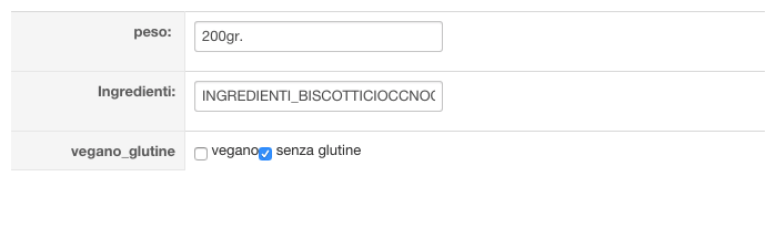

I see that adding your code the problem of fatal error is solved but it make another kind of problem in my site.
I have some custom fields in product table which appear in product pages.
There are some text fields and one checkbox field.
If I update the value of a text field in product page it's everything ok, but if I update checkbox field (by check/uncheck) it doesn't save the update. (Joomla says successfully saved but is not true!)

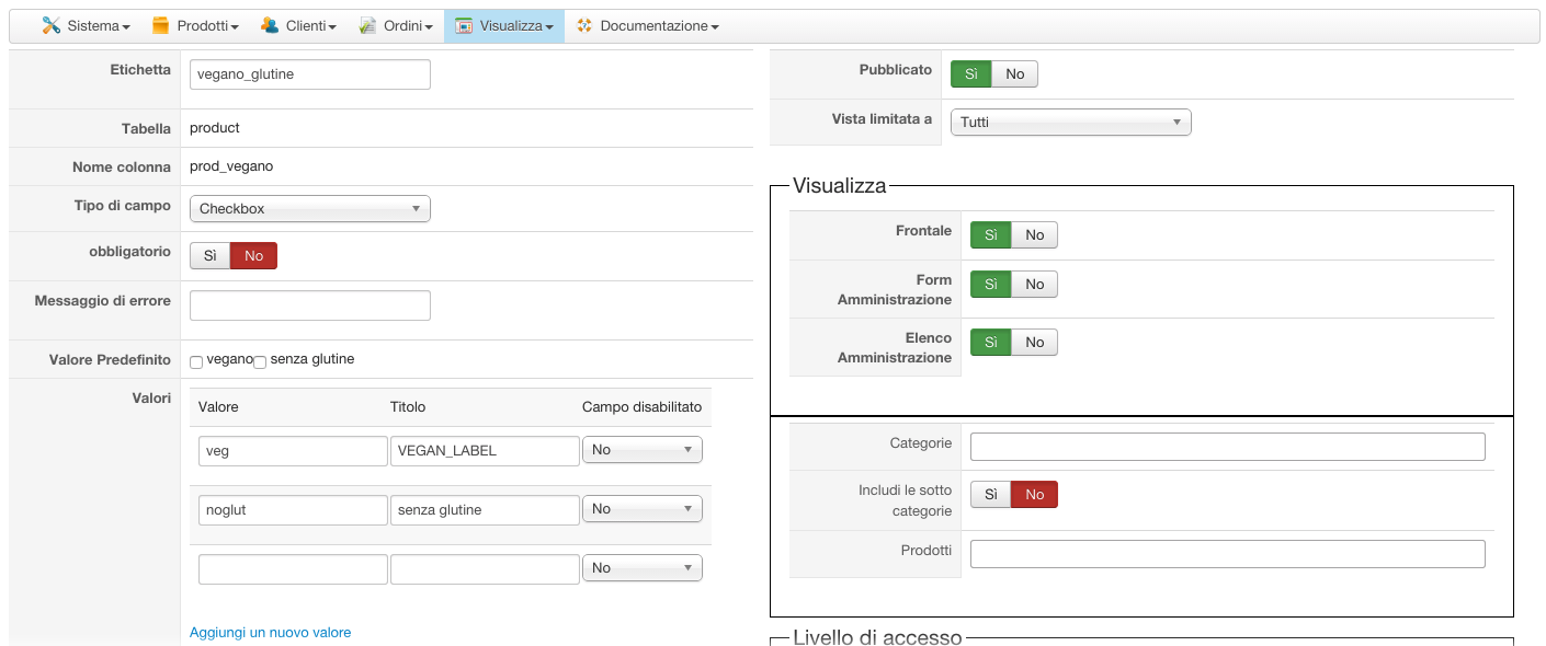

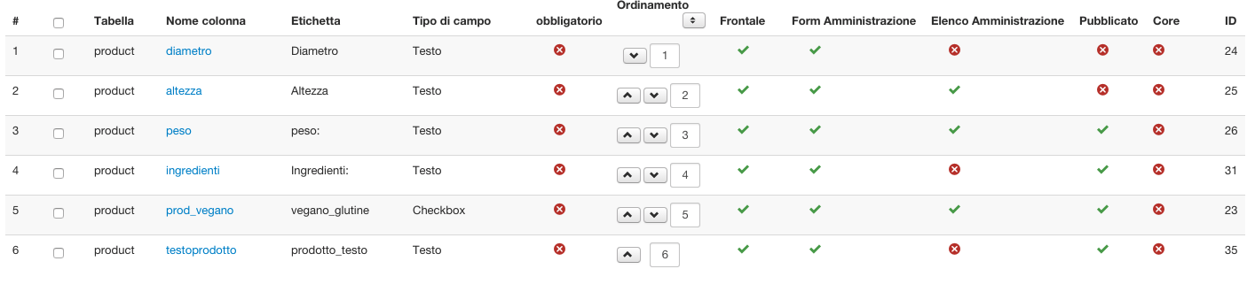

11 years 3 months ago #203414
In attachement you can find list of product custom fields, the checkbox field settings and the product page setting where I was unable to update checkbox value.
As I said I was unable to update checkbox value going in product page setting and checking or unchecking the box. (with your old code)
Before edited there were no problem and now with new code is everything ok.
So step can be:
1- Create (checkbox) custom field for table product
2- Update product page by checking it and save
3- Put first version of your code in field.php
4- Try to update checkbox value in product page and save (it doesn't save)
