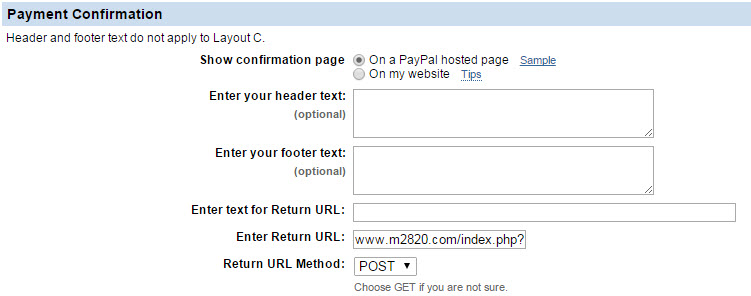

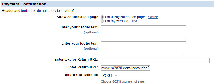

11 years 2 months ago #201722
Solution:
I would like you to answer the questions above, but I did find a solution on PayPal website until you guys fix the shopping cart. Here it is in case others need a fix:
1. Sign in to your account on manager.paypal.com
2. Go to "Service Settings" tab at the top, then click on the "Set Up" tab underneath that tab.
3. Scroll down to the "Payment Confirmation" section (see attached image) and set "Show confirmation page" to "On a PayPal hosted page." This will bypass your shopping cart and PayPal will take care of letting the customer know that the transaction has completed successfully.

  • Posts: 86042
  • Thank you received: 14174
11 years 2 months ago #201726
1. The plugin is already there and activated by default if you have the latest version of HikaShop. But there is a bug in it which will be fixed in the next version so for the time being you should deactivate it to fix that issue.
2. We didn't say that you should disable the PayPal advanced plugin. We said that you should disable the HikaShop payment notification plugin.
3. In a few weeks, but it doesn't matter as you don't need to wait for that to disable the plugin.
4. Yes that's correct. It doesn't work because of that new payment notification plugin which has a bug.
