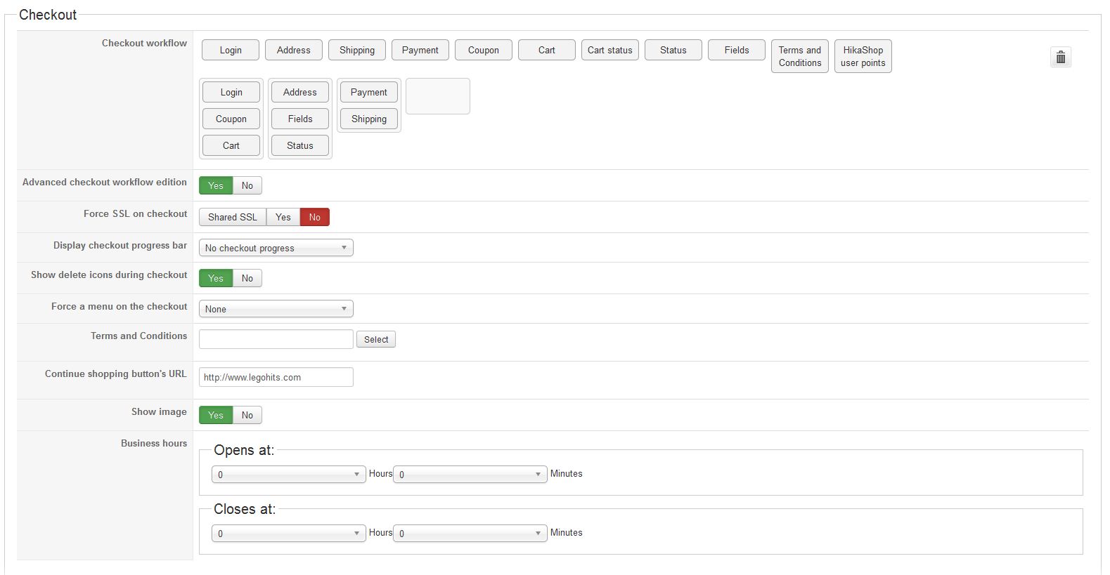

Could you provide a screenshot of the settings of the Checkout tab of your HikaShop configuration and a link to the shop so that we can look at your checkout ?
  • Posts: 108
11 years 2 months ago #202820
sure, here it is

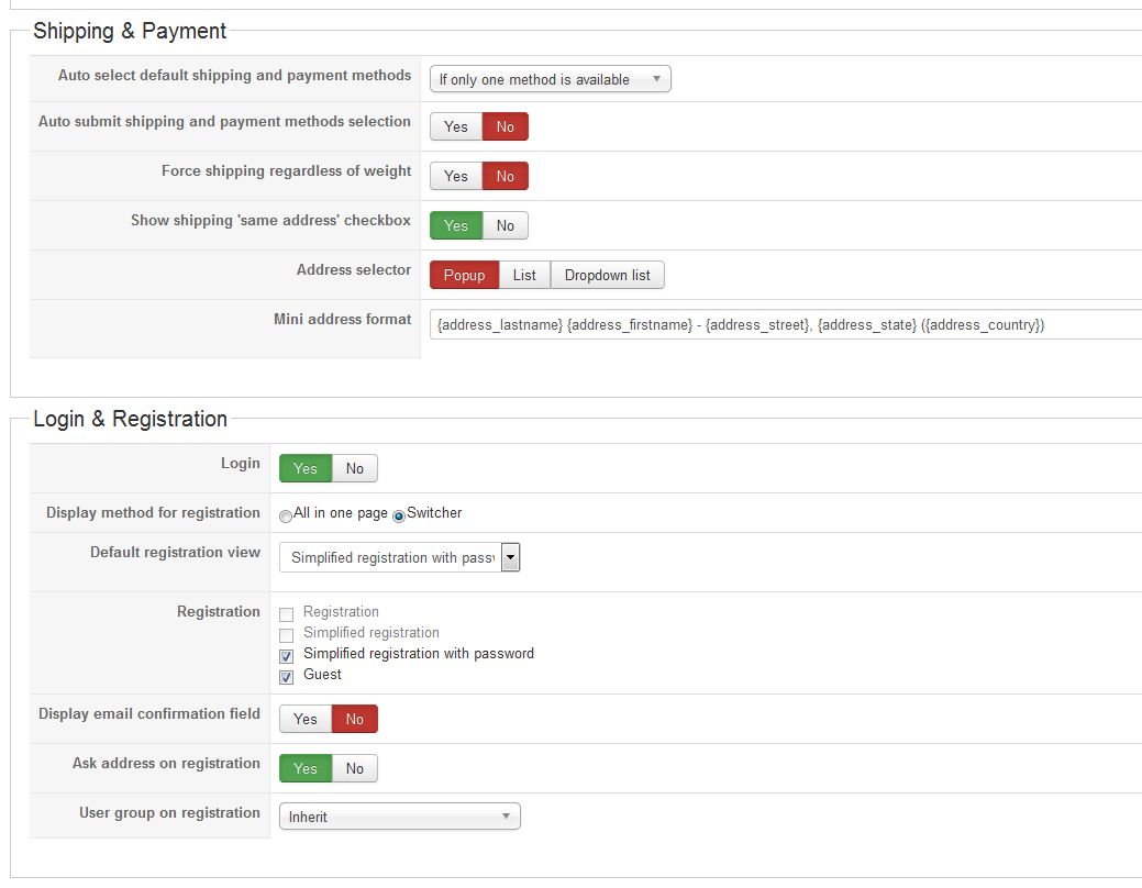

Please make sure that the auto submit and auto select options of the checkout tab are activated. You should then not have that issue anymore.

I am having the same issue after turning off the "Auto select default shipping and payment methods".
The reason I turned it off is the following:
If it is set to yes, then the credit card is preseleted and the credit card fields are showing. If the customer "clicks" to select the credit card payment accidently thinking they need to then the fields close and they cannot get them open again without clicking Pay By Check, then clicking Pay By Credit Card Again.
If it is set to If Only One Method is available, then nothing is preseleted, but the Credit Card fields are open. If the customer "clicks" to select the credit card payment then the fields close and they cannot get them open again without clicking Pay By Check, then clicking Pay By Credit Card Again.
What seems to be the problem is that the Javascript or JQuery running the Authorize credit card fields (open / closed) state is not registering on the page. So I have it set to no, but now customers are writing to say that they are not getting an order confirmation and they are afraid to click "finish" or send my order (language override) twice.

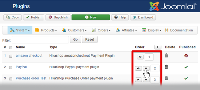

I have maybe an idea, the auto select payment method option will always pick the first payment method, and so I guess that the one with the credit card form is the first in your payment method order.
Maybe you can modify order for have at the first place, a payment method without this kind of form maybe you will have what you want AND keep the auto select payment method switch on.
Hope this will fit your needs.

I moved it to be second in line and preselected. I still have to click finish (send my order) twice for it to be submitted.
Please help.
