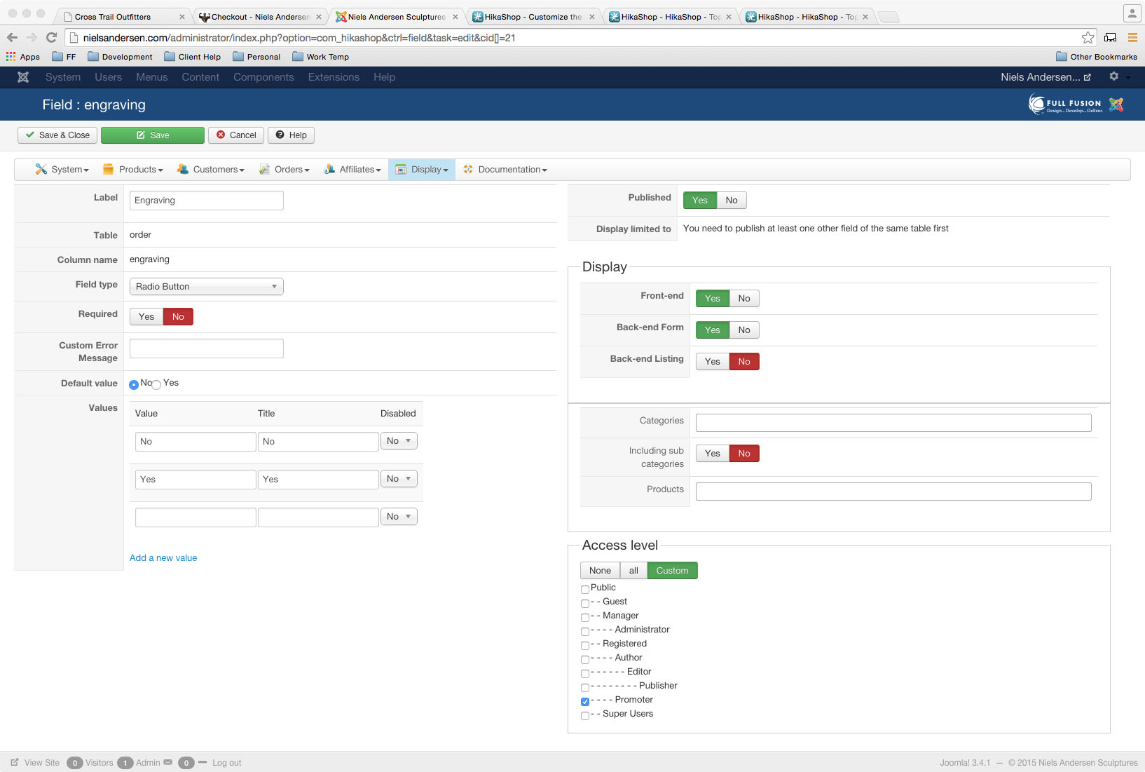

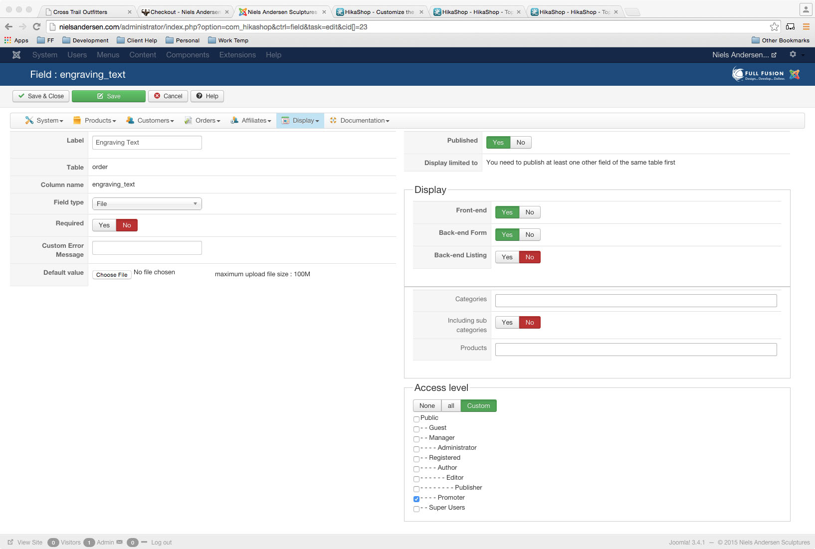

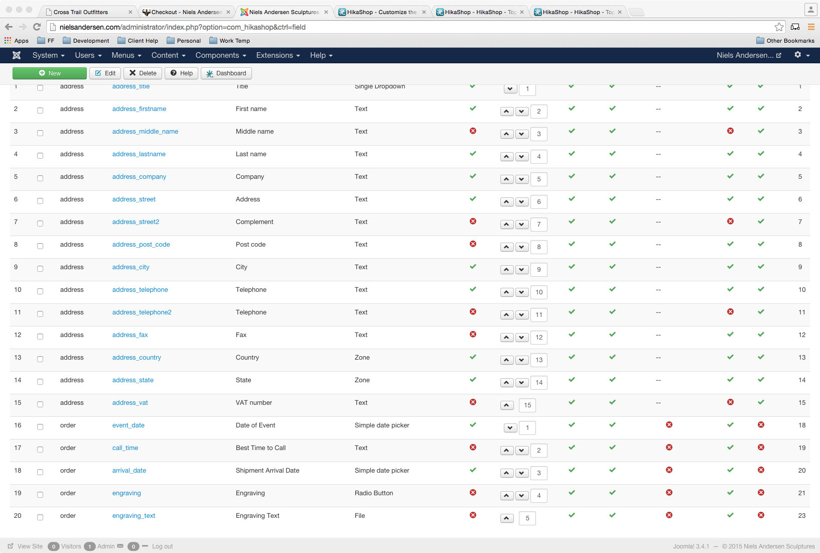

I have custom field created in the table of "order". I am trying to make a file upload field conditioned on the "yes" answer of a radio button field. Even though they are both published in the same table (which is "order") I still get the "You need to publish at least one other field of the same table first" message at the "Display limited to" field. It works for fields in the "address" table. Please advise.

Can you provide a screenshot of the settings of both of your fields ?

10 years 11 months ago #204998
Your issue is coming from the fact that you have set some custom access level on your custom fields, you should test it without it.
