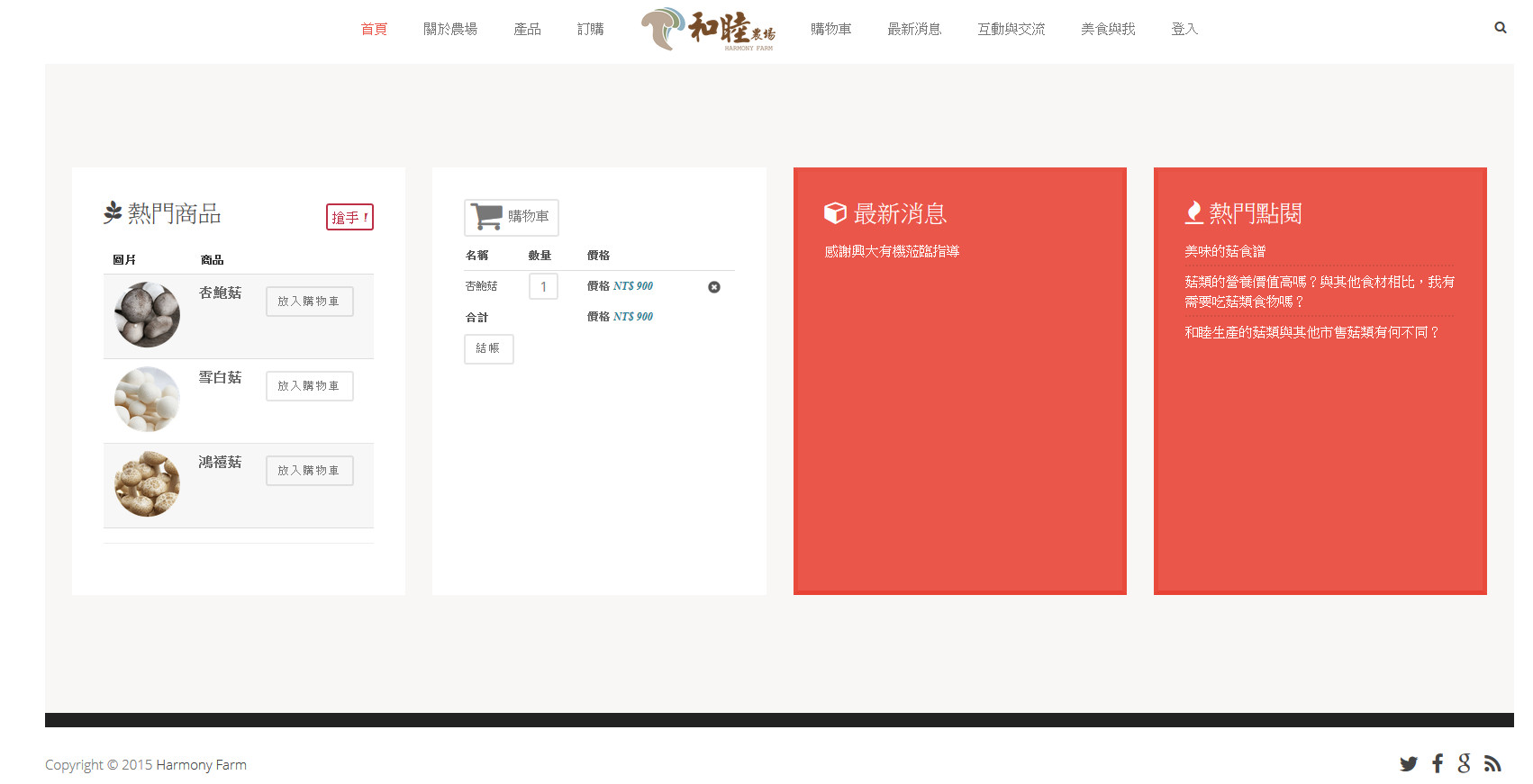

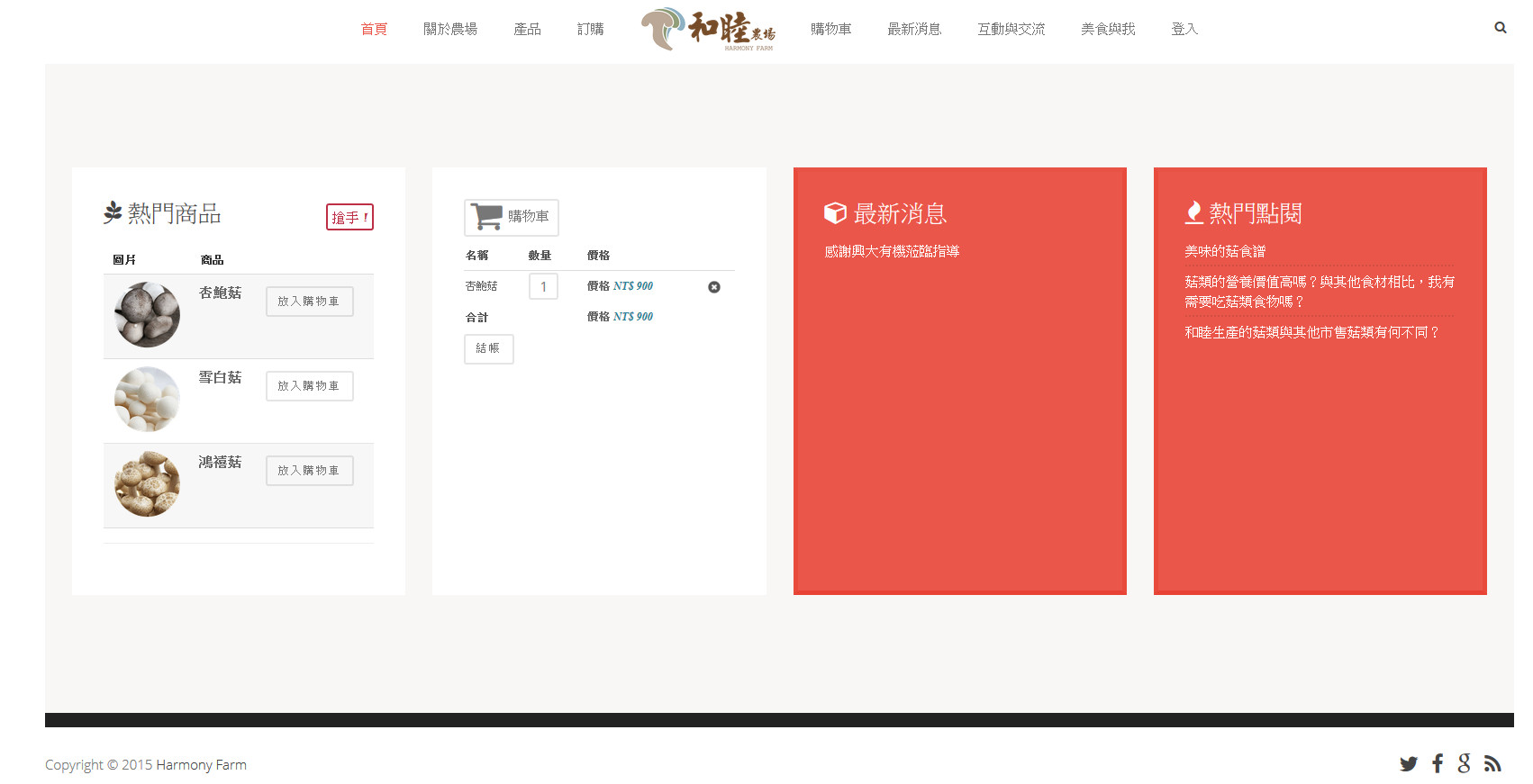

I have a popular products module and a cart module on the frontpage. The cart module was set to be "mini" mode. There are two problems. First, when i click the "add to cart" button on popular product module, the cart module turned to be a complete display, not a mini mode. Secondly, any time i performed any actions on the cart module ( such as update or change the product amounts or delete the products in the cart....), the page reload to the top of the frontpage and i have to scroll back to the cart module position. You can try it .... Any way to resolve this two problems ?

1. I have changed to normal mode, but after deleting or changing products, it still not remain in the same position (although it did not jump to the top, it now jumped to middle of the cart module and we can only see half of the cart now and still need to scroll down .....)
2. Although in normal mode, the change of cart module did not jump to the top, but when i clicked "add to cart" button in the popular products module beside the cart module, it still jump to the top. This method seemed not to resolve the reload problem resulting from the action from another module, any method to resolve that ?
