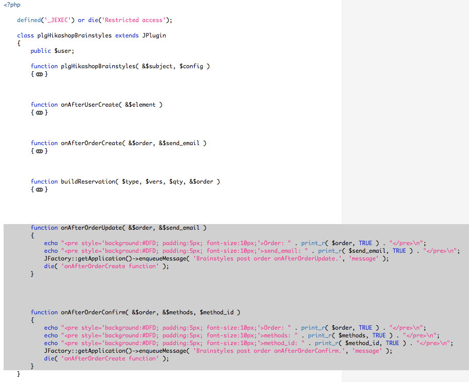

We're working on a checkout process using the basic PayPal payment plugin in combination with a Hikashop plugin of our own creation which creates a reservation db record when an order containing certain items is created - and activating that reservation when the payment is confirmed by PayPal.
The custom plugin uses "onAfterUserCreate()" to assign the new user to a specific group. It also uses "onAfterOrderCreate()" to build the reservation db entry. These work fine and correctly.
The problem is that the plugin never receives either the "onAfterOrderUpdate()" or the "onAfterOrderConfirm()" triggers, which we need in order to finish the process.
The PayPal plugin IS working properly (although "debug" mode does not automatically write output to the Payment Log file - I manually inserted hika's log-writing triggers inside it to follow its progress from beginning to end to check it, and that does work. ) It process the Notification from PayPal and it properly changes the Hikashop order's status, as well as emailing the change notification to us.
But our own plugin never receives that final trigger which will activate the reservation. (The methods currently contain various commands which would make it very visible if they were processed. Users are transmitted normally to Hika's "Thank You" output without them being triggering.)
How can we tell if these triggers are being sent? Could they be like "onPaymentNotification()", which is sent only to the payment plugin in use? Could I locate where the triggers are being activated/sent? Do you have suggestions for some other way I can troubleshoot this?

I appreciate the explanation, which is precisely what I expected and hoped for, but my issue (if you examine the code included in the first post) is that I have a method set up for onAfterOrderUpdate that it is NOT being activated. I don't understand why.
Here is the first method, expanded ( the old-style _construct method ).
function plgHikashopBrainstyles( &$subject, $config )
			parent::__construct( $subject, $config );
			$this->user = JFactory::getUser();
			$this->user->demographics = JUserHelper::getProfile( $this->user->id );
			if( !isset( $this->params ) )
				$plugin = JPluginHelper::getPlugin( 'hikashop', 'brainstyles' );
				$this->params = new JRegistry( $plugin->params );
Is there something incorrect here or something else I need to do to receive that post-payment trigger? Remember, I DO receive the onAfterOrderCreate trigger call correctly. I just don't receive the calls which occur after the Payment.
