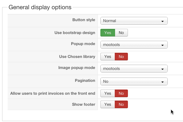

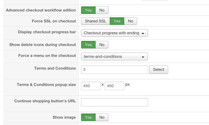

10 years 11 months ago #205794
The T&Cs article IS SHOWING in that pop-up box, but it is inside a full web page.
Attached is a screenshot of the settings in the Configuration.

10 years 11 months ago #205800
The problem comes from your template not supporting normal bootstrap popups.
Go in the Display tab of the HikaShop configuration and change the "popup mode" setting to "mootools" and that should solve the issue.

10 years 11 months ago #205933
We are already using the mootools selection.

10 years 11 months ago #205945
I don't see how that's possible unless the Joomla router is messing up the URL, or you modified the file "terms" of the view "checkout" via the menu Display>Views.
Did you modify the view ? If so, if you revert your changes, does that help ?
Otherwise, I suppose that if you temporarily turn off the SEF on your website it works just fine ? Do you use a third party SEF system ?

10 years 11 months ago #206086
I created a new Terms and Conditions article and attached that one instead.
It is working now.
Odd.
