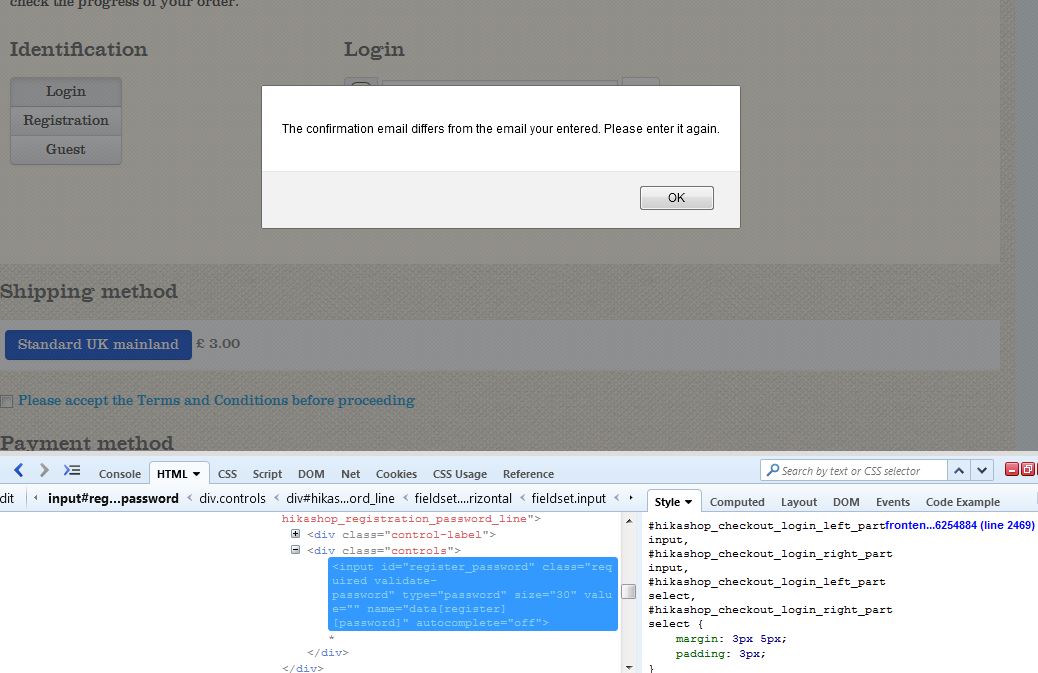

-- Joomla version -- : 3.4.1
-- Error-message(debug-mod must be tuned on) -- : The confirmation email differs from the email your entered. Please enter it again

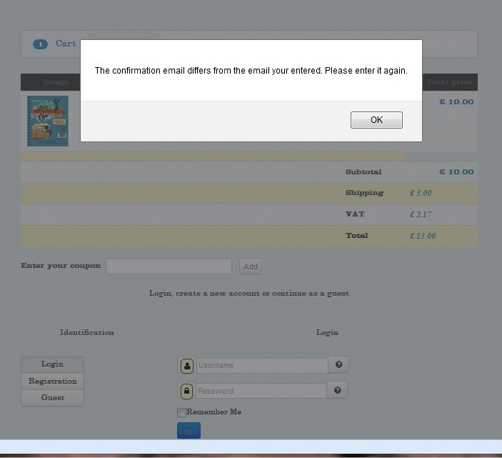

Whenever I access the Hikashop registration page my browser tries to fill in the password field and I immediately get the error message "The confirmation email differs from the email your entered. Please enter it again". I can see why this is happening as there is nothing entered in the confirmation email box, but this message shouldn't appear as soon as the registration page is displayed.
This is a particular problem on checkout; if I use the identification switcher option with Login, Register or Guest the registration form throws the error as soon as checkout is displayed, even if the registration form is hidden. This will be an issue as customers who are already registered with the site and use their browser to fill in passwords will always see this error message when they get to checkout unless they have previously logged in.
How can this be avoided?
