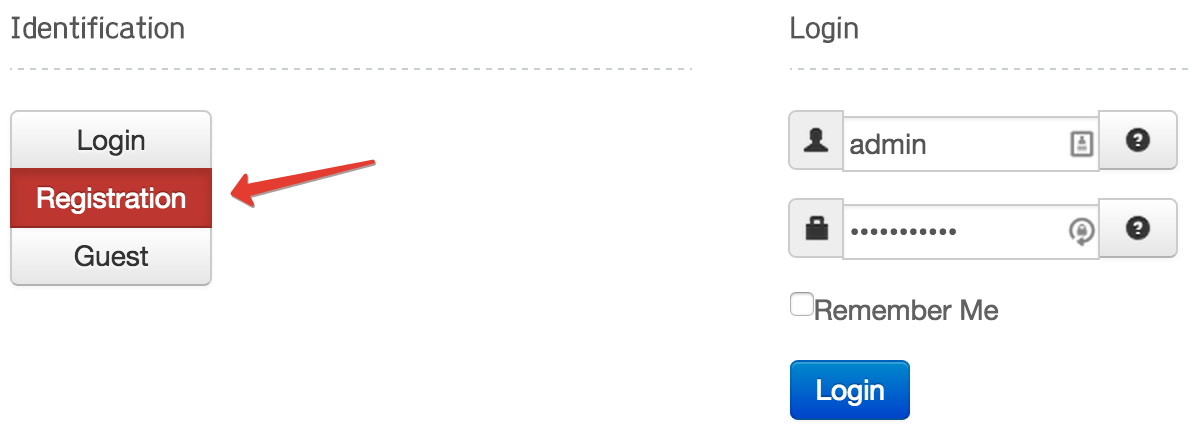

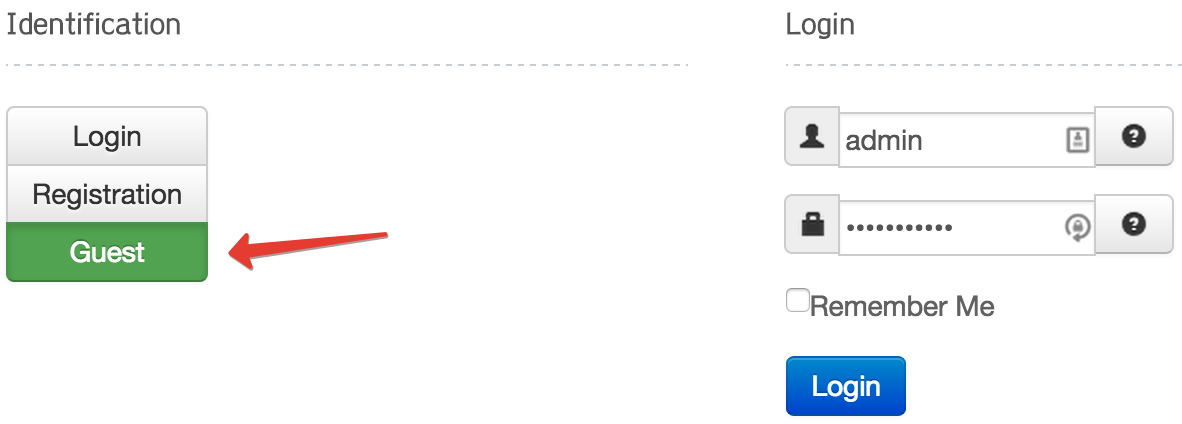

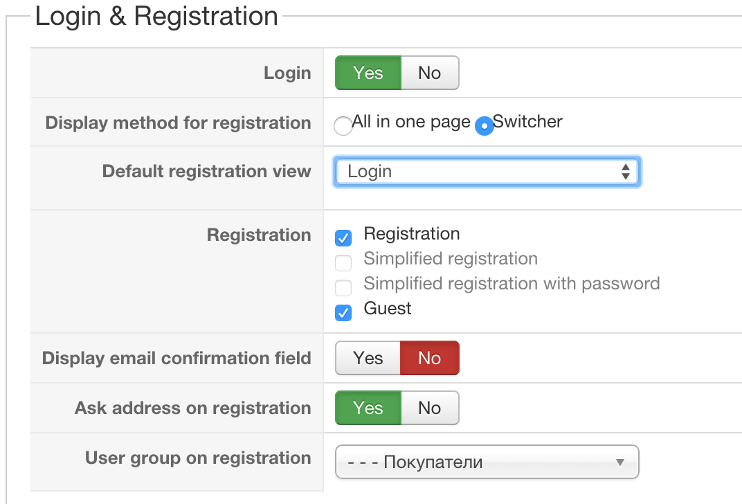

Hello HikaTeam,
I have setup under Login & Registration:

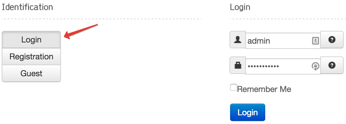

But on the frontpage when you switch Identification is always the Login form:
How to fix it?
