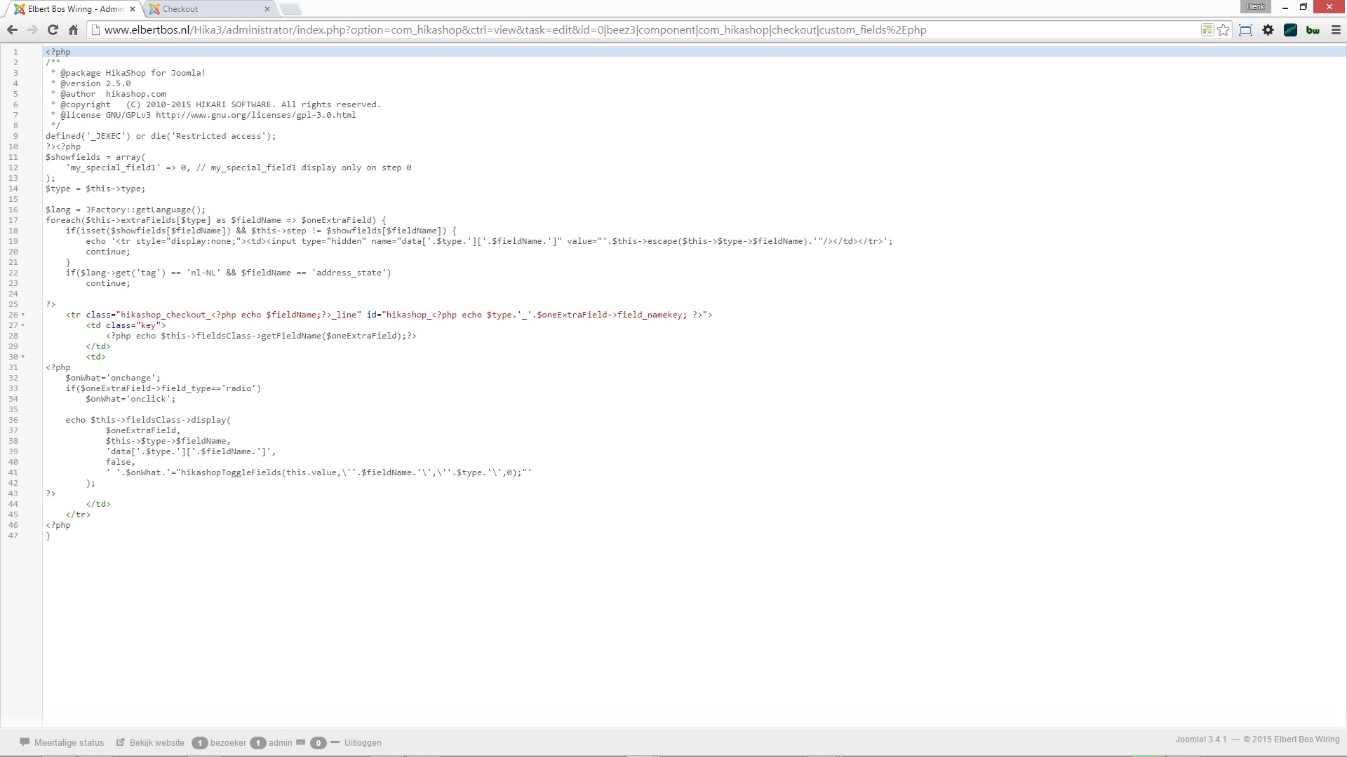

10 years 11 months ago #206643
1.
To remove your order custom field (not required) from your Dutch version, the solution will be to directly edit the "custom_fields" file of the "Checkout" view of your front-end template via "Hikashop->Display->Views", and change these lines :
foreach($this->extraFields[$type] as $fieldName => $oneExtraField) {
	if(isset($showfields[$fieldName]) && $this->step != $showfields[$fieldName]) {
		echo '<tr style="display:none;"><td><input type="hidden" name="data['.$type.']['.$fieldName.']" value="'.$this->escape($this->$type->$fieldName).'"/></td></tr>';
		continue;
By :
$lang = JFactory::getLanguage();
		continue;
	if($lang->get('tag') == 'nl-NL' && $fieldName == 'Your_Customfield_Column')
		continue;

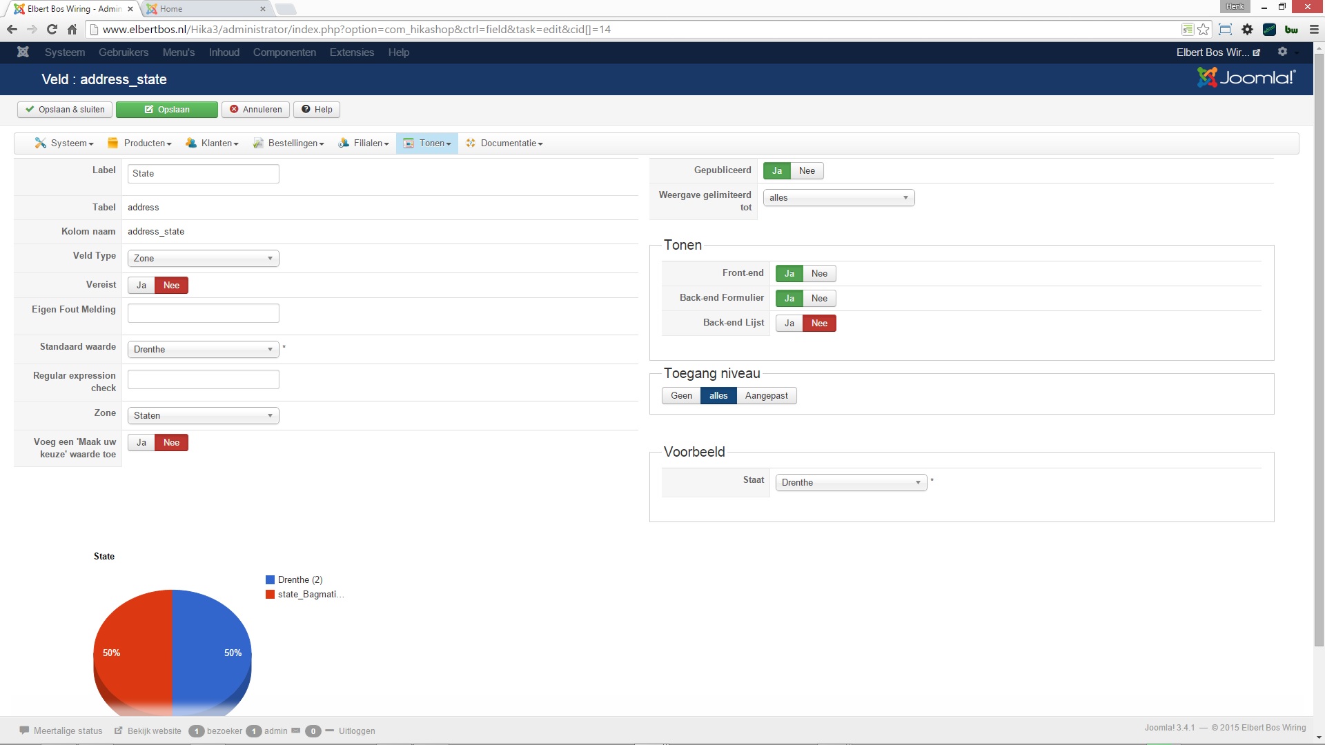

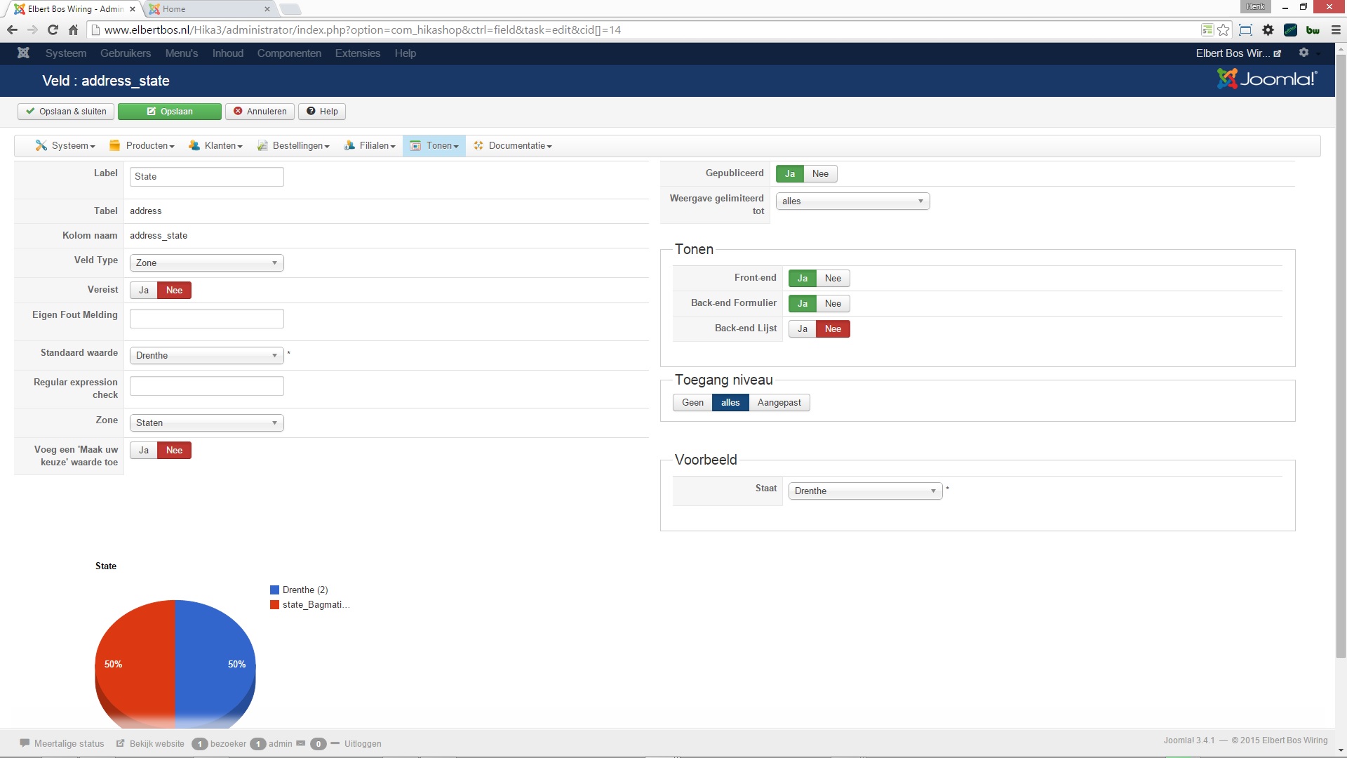

10 years 11 months ago #206892
Can you show me how did you edited the code that I gave you and how you configured your "Staat" custom field through some screenshots ?
Thanks.
  • Posts: 43

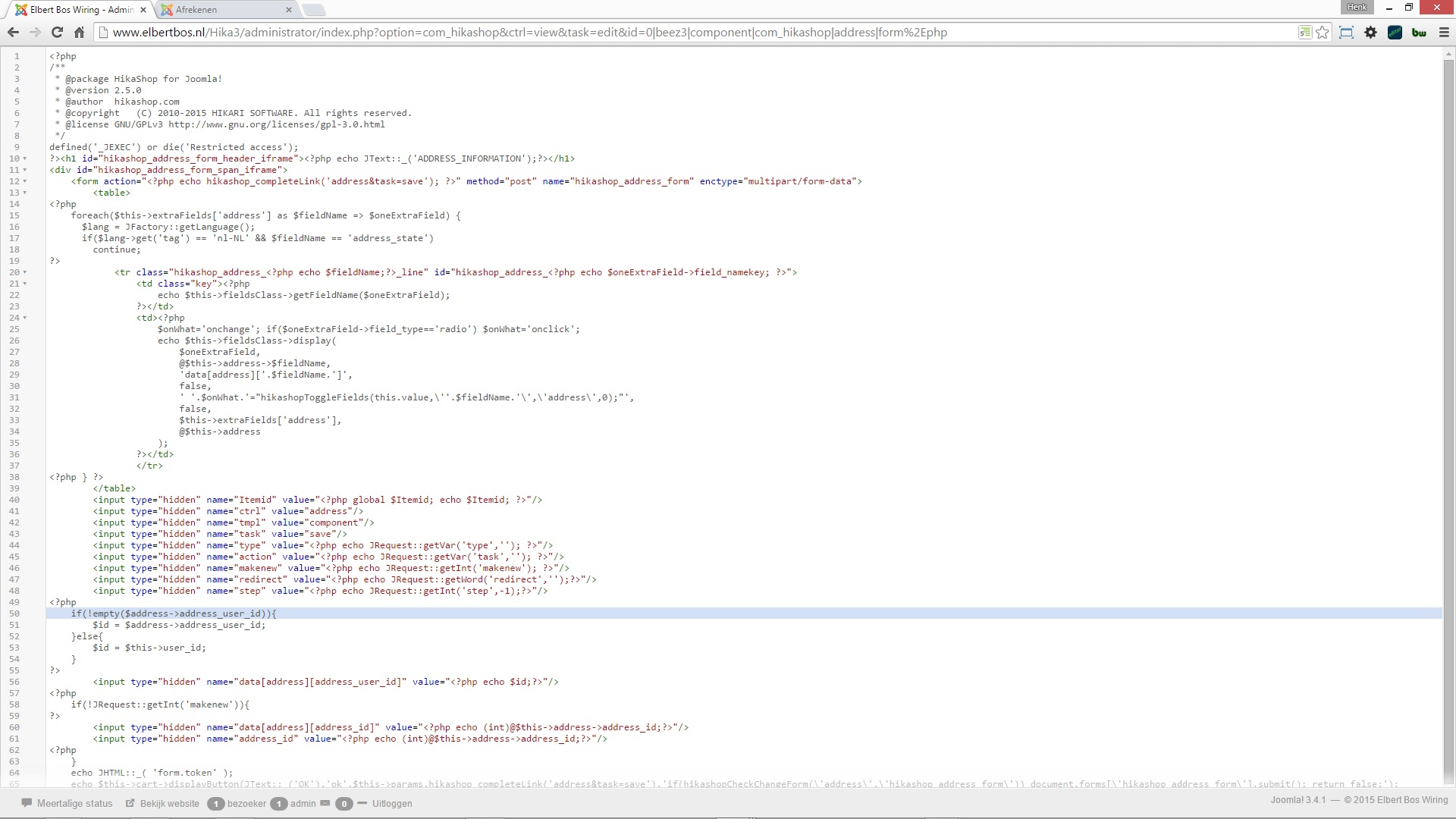

  • Posts: 43
10 years 11 months ago #207378
If my editing is correct (see screenshot) I 'm afraid I edited the wrong file.
"Staat" is still there in Dutch.
  • Posts: 26355
  • Thank you received: 4068
10 years 11 months ago #207395
It depends on which front-end template you're using (you are editing the view for the template "beez3") and which kind of address selector you're using in the checkout.
Depending if you're using the "popup", the "list" or the "dropdown" address selector, the used view in HikaShop might not be the same.
The "list" and "dropdown" selectors are using "address | show" while the popup is using "address | form".
The following user(s) said Thank You: elbertbos
  • Posts: 43
10 years 11 months ago #207452
You're perfectly right. I wasn't paying attention so I edited the address / form file for the beez3 template.
I should have edited this file for the favouritedark template. Now I've done that the problem is solved.
