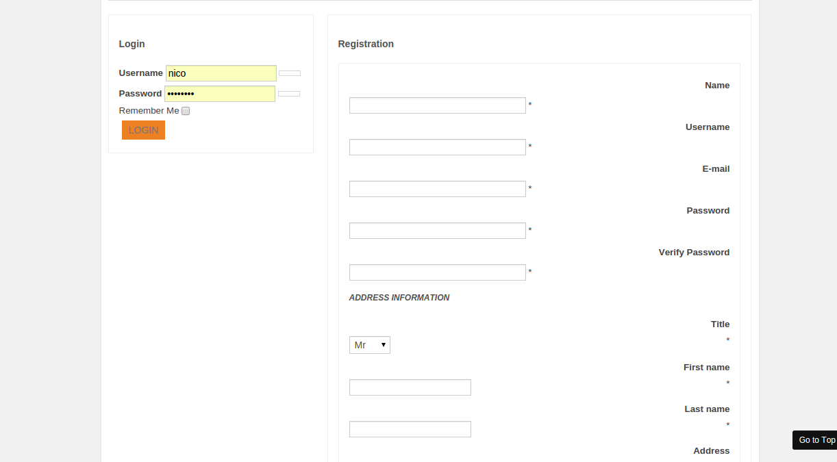

The registration form at checkout is messed up.
The field-names are at the right, and the next line on the left is the field itself.
If I switch off bootstrap design, it is ok, but then my products page doesn't look too nice.
Probably a template issue, but where and how can I fix this?

nico.vanderplasbaileo@gmail.com wrote: Probably a template issue...
Very likely, indeed, unless you or someone else has done layout overrides of either checkout or product page or both.
So, it depends on if your template is built with Bootstrap 2.x included or not. Ideally, you set HikaShop accordingly, and then, depending on other (mostly template related) factors, you might need to do layout changes in some views, or you might get away with some custom CSS.
Maybe you put a link to your site in the hidden section here (which I can't see), but sorry, more can't be said without seeing your site "live" on a web server.

10 years 11 months ago #207219
thanks.
I set bootstrap to No, and it works fine for me for the moment.
At first product page didn't look nice, but after a few changes, it looks ok with bootstrap off.
10 years 11 months ago #207199
Yes it seems to be a template issue. Here is tutorial to find the css modifications to do on a page:
We can help you to find the css causing that issue but for that you have to enable the bootstrap mode back ;)

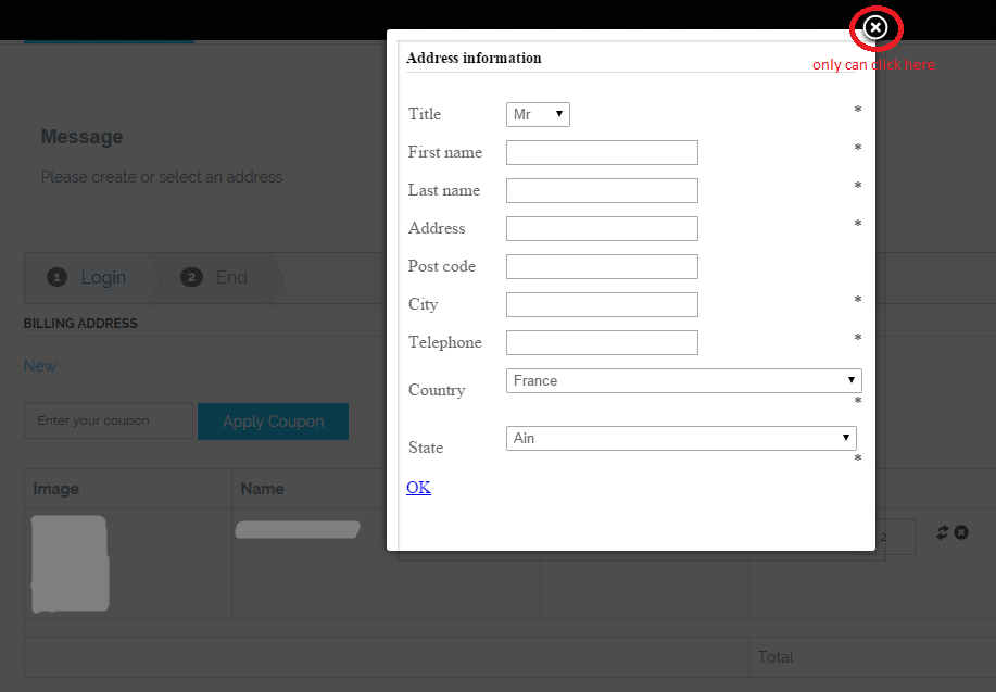

Hi Xavier! I have a problem that is I can't finish the checkout process. When I finish checkout, it's show Billing Information, but I can't type anything, can't click Ok, I only can close it. How to fix this problem and finish checkout?
More information i'm using:
- PHP 5.6.8
- Joomla 3.3.6
- Hikashop Starter 2.5.0
- Brower: Chrome and IE10
Last edit: 10 years 11 months ago by cknood. Reason: More information

This looks like a javascript error on your page preventing the OK button to work.
Without analyzing the issue on the page, it will be hard to provide a solution.
One thing you can try is to change the "Address selector" setting of the HikaShop configuration. That might be enough to circumvent the problem.
The following user(s) said Thank You: cknood
  • Posts: 4
10 years 11 months ago #207358
It's solved Nicolas. Thank you very much!

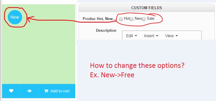

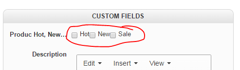

Hi, thanks for the answers. May you guide me how to change the option of the CUSTOM FIELDS?. Ex. Sale->Free, or add more options?

If you want to change the options of a custom field, you can go in the menu Display>Custom fields and edit the custom field and change the options there in the values section.

10 years 11 months ago #207567
Hi! I can't find them Nicolas, inside Display>Custom fields only have fields of Checkout. So I want to change like this attachment.
10 years 11 months ago #207599
If you only have Checkout custom field, you should probably reset the filter dropdown on top of your custom fields listing tab.
