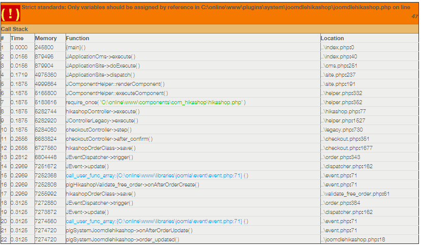

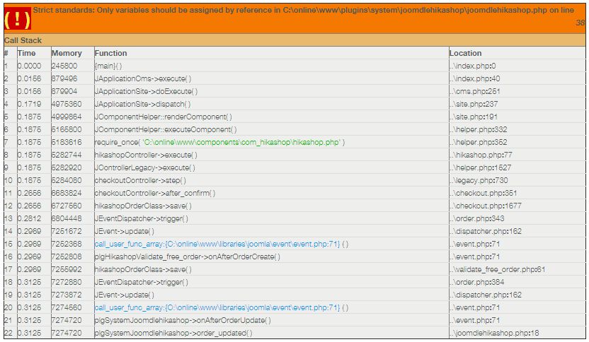

Hi to all! i've a problem at checkout when appear "Thank you for your Purchase".
The error message is on the attached file.
Anyway the product are correctly purchased, what could be the problem?
thanks
Roberto

The warning is in the Joomdle integration you're using. That's something you should report to the developers of the Joomdle integration (Joomdle themselves) so that they can fix it.
An easy solution is to turn off the "error reporting" setting of your Joomla configuration in order to hide these messages.
