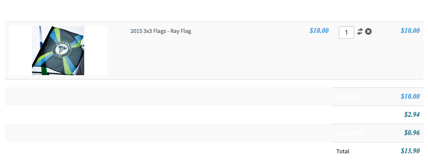

Looks like this may have been on our end...
Somebody had the TIC set to 00000 (General Goods and Services), which I thought was taxable in WA state, but it does not appear to be now.
Moving them to 90118 (Novelty Flags) appears to be correctly applying tax as expected.

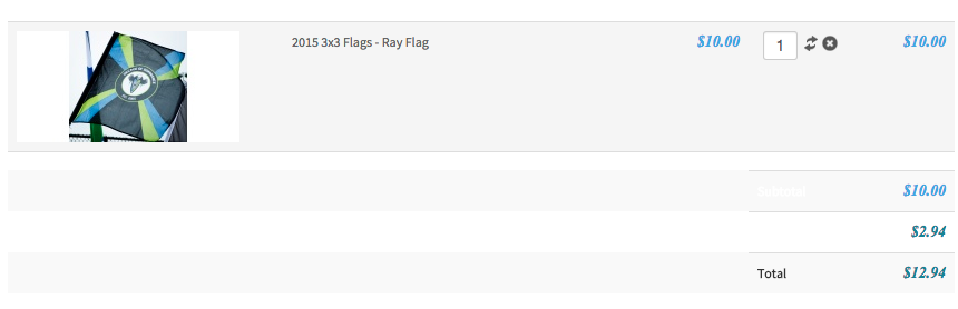

Attached are screenshots of the same item, with 90118 set, the tax is correctly included. With 00000 set, the tax is not.
Everything else is identical. (I changed the TIC and refreshed my cart page, that's the only change)
