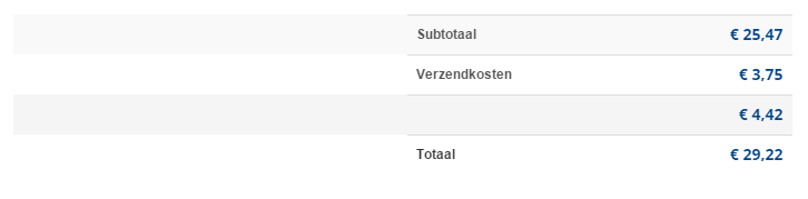

I cant figure out why the total of the shopping cart of my shop is not correct.
There is a total but that is only the costs for transport and the subtotal. The tax is not added.
It is also strange that there is no text before the VAT ...
Anyone knows ? Why the tax is not added to the total?

I suppose that it's because the 25.47€ sub total already includes the tax on your screenshot.
Set the "show taxed prices" setting of the HikaShop configuration to "Display both" and you'll see both the taxed and not taxed prices, and you'll be able to confirm that.
For the text of the VAT, it comes from the name of your tax rate that you configured via the "manage tax rates" button of the System>Taxes menu. So go there and make sure that you're using a tax rate with a name.
