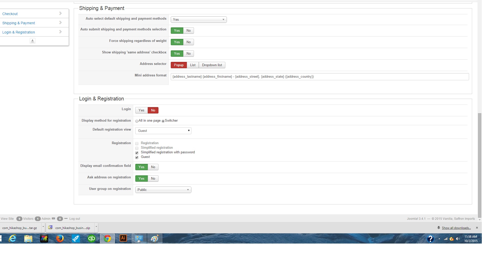

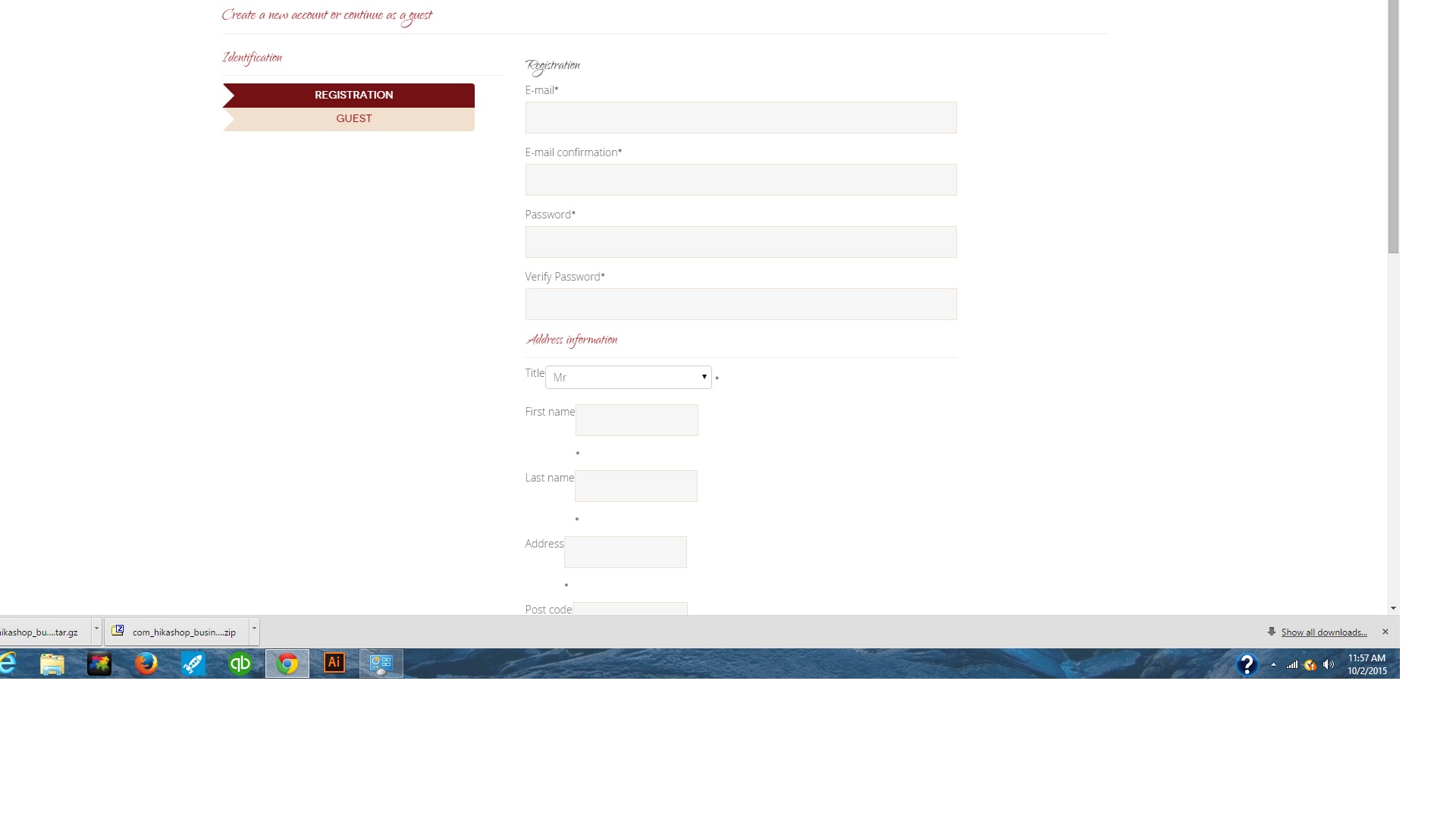

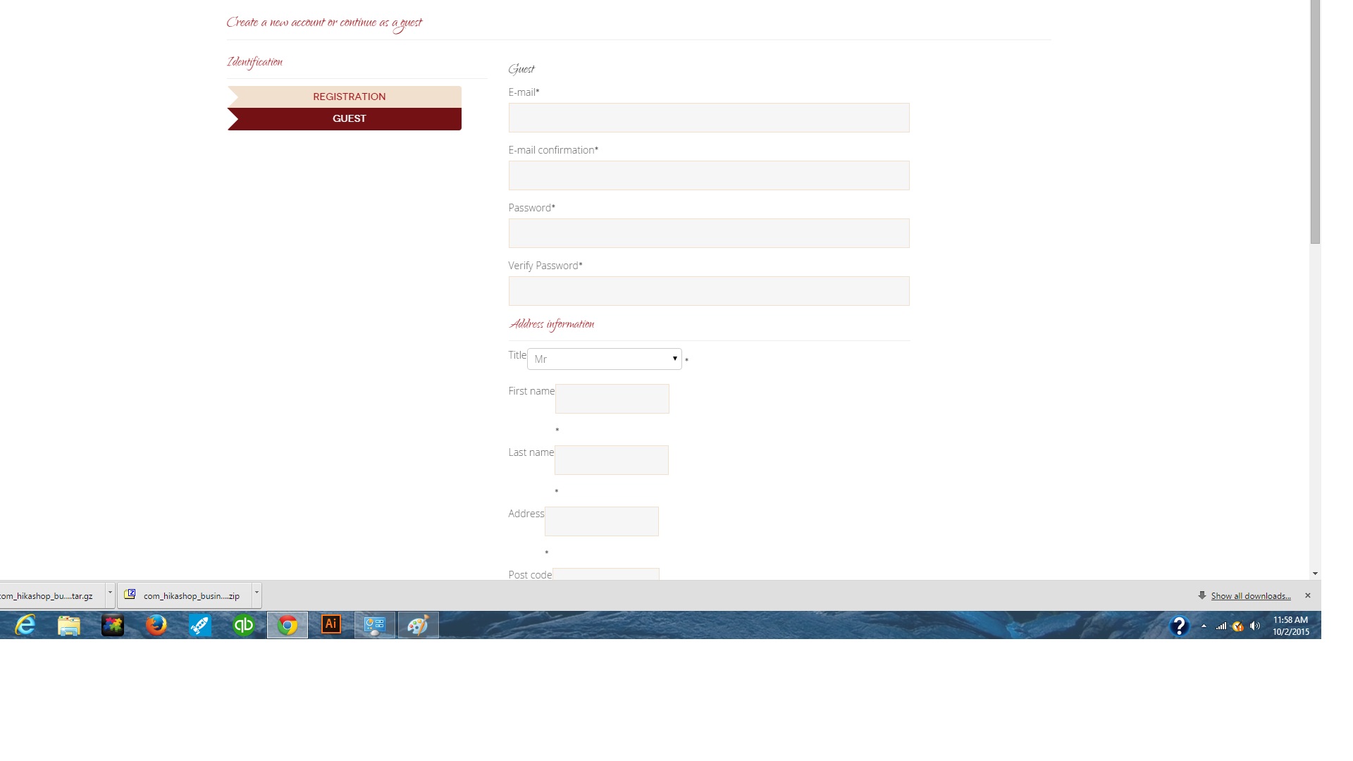

i want to setup the login for the customers who wants registration and by other side for the guest that just needs to shop occasionally but seems like wont refresh the form for differents users on the second step.

The issue is with your template customizing the login/guest selector appearance on the left of the page wrongly.
Either fix your template, or change the "Display method for registration" option of the HikaShop configuration so that there is no selector but the two forms, one next to the other.
