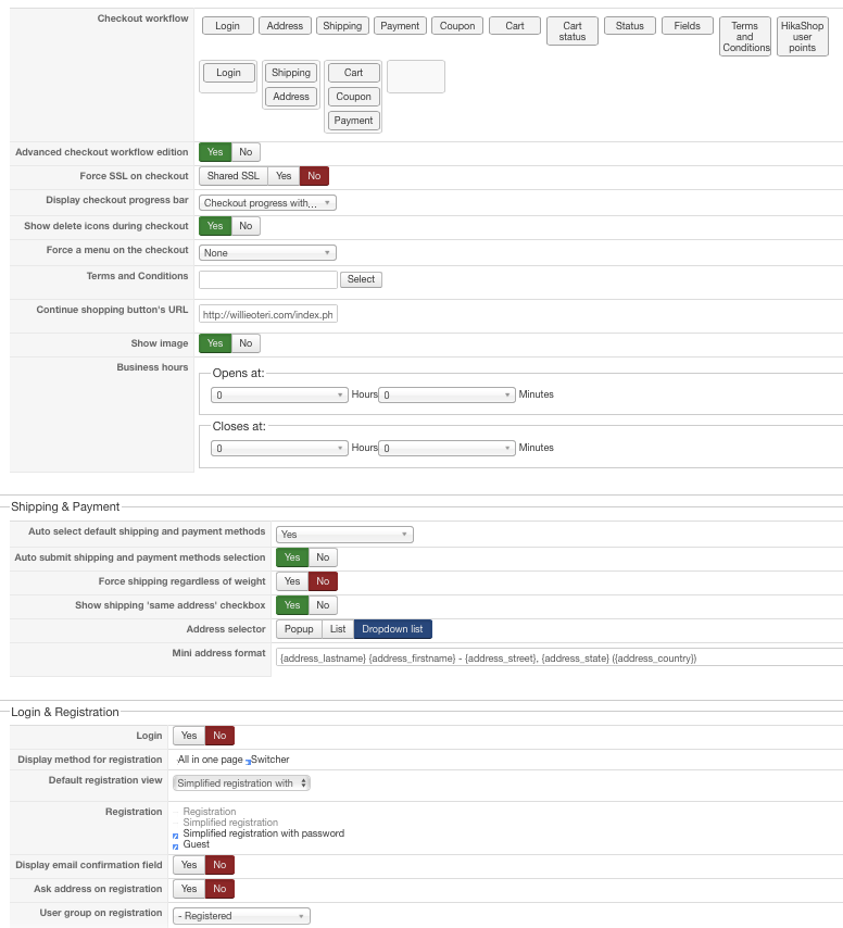

This problem I have now may be another matter. I will show you the settings I have had during this process. I am also running in debug and I can see the message modules and am getting no reported errors.

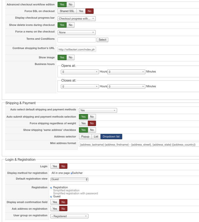

I am attaching my checkout process settings.

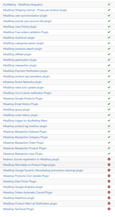

I am also attaching my Plugins settings because my problems began after disabling the "Redirect Joomla to Hikashop Registration" plugin. When I re-enabled the plugin, that did not fix the issues (so it probably wasn't related, but just in case.)

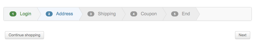

I am also attaching one example of the refresh/blank check-out screen problem that was FIXED by the reinstallation.
Note: after reinstalling Hikashop, my settings have not changed.

checkout problems continued:
The Groundhog Day shopping cart is back.
I am attaching my new shopping cart and Login/Registration settings behind the deja vu.
Initially, I had the Shipping Option dropped in above the address option on Step 2.
The error I received was, for a moment, “no shipping method found”
When I filled in my address information, and went to the next step, that error went away and it calculated the proper shipping.
checkout was otherwise successful.
I did not want users to see that error.
So adjusted my checkout configuration as follows:
I left the address in step 2, and moved the shipping to step 3.
(I would prefer we had the option to ONLY request a shipping address, and to only request a shipping address when the order actually requires shipping, so people buying downloads won’t have to bother with it.)

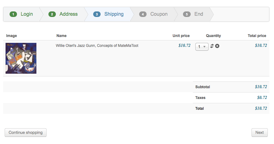

Now the refresh problem is occurring as follows:.
Step 2 is blank, and I cannot get from step 3 to step 4
Step 3 just keeps refreshing.
I have been searching for documentation on understanding exactly how the checkout settings need to be set for the various methods of checkout, and haven’t found it. I think my problems will be resolved if you direct me to information showing the various ways the cart can be configured and still work properly, along with exactly what the different Login/Registration settings really entail for the end user and what each of those settings requires from the shopping cart configuration (regarding address and shipping).
(but, I still adore your product and thank you for this forum!)

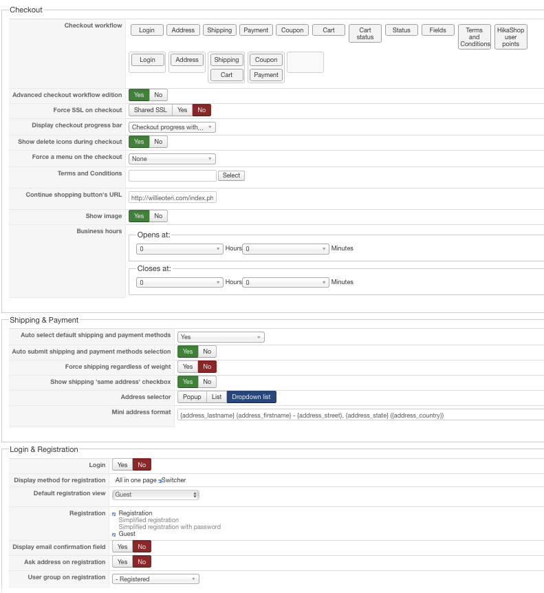

  • Posts: 32
10 years 9 months ago #219785

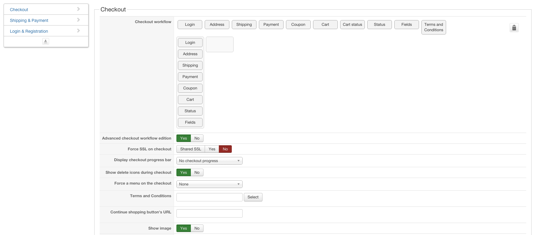

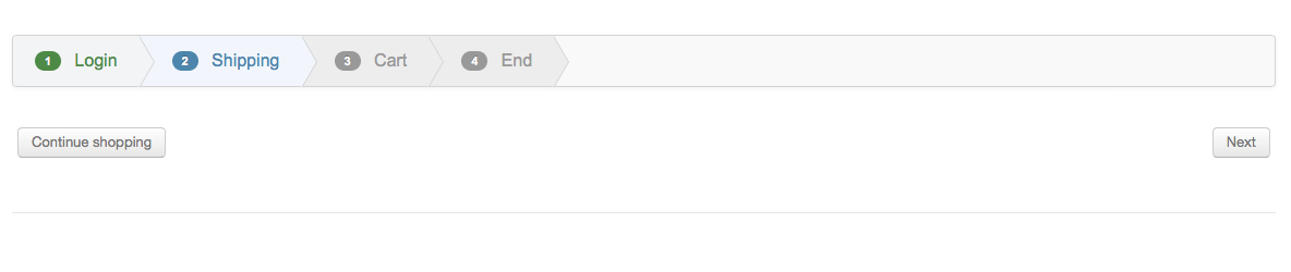

In an effort to solve my cart-refresh issue, I took my steps down to the 4 which seemed absolutely essential:
Login, Address, Shipping, and Payment.
I arranged them in every logical way I could think of, and each variation failed in one way or another.
Attached are all of my other checkout settings, which I left untouched as I re-arranged the checkout process.
For the settings attached, the possible checkout configurations ALL failed in one way or another.
I've attached screenshot .png files of each problem and its checkout configuration in the zip file attached.
  • Posts: 32
10 years 9 months ago #219814
SOLVED: www.hikashop.com/forum/checkout/880323-a...ing.html#forumbottom
My refreshing cart was related to my USPS shipping plugin. By changing the products in my cart I was able to checkout.
