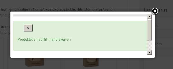

Meanwhile an additional problems appeared as well which I also suspect to be related to the last update: When adding products to the basket the pop up window is not correct (se picture, the X and the scroll down)
Last edit: 10 years 8 months ago by Odda.

2. This comes from the CSS of your template. It's not linked to the update. You'll want to add extra CSS code in order to hide that X if you don't want to see it.
