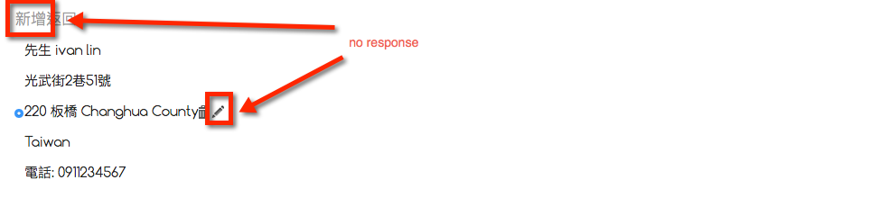

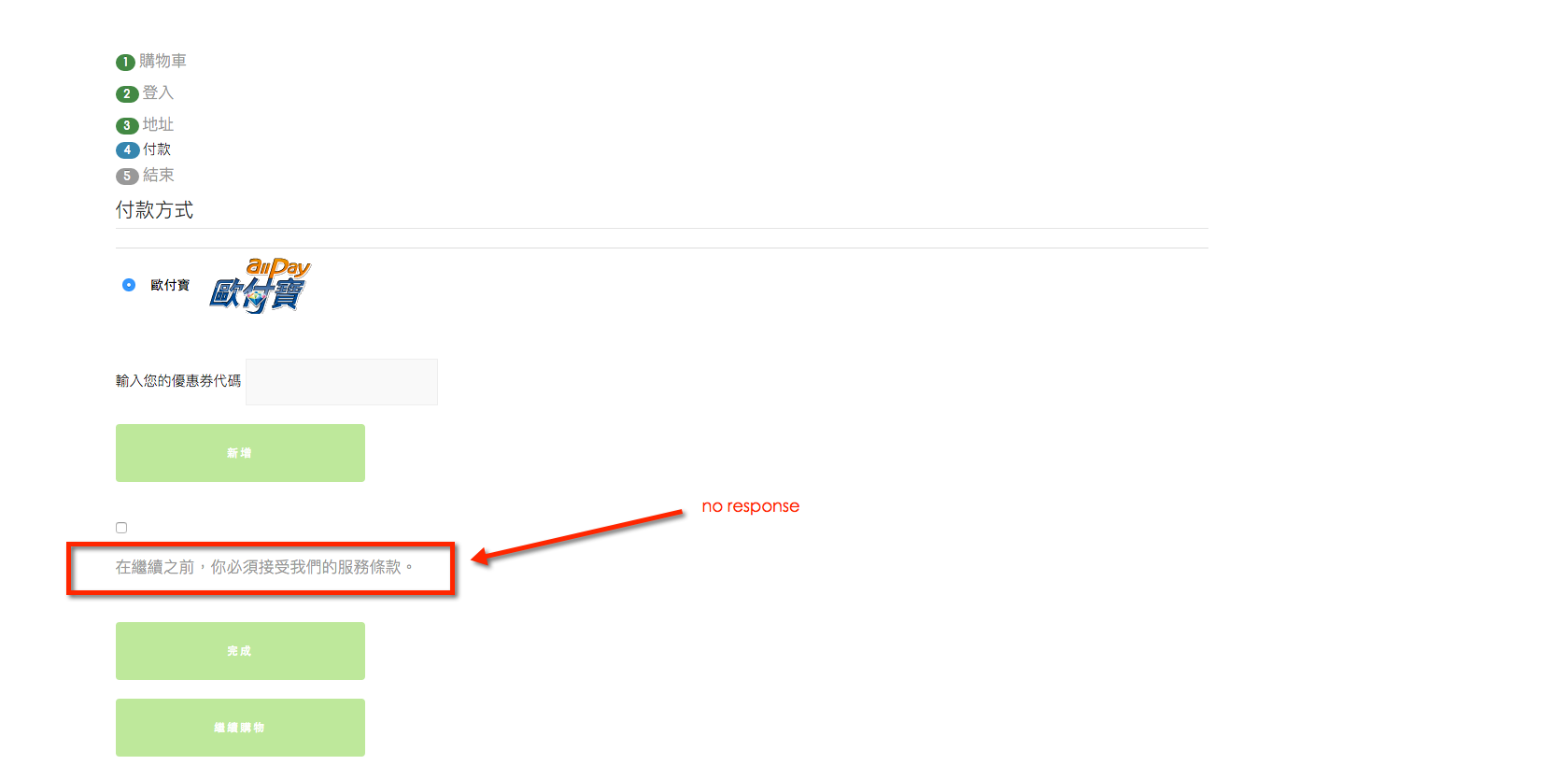

Hello~
When I checked the flow of checkout and memberAdmin , I found that some links are not work.
Below is the list , please give me some advices.
1.Edit member address
2.Add member address
3.See the sales announce
If you wish , you could check it by yourself

It seems that your Joomla template doesn't support bootstrap popups. Go in the HikaShop configuration and try the different values of the "popup mode" setting. I think that the "mootools" one should hopefully work.

You are right. When changing to mootools , the problem is solved.
