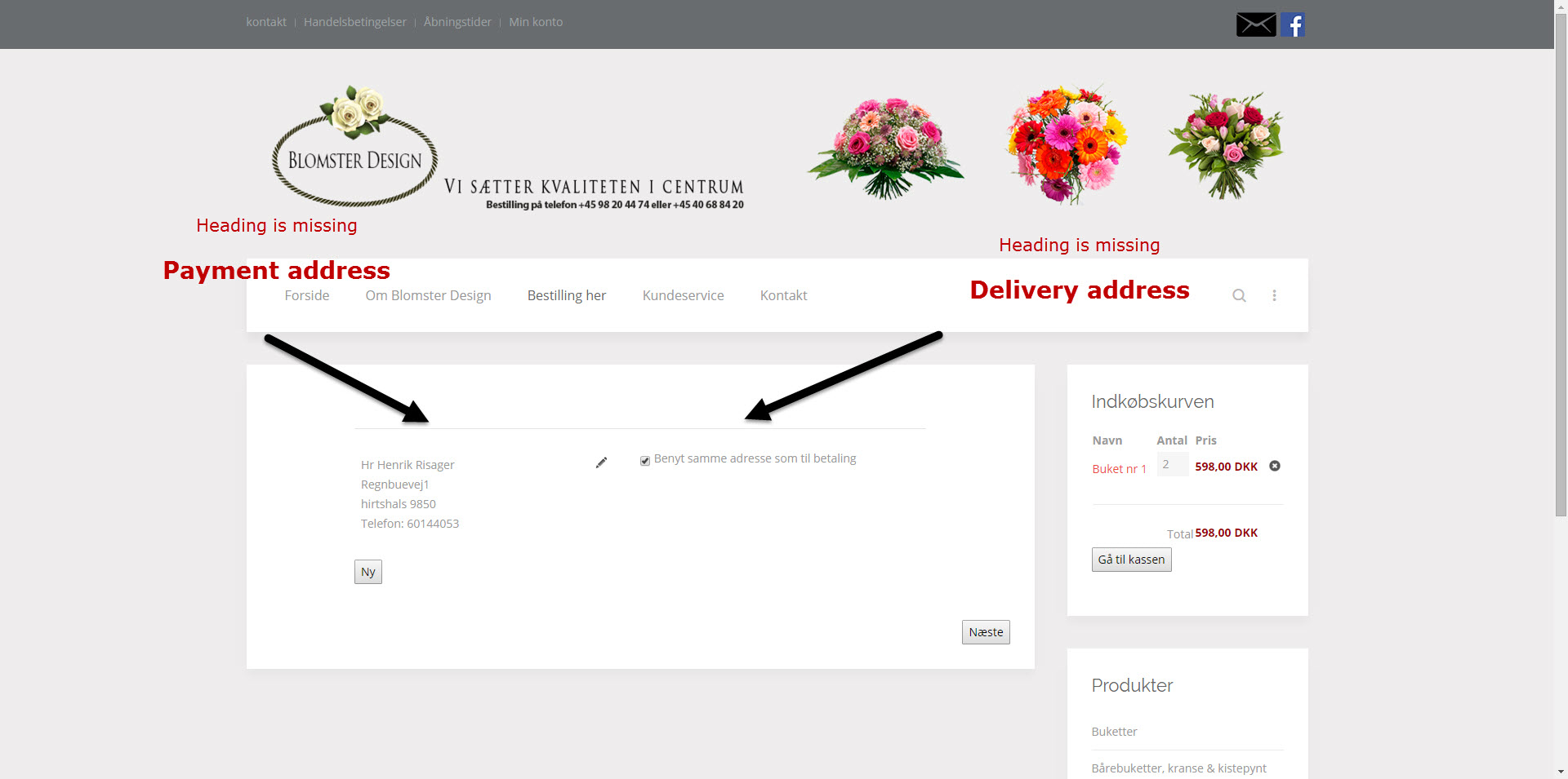

I can not get the headline back in my checkout , they are gone in payment , delivery addresses. anyone who can help with how I get them back.

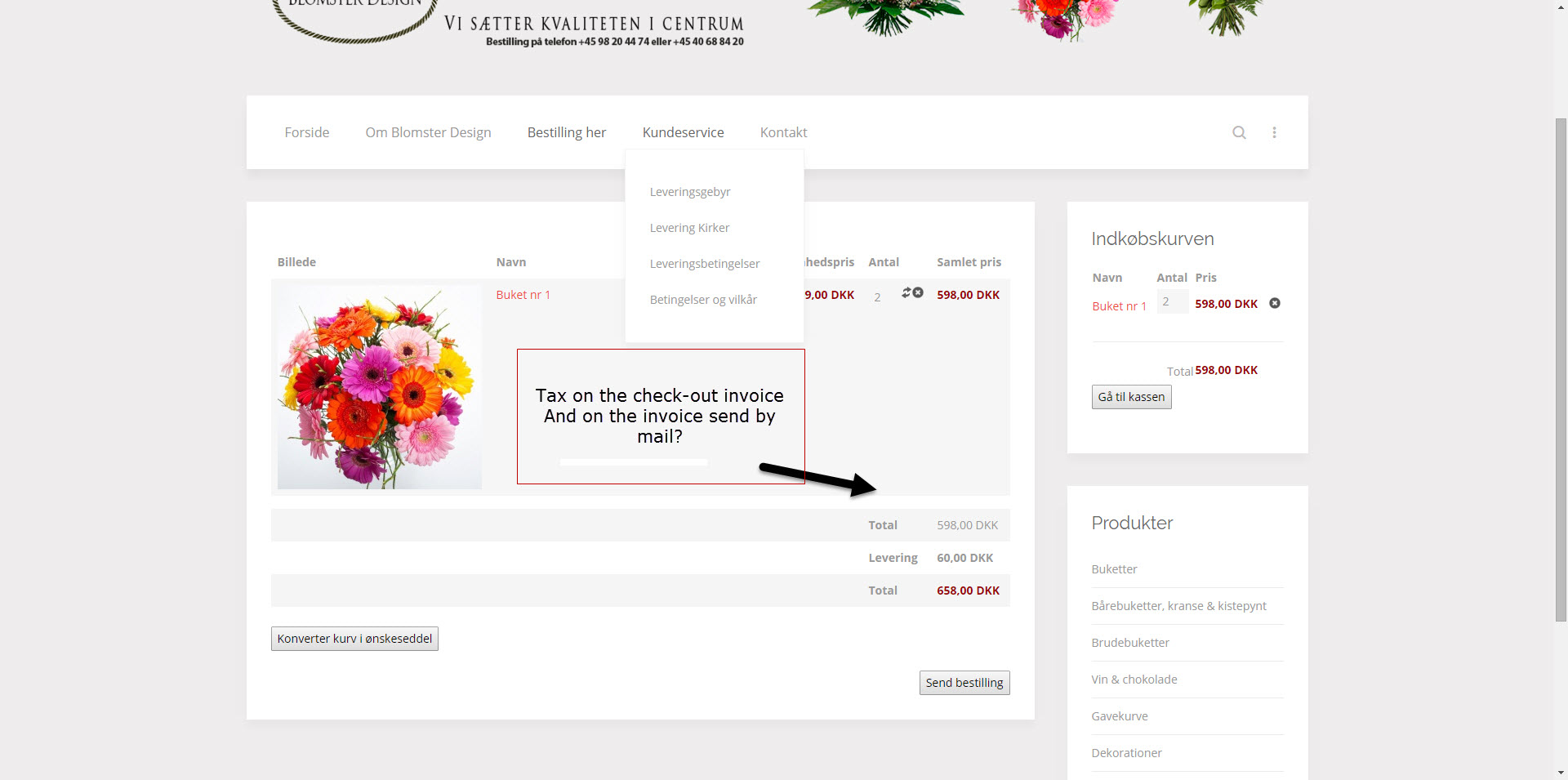

I need VAT on check out invoice and the invoice send by mail? how is that done?

Question 1: How do I put headlines on the check out pages?
Question 2: How do I make the invoice so that customers can see the amount of VAT on the invoice

1. There are by default in HikaShop.
If you removed them then just do the reverse to add them back.
There are many ways you can remove them so hard to say what to do to get them back...
It could be that you modified some of the view files of the "checkout" view via the menu Display>Views.
It could be that you use translation overrides to modify the text of the titles there.
It could be that you add custom CSS code to hide these areas.
Or it could even be that you wrote or modified a plugin to remove these from the output.
2. If you don't get any VAT during the checkout and in the orders/invoices, it means that there is a problem with the setup of your taxes. I would recommend to first check each point of this FAQ:
www.hikashop.com/support/support/documen...ion-listing.html#faq
It's highly likely that the solution is in there.

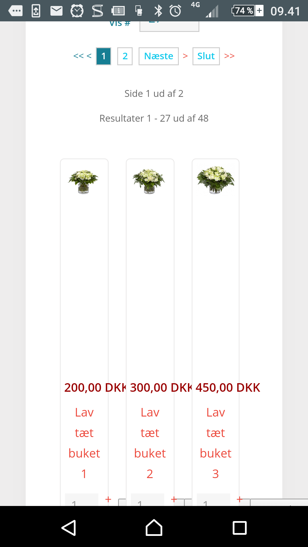

One more question :-) my page show in responsive, but my shop dont?

Do you know the reason why my page is in responsive but the hikashop is not ?
Henrik Ris
  • Posts: 26380
10 years 6 months ago #227788
1 - because you do not use the "bootstrap design" in the HikaShop configuration.
2 - because your responsive framework in your template is not "bootstrap 2".
