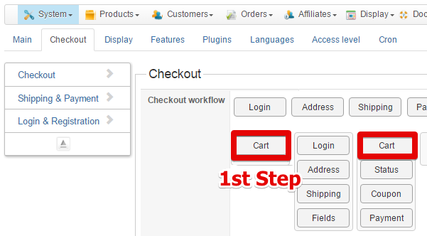

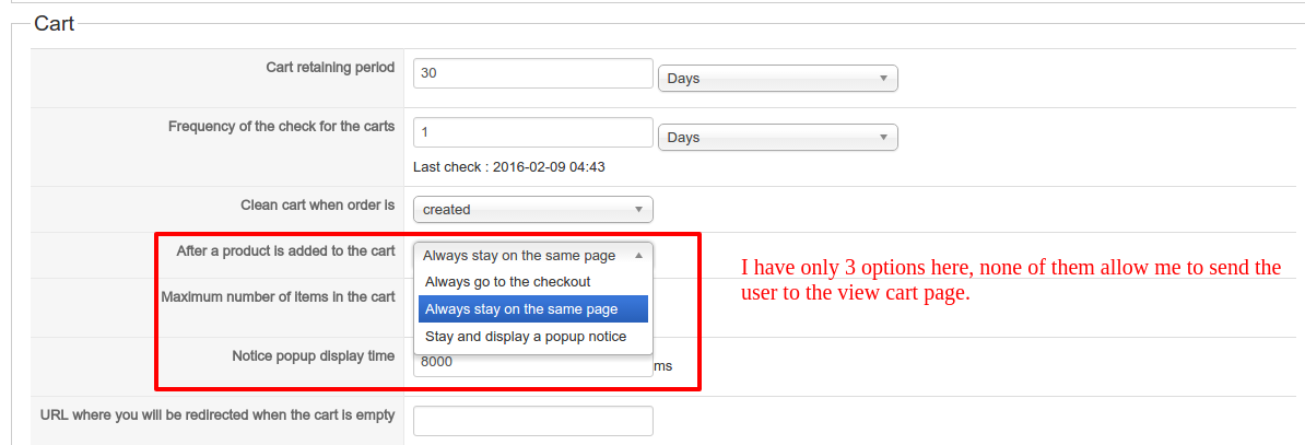

10 years 9 months ago #229334
by spagatherings
Replied by spagatherings on topic Redirect to view cart after add to cart
10 years 9 months ago - 10 years 9 months ago #229362
by Philip
Replied by Philip on topic Redirect to view cart after add to cart
Last edit: 10 years 9 months ago by Philip.
