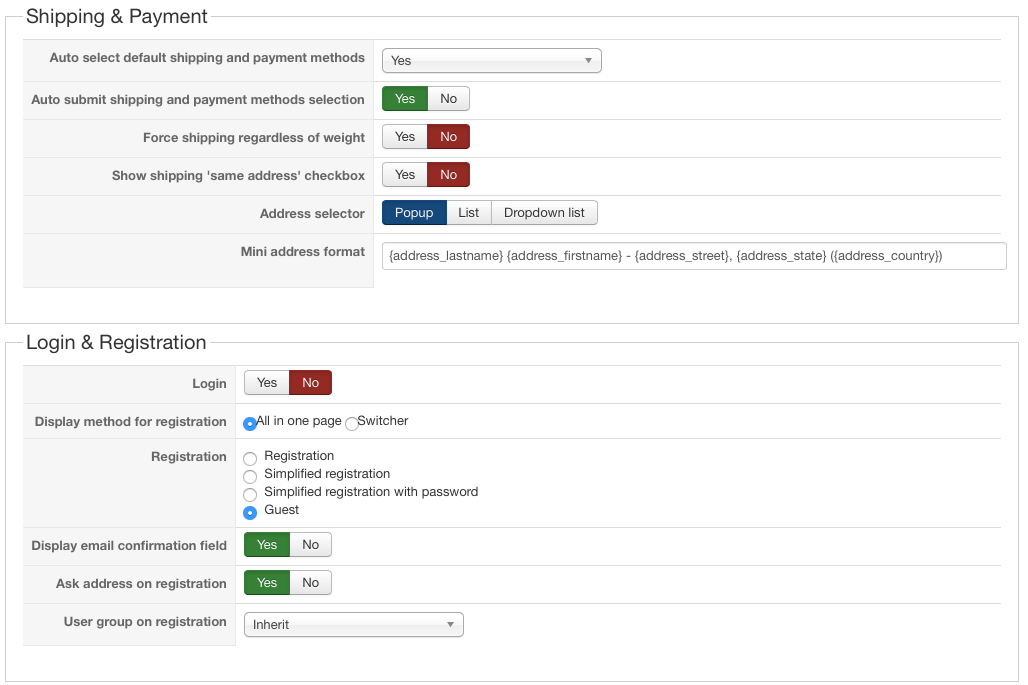

10 years 4 months ago #233293
Regarding the fact that you have to click twice on the next button, that's because you apparently turned off the "auto submit shipping and payment methods selection" setting of the Hikashop configuration.
So turn that option on and it should help.

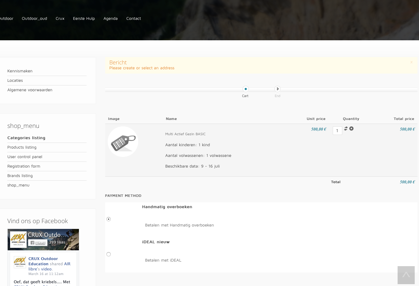

10 years 4 months ago #234754
OK, I am trying this solution, but somehow the address fields are not shown in my checkout. En therefore I cannot finish the checkout....
I probably have done something myself, but I cannot figure out what it is.
I attached a screenshot of what it looks like.
10 years 4 months ago #234764
Then you should add an "Address" action through your checkout workflow via "Hikashop->System->Configuration->Checkout", also can you show us some screenshots of how you configured your checkout workflow so that we can check it ?
Thank you.

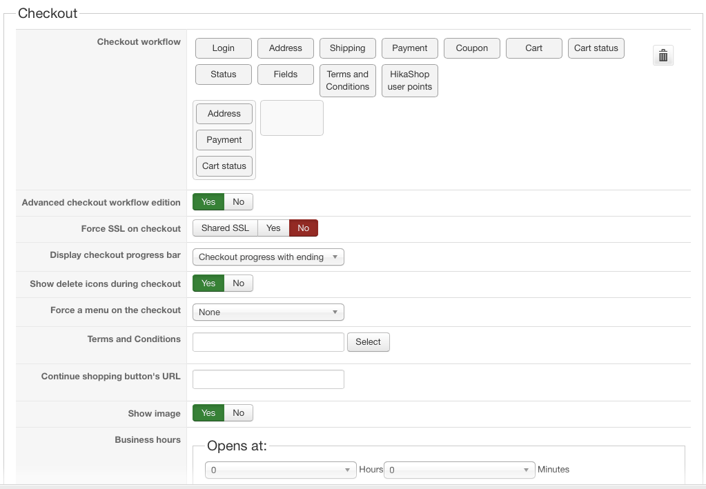

I have an "adress" action in the workflow. That is the weird part....
See the attachments with the configuration.
10 years 4 months ago #234873
To use the address step you need to have the login one too.
Even if in the settings you use the "Guest checkout".
