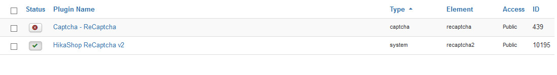

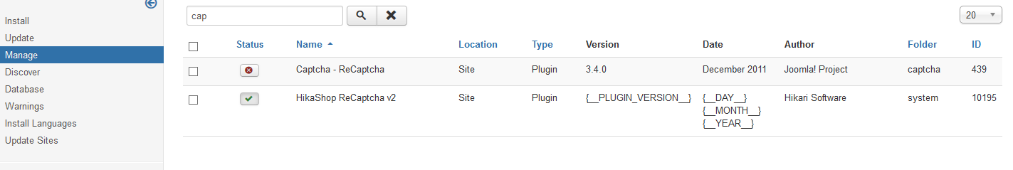

And it also seems as if it doesn't install properly as the language files doesn't load and it looks strange in the module/plugin manager in Joomla. (c.f: attachment)
Help , it's sort of urgent.
Thx
Last edit: 10 years 1 month ago by vseva. Reason: added screen shot

The fact that the version and date are not correctly filled in the extension manager is not a problem. It's just that we didn't set them when we published the version you have.

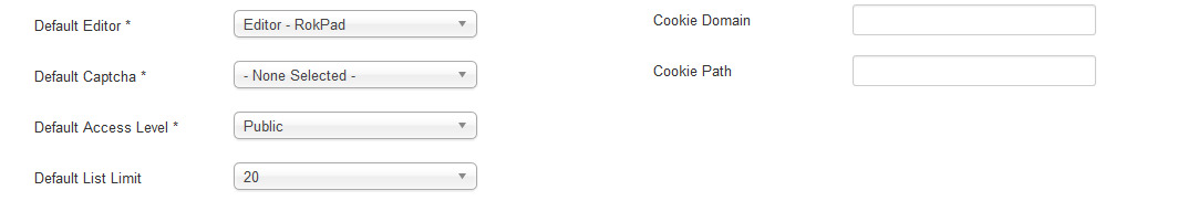

It must come from the fact that you've activated either the captcha option of Joomla or the recaptcha plugin of Joomla and so Joomla's recaptcha intercepts the registration event sent by HikaShop and tries to check the captcha itself, but it fails because it is not configured.
That explains why you don't have the problem in the guest checkout or the contact form since in these cases, there is no registration event, and thus the captcha system of Joomla is not called if activated.
So if I'm right (and all you said leads to that), our plugin has nothing to do with your client website not online, and it is just a misconfiguration of your Joomla...

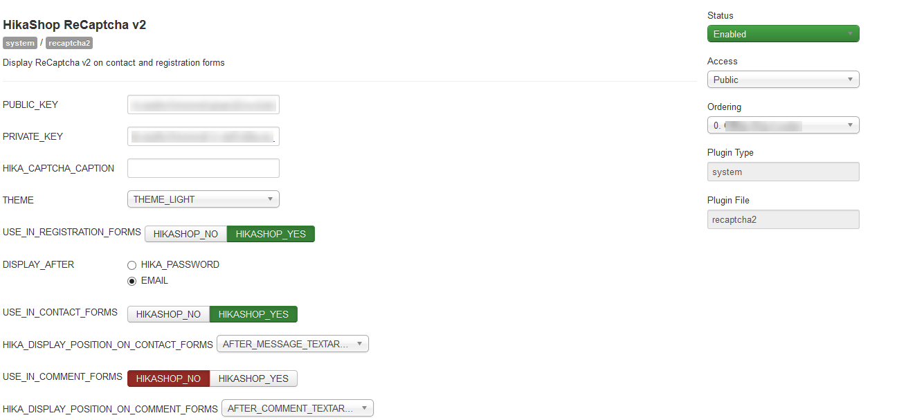

Unfortunately, what you mention is not the case, as I haven't enabled the Joomla captcha/recaptcha option.
As I said, I read all the posts and got a lot of info from them, and checked all points mentioned in them too.
It's not like I didn't do all the research first.
But the fact remains, it just is not working.
