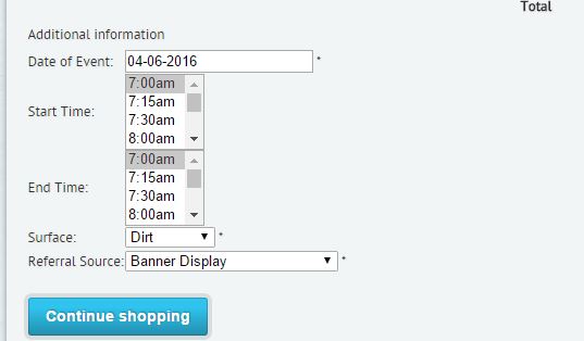

Attached is my image.
I tried to make the start and end time required, but my browser kept asking me to enter a value. I had to make it not required in order to proceed to the next screen. How do I make this required?
I would like put the end time next to the start time instead of under it. How do I change this?

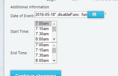

Do you know why the date box has the additional information after the date? I get this when I go to the next screen and go back to the date screen.
Lastly, I would like to have custom fields during each step of the check out. How do I do this? For example, one step will have date and times with the last step asking for additional custom questions.

1. Could you provide screenshots of the settings of your custom fields ?
2. You'll have to edit the file "fields" of the view "checkout" via the menu Display>Views.
3. What do you mean ? Could you do a screenshot of the problem ?
4. You can do like that:
www.hikashop.com/forum/checkout/877364-p...-checkout-steps.html

Hi Nicolas
1. Do you want to see more of the screen than what I have attached above?
2. I see the "Checkout" button in the display section of the custom field but I don't see where I would put this custom field "End Time" next to the "Start Time".
3. The "Date of Event" field is in the image originally attached. Please let me know if you need me to provide more screen.
4. Where would I enter the custom coding? Is that in the CSS section?

3. Are you talking about the text disableFunc...? That must be a bug. In fact, it might be linked to the point 1. Can you confirm that you're using a custom field of the type "advanced datepicker" and not "simple datepicker" ?

3. I don't see an option for Advanced Datepicker. I attached the date file for you to see.
4. Thanks. I will take a look.

1. You need your custom fields for the start and end time to be single dropdowns. Then, make the fields required.
3. Then, enable the HikaShop date picker plugin via the Joomla plugins manager and that should appear.

I'm working on #3 above. The date box is now not showing me the calendar. The backend has the preview perfect but the site doesn't have the calendar button for the customer to click on.

Please download again the install package of HikaShop on our website via the menu My account>My subscriptions and install it on your website. We've added a few patches since the release of the 2.6.3 concerning the advanced date picker. It's working fine now on our end with the latest build.

I downloaded the zip package of Hikashop Business and uploaded the file through the extension manager in Joomla. There were no changes for me. The date still does not show the calendar box. Was I supposed to use the other links in my subscriptions?

The Advanced date picker display will display a "calendar image" only if you're using the "bootstrap design".
In the front-end, if you do not have the "bootstrap design" you indicate that you do not have the CSS for Bootstrap 2, so you do not have the Bootstrap 2 icons.
The latest patches in HikaShop for the Advanced date picker are related to possible javascript issues.
If you want to add a button in the current version of the advanced date picker, it will require a modification of the plugin (which will be reset when you will update HikaShop).
$ret = '<input type="text" id="'.$datepicker_id.'" data-picker="'.$id.'" data-options="'.$dateOptions.'" class="hikashop_datepicker" value="'.$txtValue.'"/>';
