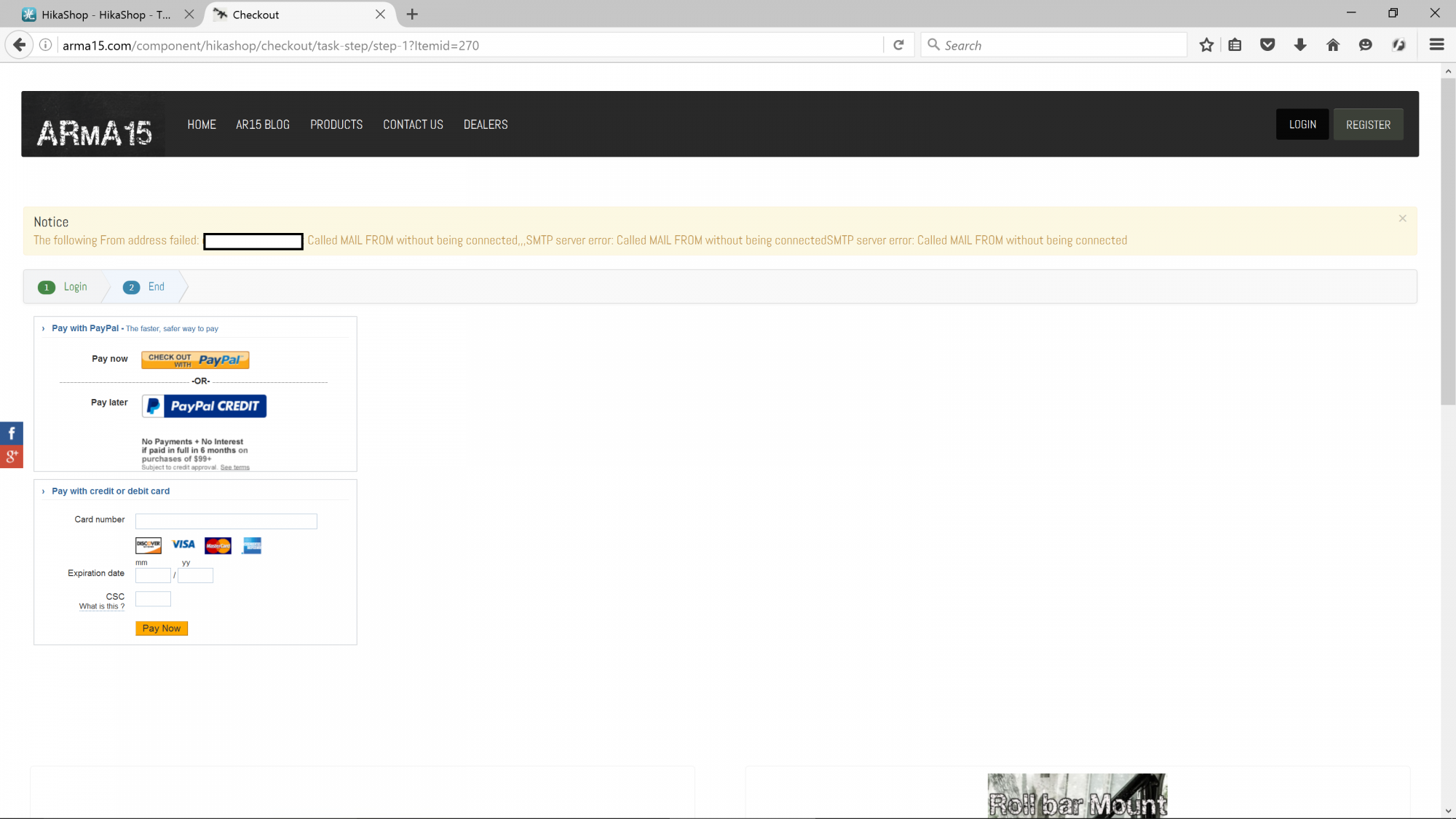

See attached picture to see what error is showing up on the last page of checkout where they put in CC info.
So I have 2 problems I am not sure if they are related to the same issue or completely different but i need to get both fixed:

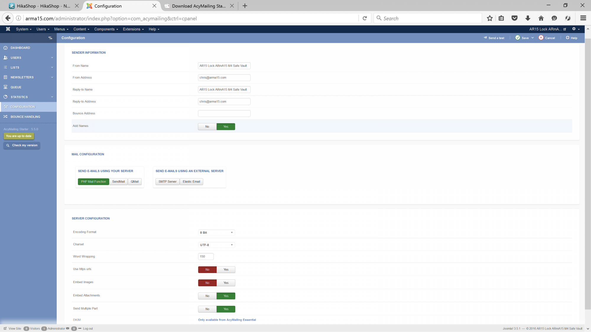

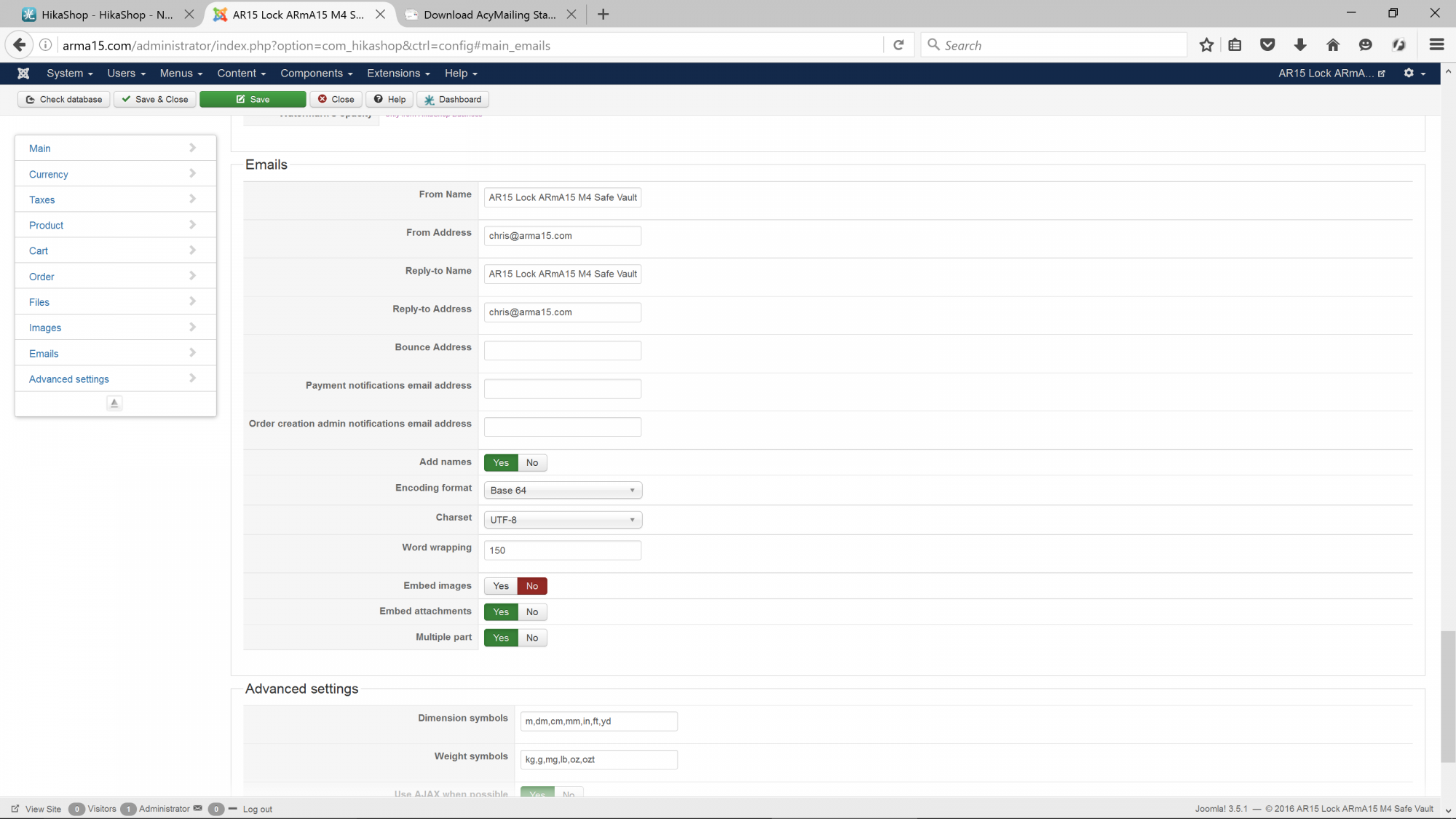

1. Error message as shown in attached picture. I did a forum search and found another user with a similar problem and the recommended fix was to check acymailing config and hika config emails were the same. I checked the emails were different I updated the email and still got the same error, so another setting is wrong somewhere.

The error you get says that Joomla is trying to send the HikaShop emails with SMTP. And your AcyMailing configuration shows that you're using the PHP mail function and not SMTP for AcyMailing.
So I would recommend to check the emails settings of your Joomla configuration. Try the "mail" sending method there, and if that still doesn't help, check the email settings of the Joomla configuration with your hosting company.

However the problem isn't solved in hikashop as I am still getting the same error:
Notice
The following From address failed: This email address is being protected from spambots. You need JavaScript enabled to view it. : MAIL FROM command failed,SPEED LIMIT: Account has exceeded the max emails per hour allowed (check_mail) ,451,SMTP server error: MAIL FROM command failed Detail: SPEED LIMIT: Account has exceeded the max emails per hour allowed (check_mail) SMTP code: 451SMTP server error: MAIL FROM command failed Detail: SPEED LIMIT: Account has exceeded the max emails per hour allowed (check_mail) SMTP code: 451
After entering the required info from hosting service for stmp i was getting the error above and test email was not working on global config. They since changed my max emails to 150 and is working on global config and i get the test email but in hika shop i get same error still. Also I cleared my cache and tried again but still same error weird as it is resolved with my global settings but on checkout page error is still popping up. I must be missing something here.

The answer was for both questions. The error says that Joomla is not able to send emails, and that happens at the end of the checkout. So that means that your second issue is only a consequence of the first one.
