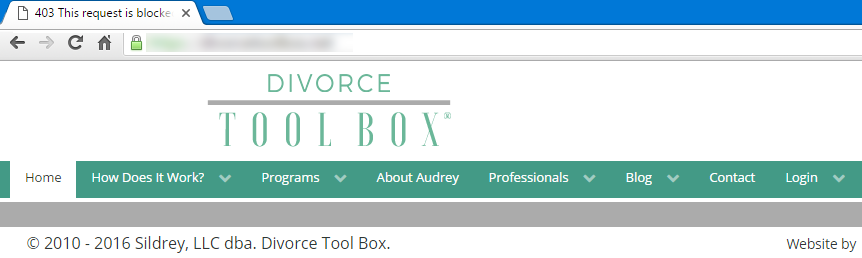

And be aware that for now, from my side your website isn't reachable, I only see this :
Thanks to allow me to see your website.

I'm not able to access your backend. I'm getting the error: take.ms/KzN5W

1 - Your website is still unavailable (front-end backend) due to "Admin Tools".
You have to understand that we are not able to provide you any kind of useful help if we can't access to these elements.

I have disabled AdminTools so you should be able to access the admin panels. If you still get blocked, then it must be my server firewall so I will need your IP address. You can give me just the first 3 sets and not the last set of your IP. That should be enough for me to check the firewall settings.

FYI, I have removed all IP blocks on my server firewall so with the disabling of AdminTools, there should be no issue in anyone at HikaShop view the website or accessing the admin panel with the credentials I sent privately.
