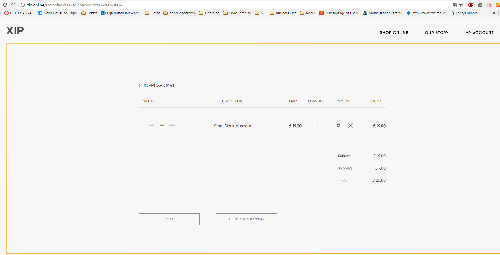

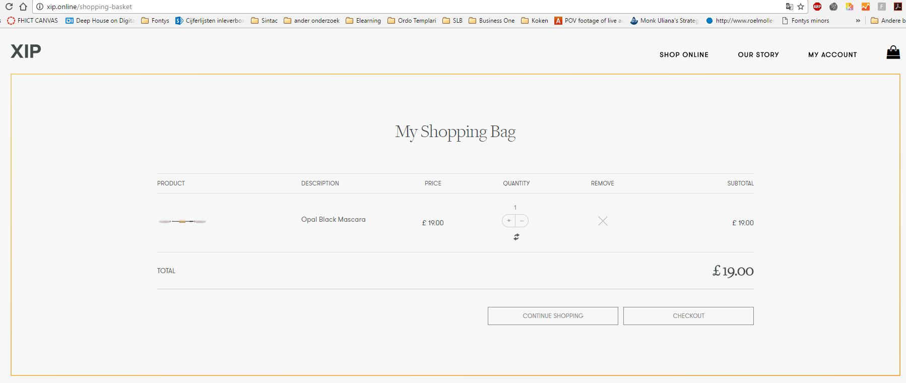

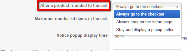

In the configuration, there is the "After a product is added to the cart" option - however, there is not the option to go to the "cart".
When I go to the check-out cart, this is a different "view" on the cart, then when you would go to the menu-item "cart".
My customer would want them to point to the same location (menu item cart) and I cannot seem to find the correct setting to make that possible.
Attached are 3 screenshots:
1. The selection options "after a product is added to the cart"
2. Cart in checkout
3. Cart in Menu (which is the requested location to go to after a product is added to cart)
Thanks in advance for your help!

There is no option to do that.
The current add to cart system isn't designed to support redirecting to the cart so even with code modifications, it would require hacking in the file components/com_hikashop/controllers/cart.php in the udpatecart function, which we don't recommend.
Next version of HikaShop will have a more modular approach to the cart system which will allow to have plugins to be able to handle that.
