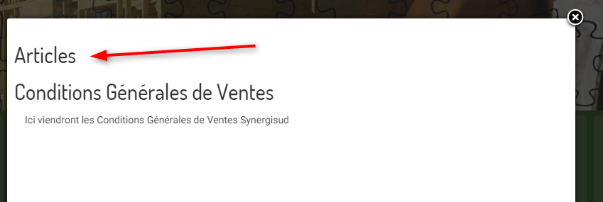

  • Posts: 88
9 years 9 months ago #254671
The sales conditions are shown.
But I am not able to remove the Articles mention...
How could I remove it ? I've tried inside Joomla! how this article should be shown also in the menu where this article is connected without any
success.
Thanks in advance for your help and advice,
Stéphane
  • Posts: 86028
  • Thank you received: 14172
9 years 9 months ago #254712
Vous pouvez ajouter ce CSS dans le CSS de votre template pour ne pas avoir cela:
.bd-container-inner h2{ display:none; }
