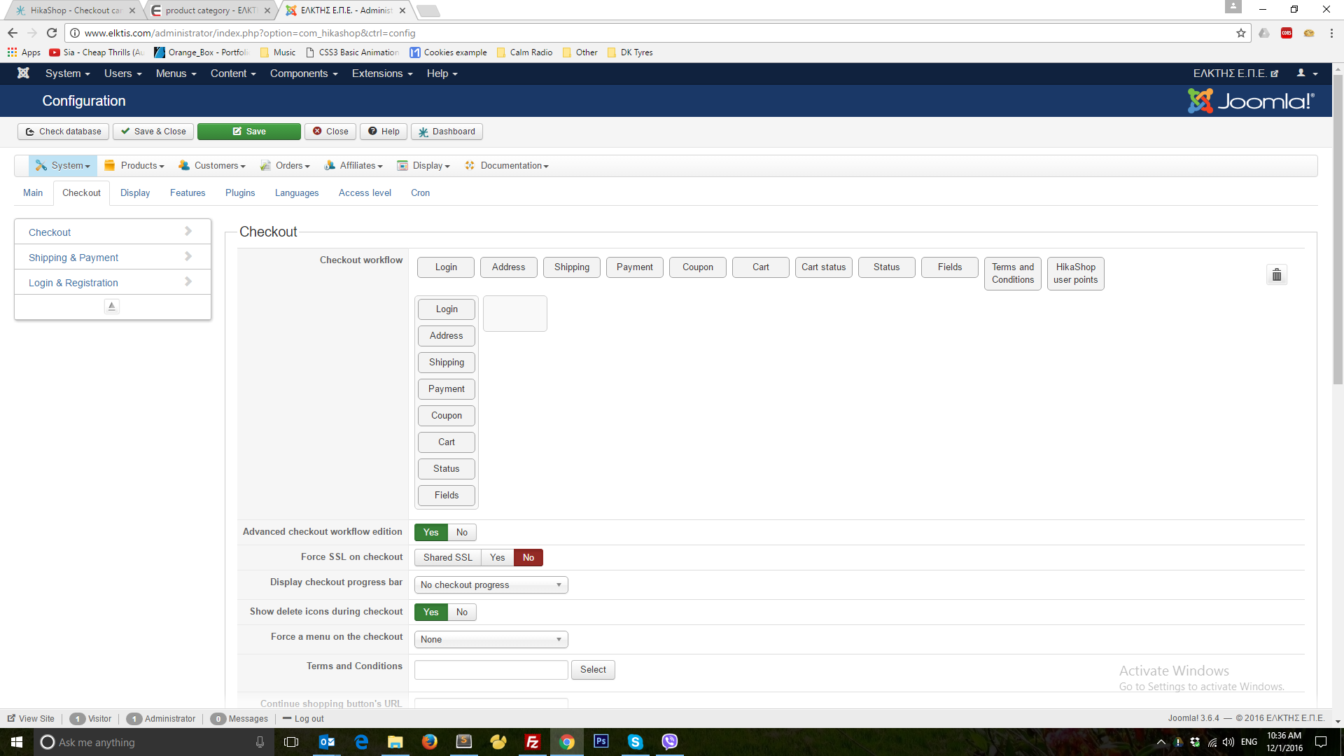

Could you also provide a screenshot of the settings under the "checkout" tab of the HikaShop configuration so that we can see how you configured your checkout ?

Yes, I realize that I didn't provide link. Here it is: www.elktis.com/en/shop
Also, there is screenshot of checkout settings, as you requested.
Meanwhile, I was exploring problem a bit deeper and I discover that issue is somehow connected with template. If I switch to joomla "native" template Protostar, I get everything works.
From your experience, where is the problem exactly? Template used in frontend works just fine in all other aspects.

Your screenshot only provide some of the settings of that tab. You could provide a screenshot of the rest of the settings ?

I am sending you requested usernames and pass in confidental area. I guess you don't need screenshots of entire checkout settings, since you can see that part now.
