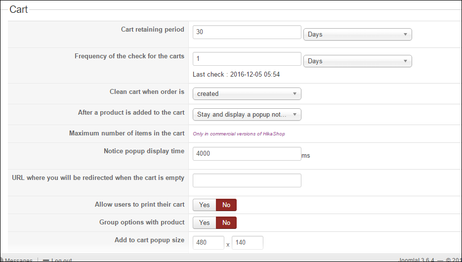

How come my Add to Cart notification is not showing after i click the Add to Cart button?
I already made sure that the setting in the Cart - "After a product is added to the cart " is set to Stay and display a popup notice.
Can you tell me if it is another JS conflict?

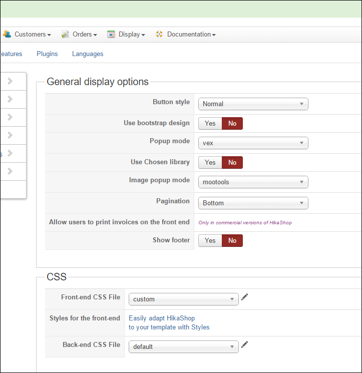

9 years 8 months ago #257005
Can you try it with a different value for the "Popup mode" option that you can find via "Hikashop->System->Configuration->Display" ?
Thank you.
  • Posts: 8
9 years 8 months ago #257070
Hi Mohamed!
I tried to change the Popup mode from mootols to vex, to inherit, to bootstrap but the notification is still not popping up.
What could be the issue here?
