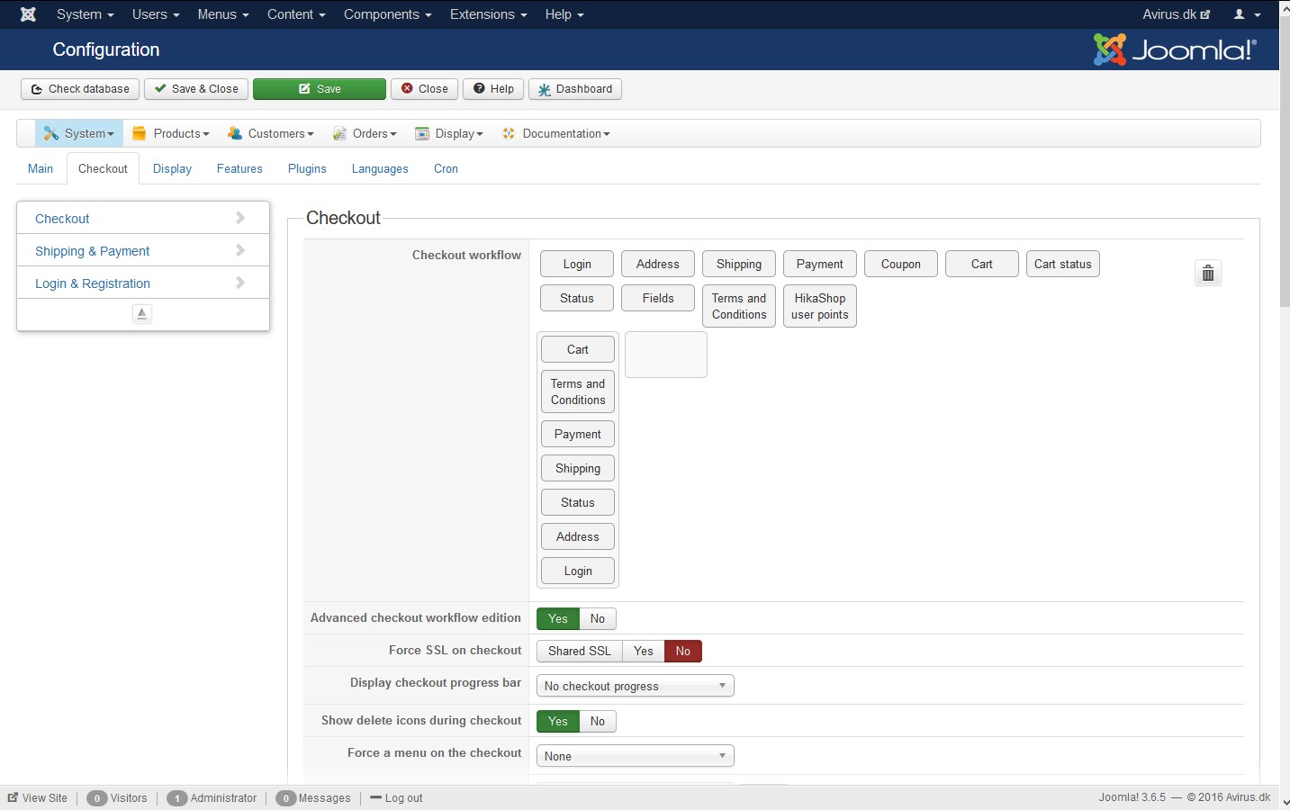

After i press yes to checkout, i got this with debug on.:
Warning: Illegal string offset 'country_Afghanistan_1' in /var/www/clients/client5/web15/web/administrator/components/com_hikashop/classes/field.php on line 640
Recoverable fatal error: Object of class stdClass could not be converted to string in /var/www/clients/client5/web15/web/administrator/components/com_hikashop/classes/field.php on line 640
in long time, there has been no error... :-/
I dont have done anything to make this besides updates joomla ?
I recently sees that my webhost svipe to php 5.4? and i stork the net to see that error (not this issue), and i get PHP 7.1 back, and the error in the top still came.
I have not purchased the new essentials, because i cannot afford it.
I hope some can guide me to try something..
Regards Chris
