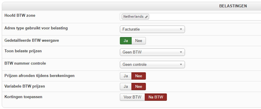

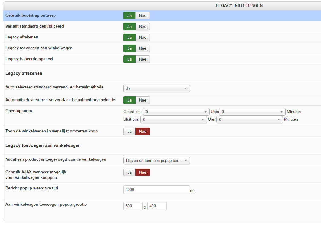

Because it was your first message in our forum, some information asked during the creation of the thread was not kept.
So we do not have the details about your website (HikaShop version number, link, etc).
Regarding your displaying issue, would it be possible to have screenshots about your HikaShop tax configuration and about your advanced/legacy settings ?
www.hikashop.com/support/documentation/5...nfig.html#main_taxes
www.hikashop.com/support/documentation/5...html#advanced_legacy
