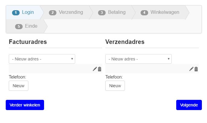

When you put products in your cart and then go to checkout and login Hikshop shows you the invoice and shipping addresses.
Expected result: Hikashop would show the actual shipping and invoice addresses (if they are present in the user's account)
Actual result: The address and shipping addresses are not shown. Both dropdown fields have "New" set as default value instead of showing the addresses. When you press next and then return to the previous page it does show the addresses.

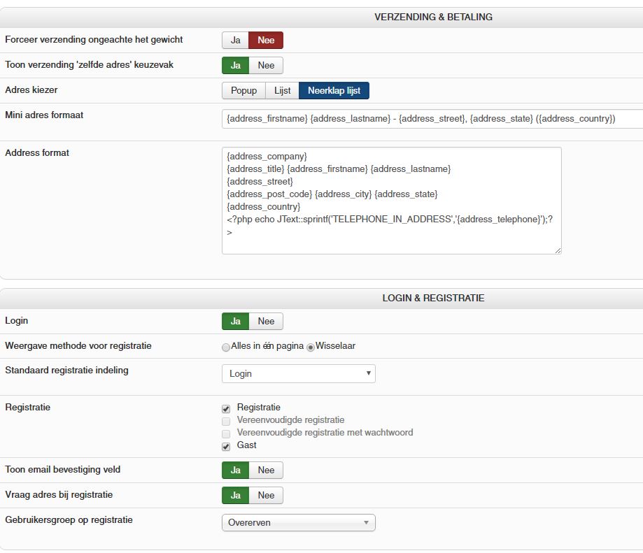

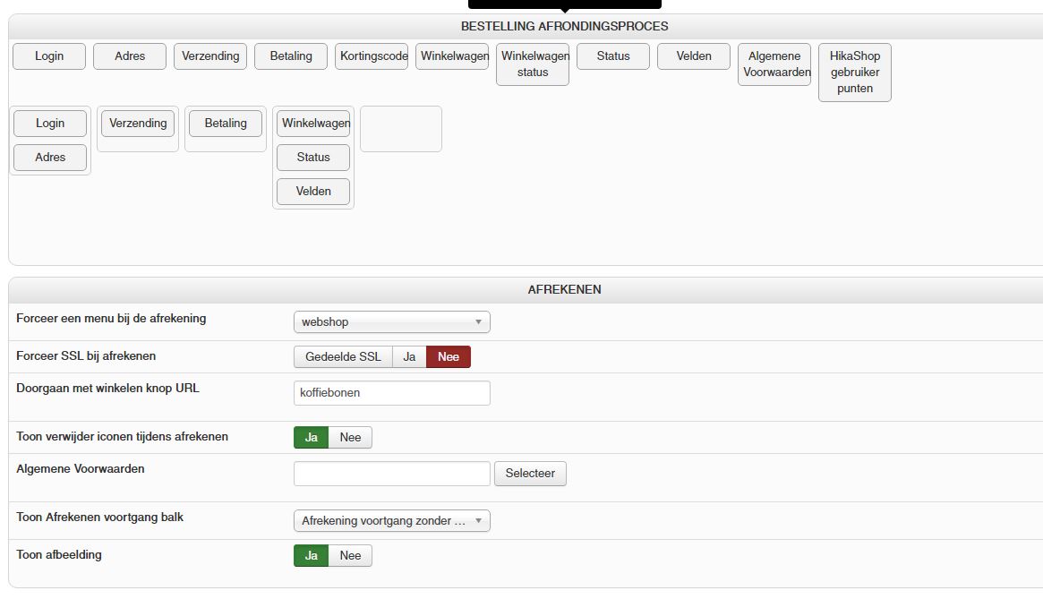

Could you provide a screenshot of the settings under the Checkout tab of your HikaShop configuration ?

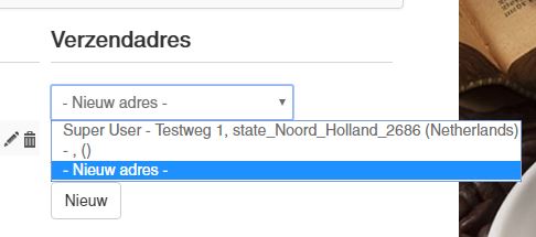

I noticed two more things.
1) In the drop down it shows an additional choice labeled "-,()". Once to click "Continue Shopping" and then come back to the checkout the addresses are shown as expected and this strange option is not visible in the dropdown anymore.

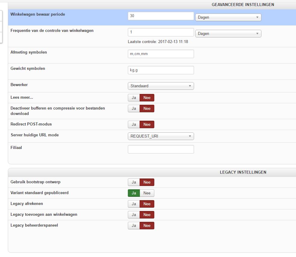

And in Advanced tab, add some configuration page screenshot, in order to see all your configuration part.

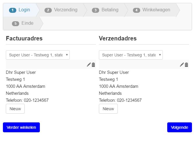

I'm sorry but I don't see the problem on your website.
I've tried these instructions that you provided:
- go to the frontend
- add products to your cart
- go to checkout and login with the user account provided
And here is what I get:
monosnap.com/file/fzQM9iDgMrs4gcUlpq0HOEbrY7wHhb
I see no text "-,()" in the dropdown (probably due to an empty address of the user you're using), and the default address selected is the address of the user.
