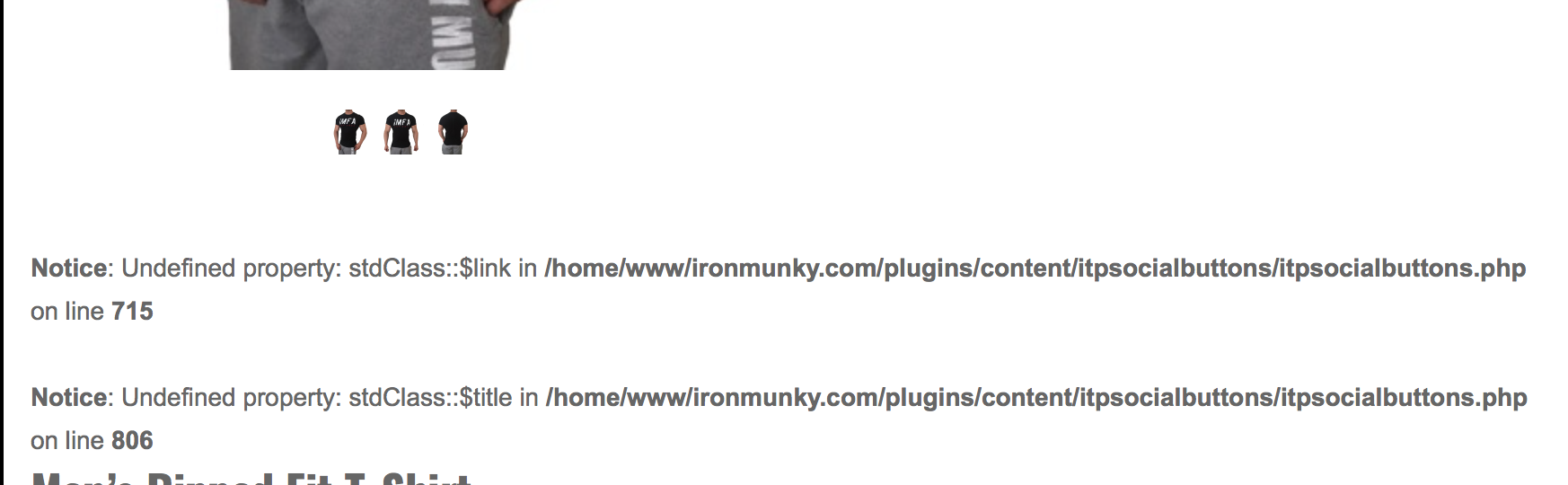

  • Posts: 7
9 years 5 months ago #263250
Thank you so much Nicolas. I have been trying to crack the problem for two weeks now so really appreciate your help with this :)
I now however have another issue....
My site is showing a few issues on every page now. Please see attached images for details.
I have no idea why these are showing but they appear on every page that you navigate to when on the site? Also the menu bar continues to scroll down with the user. This has never happened before now.
Any guidance on how to solve this would be much appreciated!
  • Posts: 26380
9 years 5 months ago #263251
If you take a look at the error message you will see that the mentioned plugin is not related with HikaShop or our support.

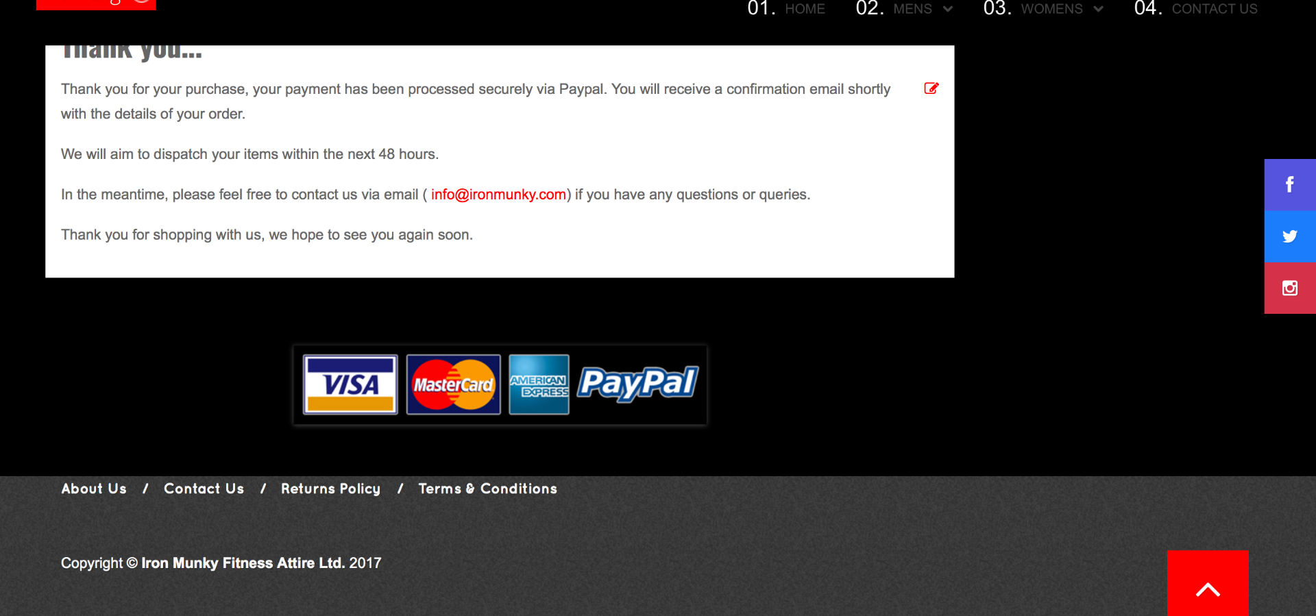

  • Posts: 7
9 years 5 months ago #263352
All sorted. I had debug mode on.
One other issue I have now is my return URL page from PayPal completion...
The return url is a hidden menu item and I am trying to ensure a specific thank you banner shows on the page. At the moment it does not appear on the redirected link.
The link I have is as follows:
index.php?option=com_content&view=article&id=32&Itemid=309
The final section of this link 'Itemid=309' is the ID for the banner I am trying to insert onto the page.
Can you advise if I am making a mistake or doing this wrong?
Have attached a snap shot of the return URL (hidden menu).
Many thanks!
  • Posts: 26380
9 years 5 months ago #263355
The final URL is what you have configured in your paypal plugin for the "return url".
www.hikashop.com/support/documentation/2...form.html#additional
About your second screenshot and the warning message ; once again, it is related to a plugin which does not belong to HikaShop or our support.
  • Posts: 7
9 years 5 months ago #263437
Yes the return URL in my previous message works.
The problem is I want this return page to show a 'thank you banner' to customers.
The item ID is 309. I have added this at the end of the return URL but it still doesn't show up when customer returns.
  • Posts: 86028
  • Thank you received: 14172
9 years 5 months ago #263440
I don't understand what you mean.
What is the link between your banner and that item id and the return URL ?
What is a "banner" for you ? A module you configured in some way ? Did you configure it to be displayed for that menu item ?
In what way is this linked to HikaShop ?
If you have the return URL index.php?option=com_content&view=article&id=32&Itemid=309 in your payment method and that you go to the page index.php?option=com_content&view=article&id=32&Itemid=309 after the payment, then HikaShop's job is done.
If you want to change the styling of the page index.php?option=com_content&view=article&id=32&Itemid=309 then you can do it as any normal Joomla article page, no ?
