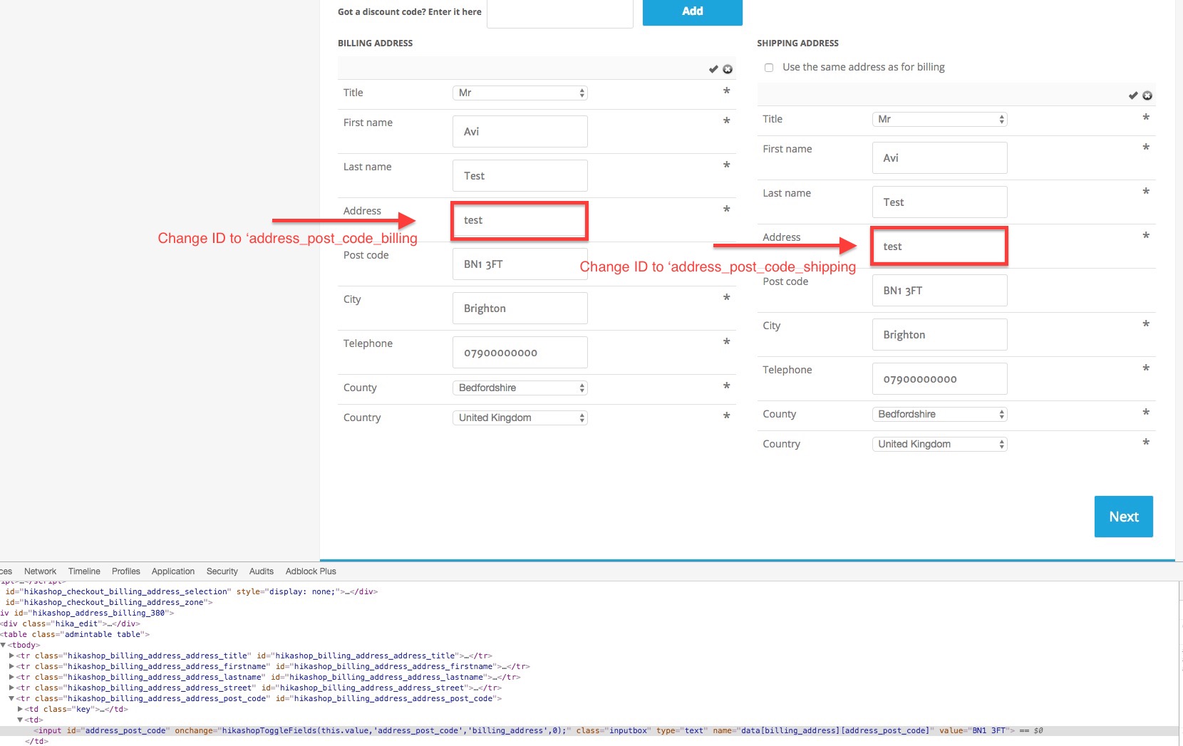

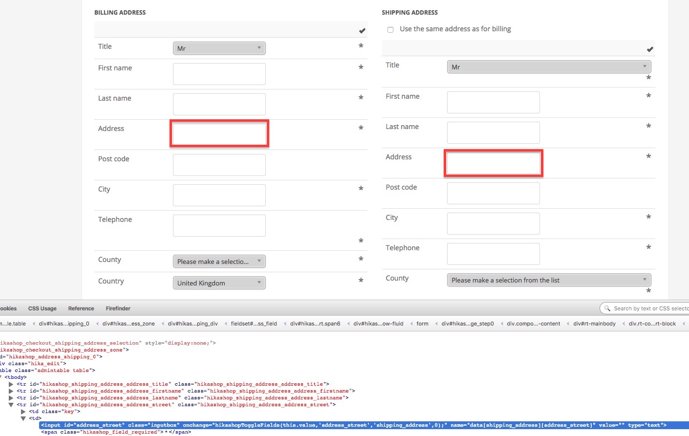

Hey,
At the moment both billing and shipping address are using the same ID :
Both IDs are called 'address_street' - Is there a way to change the ID of the Billing Address fields?
This is not for CSS purposes. I know that for CSS I can use
hikashop_shipping_address_address_street td input#address_street
Ideas?
