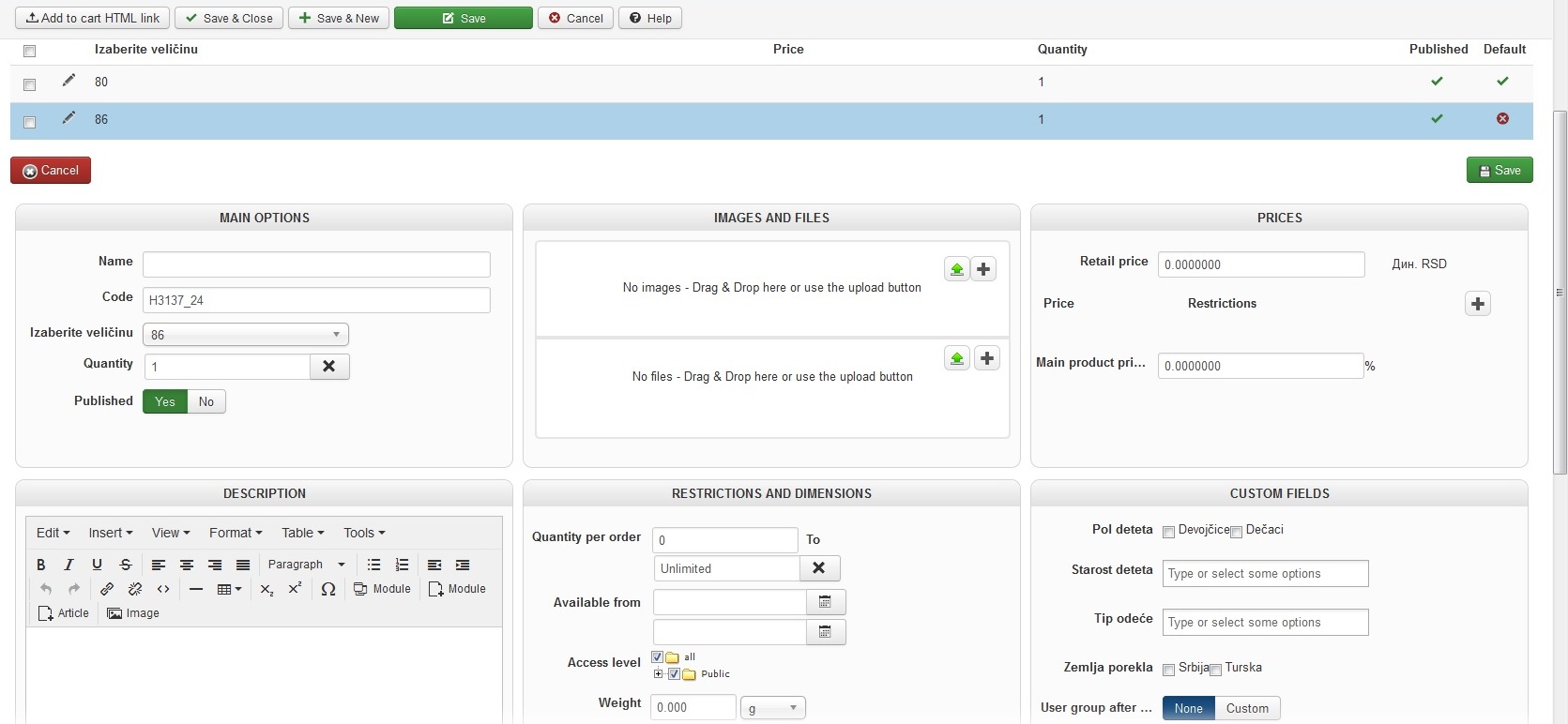

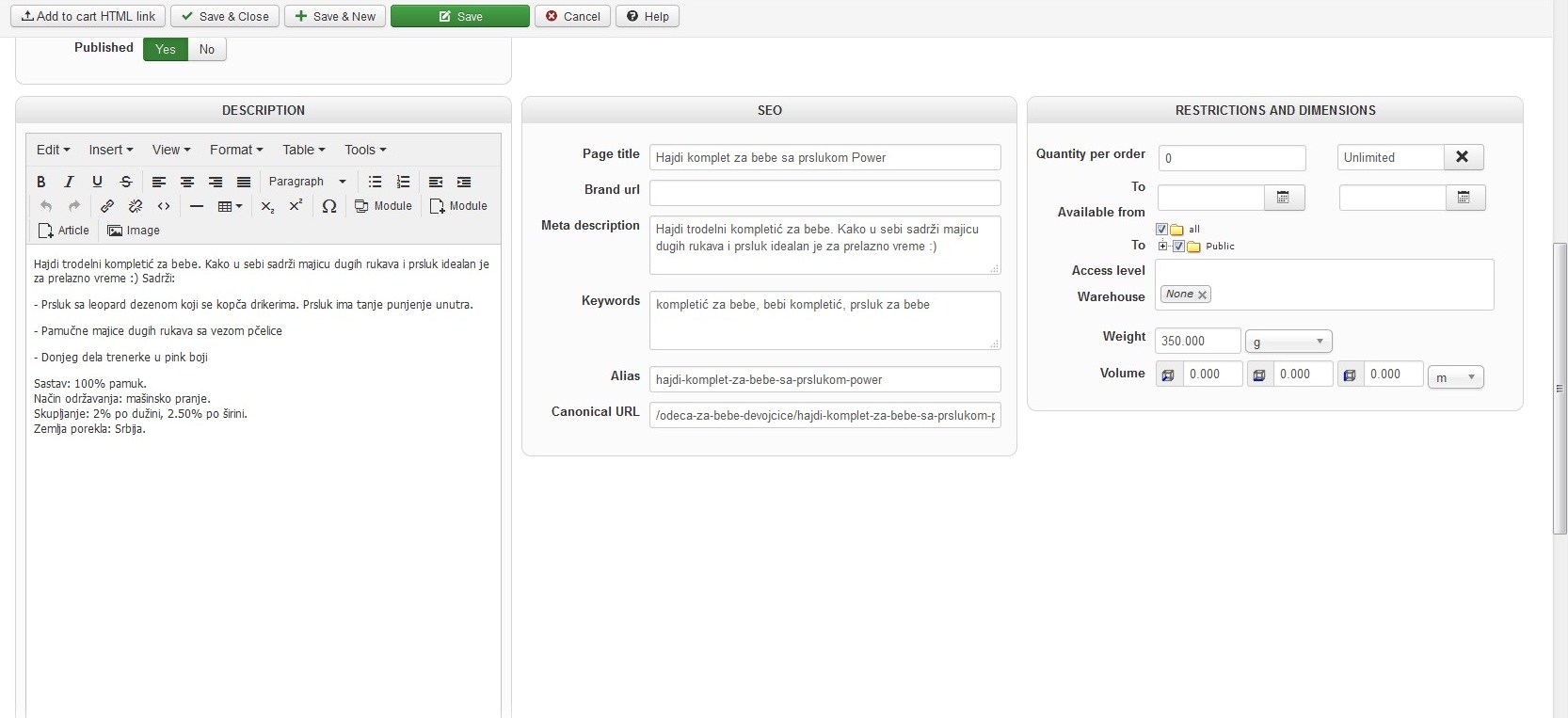

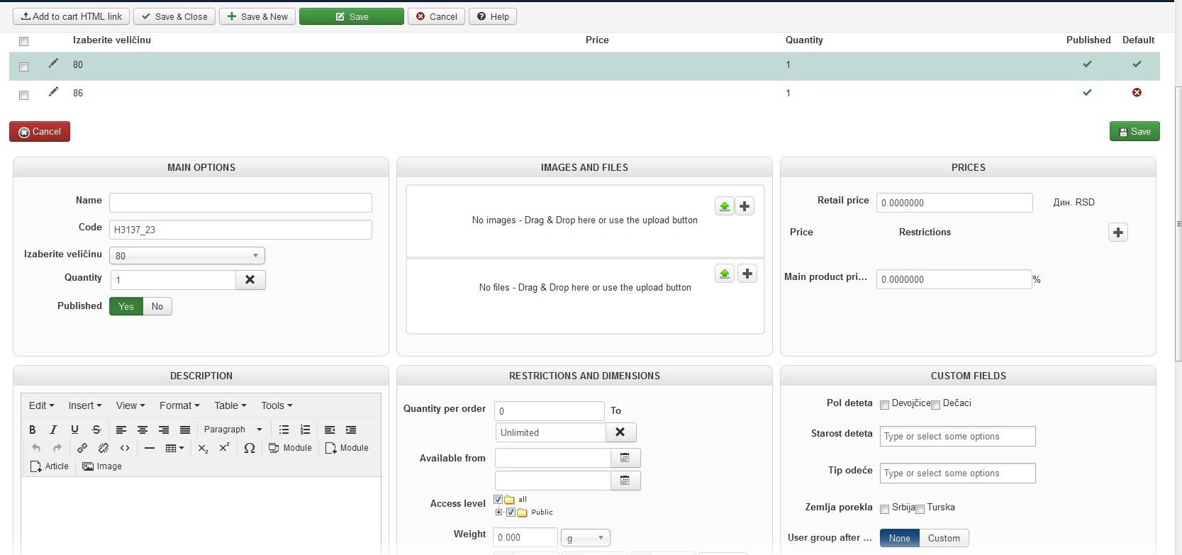

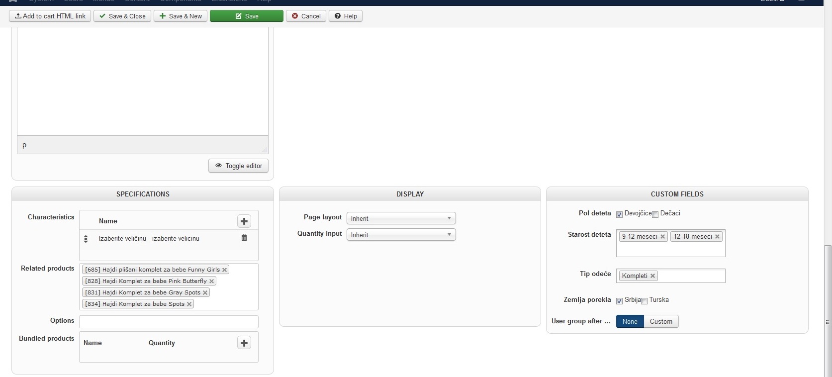

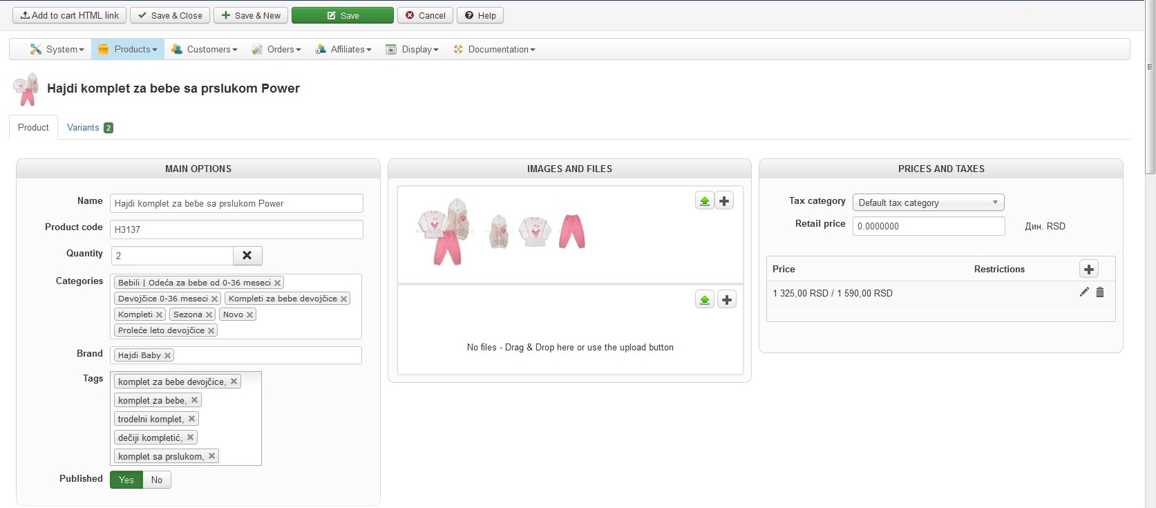

  • Posts: 67
9 years 5 months ago #264691
Settings for variants:
