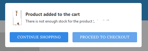

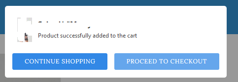

We are using cart notify plugin and its pop up feature. It looks and feels very well. However there is some not user friendly issue.
As example. We have product with quantity of 1. User add product to cart. Pop up is displayed with proceed to checkout button. All fine here.
If user add it again it will show that product has been removed from cart due no stock with same proceed to checkout button. If you press on proceed to checkout you will get redirected to URL you have entered here "URL where you will be redirected when the cart is empty" with empty message. So user must go back again to same product and so on...
With 3.0.0 version pop up would just be closed on pressing proceed to checkout but now we have redirect....
I think the best would be change proceed to checkout button to "close" and keep user in same page or completely remove it as you did with wishlist.
I hope you understand the issue.

  • Posts: 1119
  • Thank you received: 114
9 years 2 months ago #264702
Sorry i should write more clearly next time.
To reproduce the issue please:
1.Creat product with 1 item in stock
2. Use cart notify plugin and set it to use popup.
3. Add that product to the cart and you will get popup like my screenshot attached "popup1"
4. Add same product again and you will get again popup like in my second screenshot "popup2" (but this time Product is removed because you can't add more then you have in stock.) If you press proceed to checkout you will be redirected to the url you have specified in ""URL where you will be redirected when the cart is empty" settings.
So "proceed to checkout" button shouldn't be there because you have empty cart and product was removed.
I hope you understand what i mean.
You also can try to add this product as example: goo.gl/um0DS6
Thank you
Last edit: 9 years 2 months ago by kyratn.
  • Posts: 85712
  • Thank you received: 14050
9 years 2 months ago #264737
Thanks. That's much more clear.
I've added a patch which fixes the problem.
Please try again.
The following user(s) said Thank You: kyratn

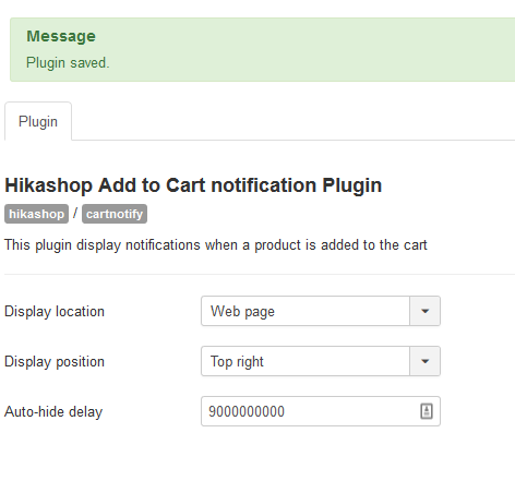

  • Posts: 21
7 years 11 months ago #294738
I have enabled the "Hikashop 3 Cart Notify Popup" however it appears for a very short time. So short that a user cannot click on any of the options.
I have increased the "Auto Hide Delay" to a very high value (9000000000) however this does not affect the time that the popup displays.
Any advice welcome!
Screenshot of settings is attached.
Adrian
  • Posts: 85712
7 years 11 months ago #294745
Maybe the value is too big. Please try to increase it to a smaller value. Like 99999. That's already a lot of seconds :)
If that still doesn't help, then please make sure that you've cleared all the caching on your website.
  • Posts: 21
7 years 11 months ago #294789
I changed the value to 99999 as suggested, then cleared the Joomla cache as well as browser cache, tried other browsers but still the popup disappears very quickly.
  • Posts: 85712
7 years 11 months ago #294807
Can you provide a link to the page so that we can have a look ?
  • Posts: 21
7 years 11 months ago #294843
Hi Nicolas
The site where we have the quick popup happening is : arhsvic.org.au/
Thanks,
Adrian
  • Posts: 85712
7 years 11 months ago #294860
You're using the legacy add to cart system, not the new add to cart system.
In that case, the cart notify plugin is not being used as it can only work with the new add to cart system.
With the legacy add to cart, you have an option under the "advanced" tab of the HikaShop configuration to configure the delay of the popup. At the same place, you can also find the "add to cart legacy" setting that you can deactivate in order to switch to the new add to cart system. Note however, that your cart module (which isn't the default cart module of HikaShop) might not be compatible with it.
