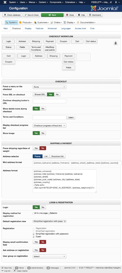

Thank you for your response. I already try default hikashop templatr, alredy try another joomla template, same result. No any zone (shippin or tax) use Default currency. I atached screenshot from checkout setting. To reproduce problem, please go to fidelecollagen.com/en/buy/fidele-month-treatment.html , switch from EUR to USD, press BUY product, login, enter adress, press NEXT, and you see, nothing happend, can not pass to the next step. If you change currency back to EUR, you can pass.

What if you switch the shipping and payment views in your checkout workflow ? Are you still stopped when clicking on next on the address view ?
To me it sounds that the problem is not with the shipping view but with the address selection.
And you didn't had any error message with the default template when you tried ?
I guess we'll need a backend access in order to check your settings in order to understand what's going on.
You can send that along with a link to this thread via our contact form:
