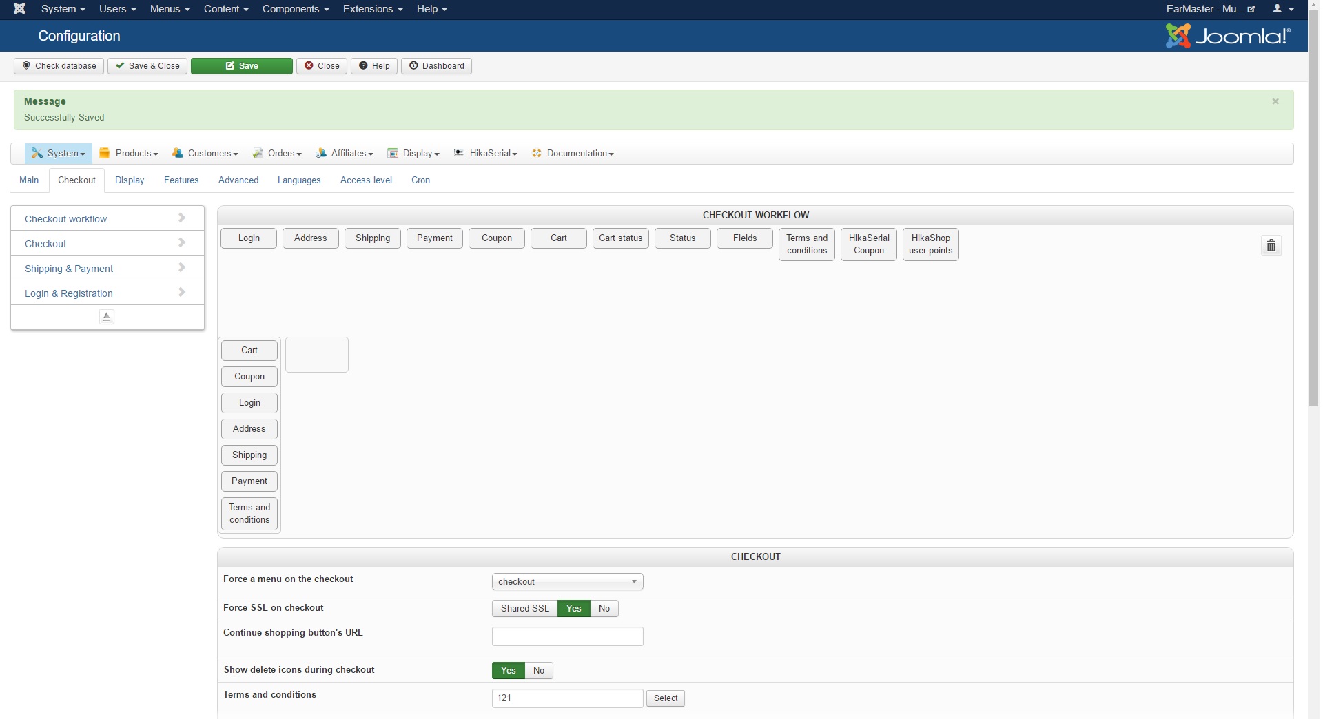

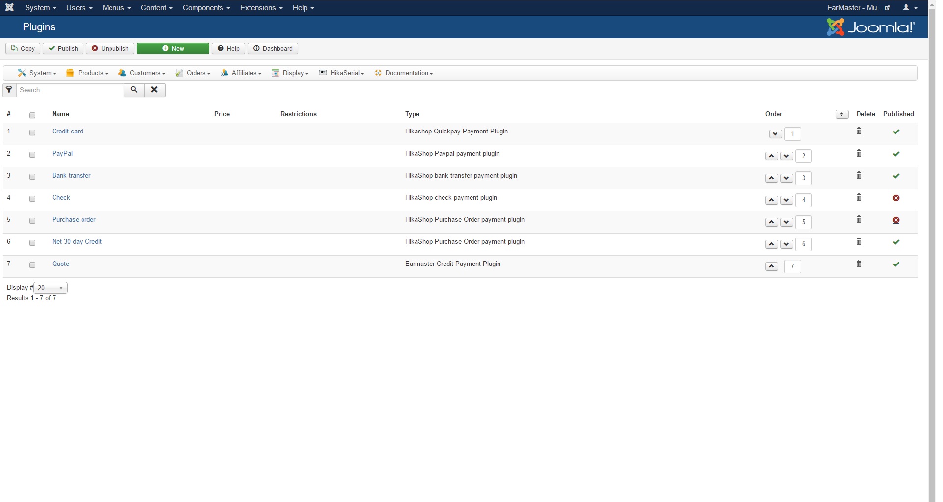

9 years 4 months ago #266573
We'll need more information through some screenshots about your issue but also about how you configured your :
- "Checkout workflow" via "Hikashop->System->Configuration->Checkout"
- Payment methods
  • Posts: 135
9 years 4 months ago #266741
Hi!
Here's the screenshots of the checkout workflow and payment methods.

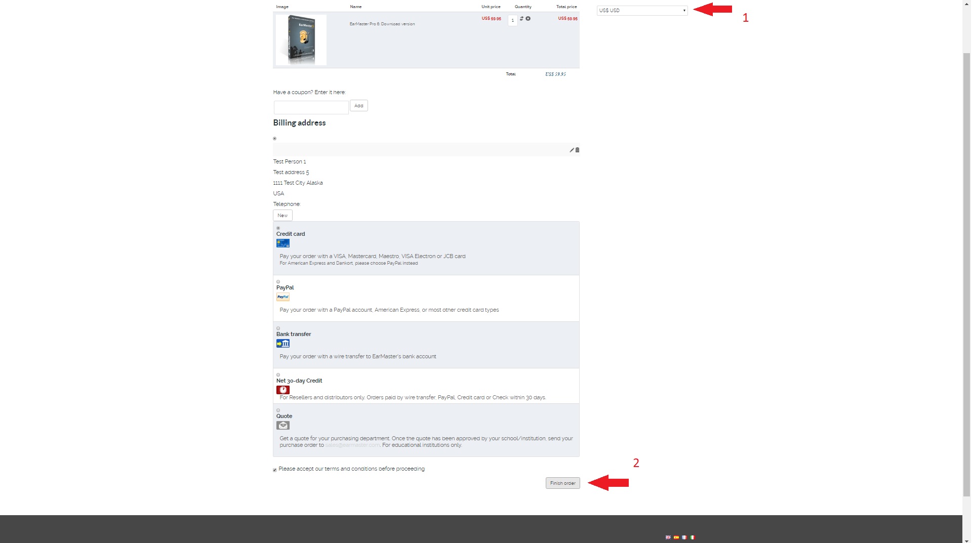

And here's the issue:
The URL of the checkout when you first get to the checkout page is: www.example.com/shop/checkout/checkout.html
As shown by arrow 1 the currency is set to USD for this order (the "Main currency" is stil set to EUR).
And when the button (shown with Arrow 2), is clicked the page is refreshed looking exactly like the picture above, the only thing that has changed is the URL which is now www.example.com/shop/checkout/checkout/task-show/cid-1.html
But nothing further changes and one can't complete the order still.
This issue is still there if we change the "Main currency" to USD and try to order in EURO.
Last edit: 9 years 4 months ago by earmaster.
  • Posts: 86028
  • Thank you received: 14172
9 years 4 months ago #266744
That's a bug we fixed 2 weeks ago:
www.hikashop.com/forum/checkout/889419-o...-changed.html#265504
Download the install package on our website and install it on yours and that will add the patch for the problem.
