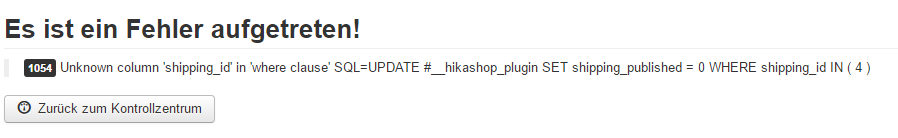

when I tried to disable a entry I have made with HikaShop Closing Hours Plug-IN I get the error message
1054 Unknown column 'shipping_id' in 'where clause' SQL=UPDATE #__hikashop_plugin SET shipping_published = 0 WHERE shipping_id IN ( 9 )
You can see in attached pic.

  • Posts: 31
9 years 3 months ago #267328
1054 Unknown column 'shipping_id' in 'where clause' SQL=UPDATE ww3b8_hikashop_plugin SET shipping_published = 0 WHERE shipping_id IN ( 5 )

Will send you the Login through your contact form.
  • Posts: 26380
9 years 3 months ago #267338
Please edit the file "administrator/components/com_hikashop/controllers/plugins.php" and replace the function _getToggle with that content
	function _getToggle() {
		$this->type = JRequest::getCmd('plugin_type');
		if($this->type == 'plugin') {
			$this->toggle = array('plugin_published' => 'plugin_id');
		} else if($this->type == 'payment') {
			$this->toggle = array('payment_published' => 'payment_id');
		} else {
			$this->toggle = array('shipping_published' => 'shipping_id');
I think it will fix your issue.
But we will need your confirmation in order to integrate the patch in HikaShop.
  • Posts: 31
9 years 3 months ago #267366
Thx, this fixed it. Works fine.

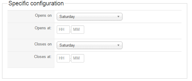

I noticed another thing. When I reopen an existing day, the hours field is blank. See attached a pic.
  • Posts: 86028
  • Thank you received: 14172
9 years 3 months ago #267399
I'm not able to reproduce that, neither on my end, nor on your website:
monosnap.com/file/fZPtfjCrFGSCHuU0hQHmo6Co1zRoes
  • Posts: 31
9 years 3 months ago #267441
HI,
I see, interessting. I have a copy of that site offline for development. There I experience this issue. Any idea what it could be?
  • Posts: 26380
9 years 3 months ago #267480
You can activate the Joomla debug mode in your offline website ; it will allow you to see the SQL queries made for the page loading.
The plugin should load the configuration from the database and if you see the fields empty, it means that there is an issue with the loading of the data.
But because we are not able to reproduce, it will be difficult for us to give you more indication on where the problem would be.
