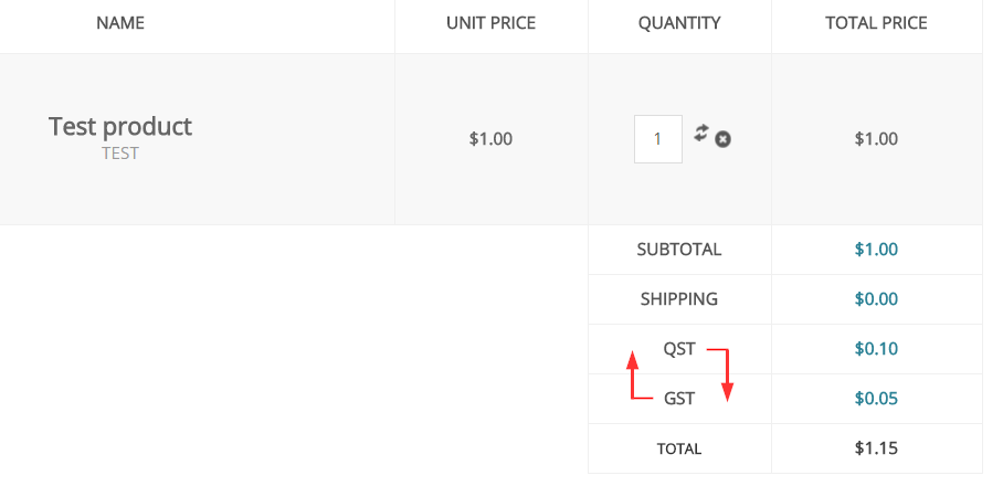

I am trying to find a way of changing the order in which taxes appear at checkout (see attached image). GST should be above QST. I tried to update _hikashop_taxation table's taxation_ordering field, which had no effect. Then I switched Joomla into debug mode and found the only query accessing this table that orders results by taxation_id field. So, I updated this field manually via phpMyAdmin, but that did not make difference either.
Is there any way to solve this?

It's just that no one had asked about that so far and no one noticed on our end.
I've just added a patch to handle the ordering.
Please download again the install package on our website and install it on yours and that should take into account the taxation_ordering of your tax rules.

Thanks Nicolas! Yes, the new code fixes the ordering issue. Now the order follows taxation_id number, so the taxes appear in the same order they were created in the back-end. Not being able to change the order after defining taxes is a bit inconvenient, but it is OK, since you just need to set them up only once.
