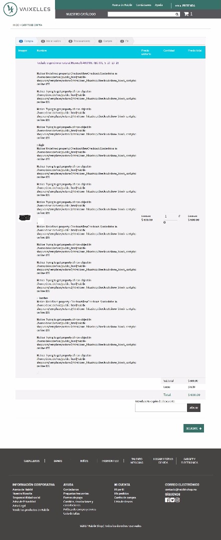

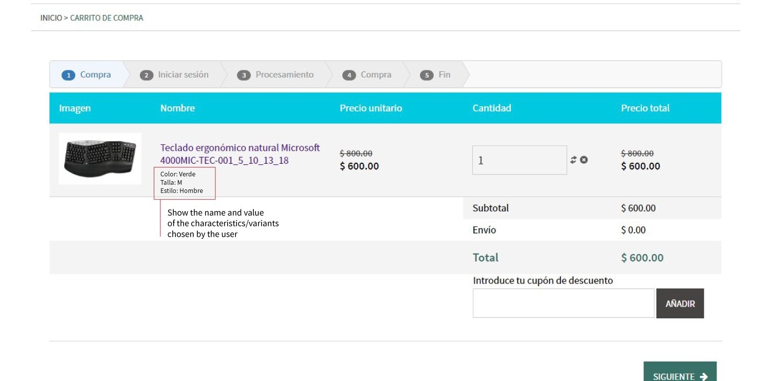

I'm adding a screenshot of what I'm trying to do. Basically each product in the cart table of the checkout page has to show details of the characteristics/variants chosen by the user in a list format or something similar.

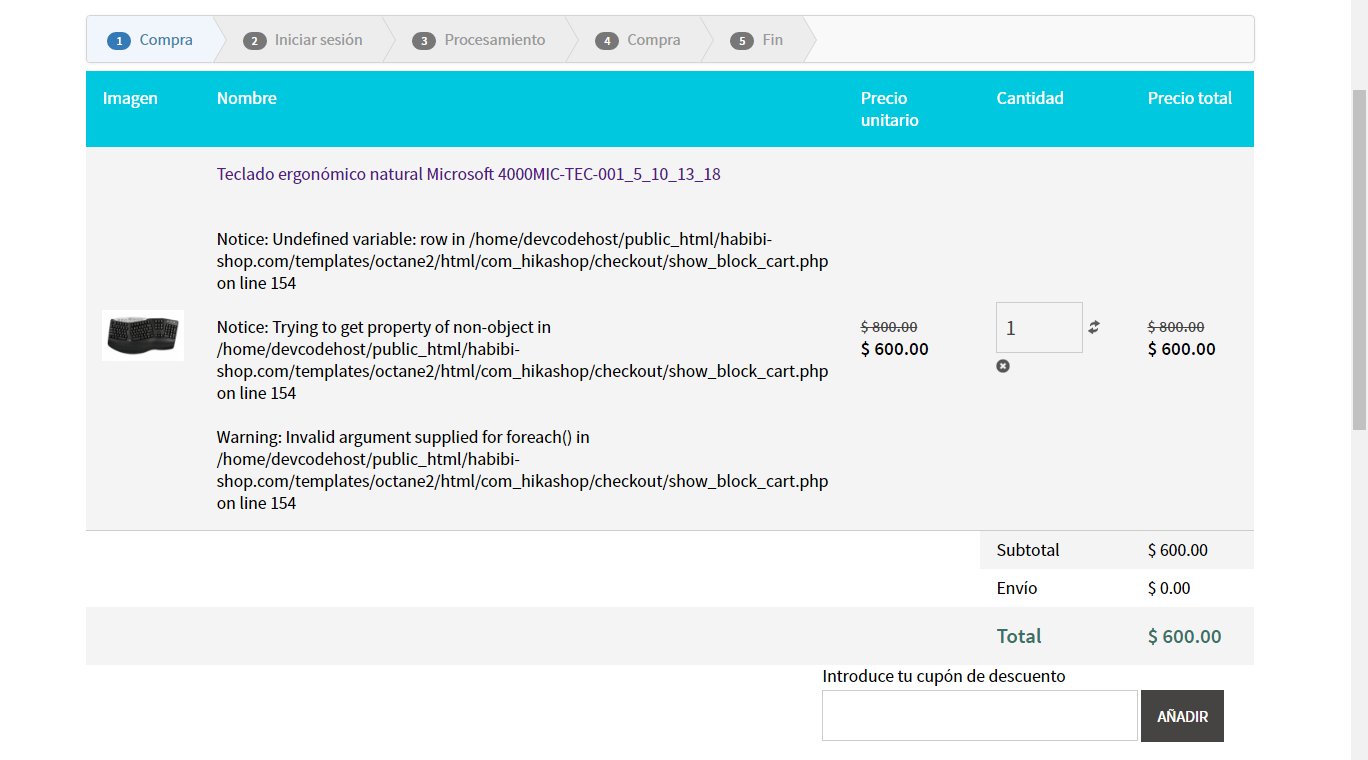

i tried to use the following code suggested by thewebtailors in the checkout / show_block_cart.php view
<?php foreach($row->characteristics as $characteristic){
echo "<br /><span class='characteristic'>".$this->orderInfos->products[$i-1]->characteristics[$characteristic->characteristic_parent_id]->characteristic_value.": ".$characteristic->characteristic_value."</span>";
But after reloading the page the following message appears:
However if I change this line:

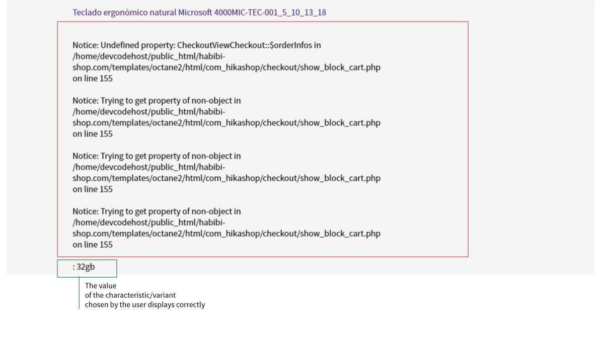

to
foreach($product->characteristics as $characteristic)
The values of the characteristic appears but not their name, instead I get this message.
This message repeats itself depending of the number of variants of a product. So the full page looks like this:

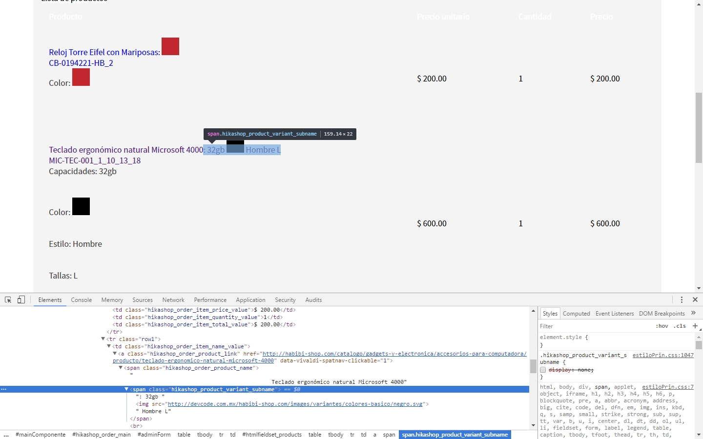

I have another question. How can I remove the contents inside "hikashop_product_variant_subname"?
  • Posts: 86028
  • Thank you received: 14172
9 years 3 months ago #268517
What I usually recommend is to leave it there and just add some CSS to the page with a display:none on that class name so that the span is not displayed.

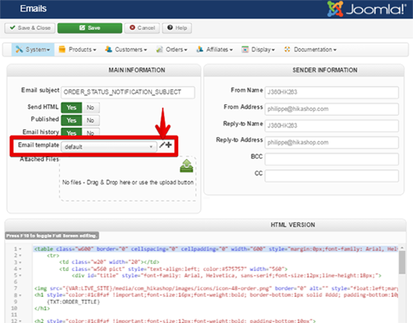

In order to add some Css in your Email you can process like this, follow me step by step :
1°) Go to Components => HikaShop => Configuration, then in System dropdown select Emails to see Emails type listing.
Then select your required Emails to edit it.
2°) If I follow you, you want remove this element :
<span class="hikashop_product_variant_subname">
</span>
So, click on the little pen icon close to Email template :
You will see a popup window that display your email Css, you have just to add this kind of Css code :
Span_class_name {
   display: none;
Hope this will help you.
