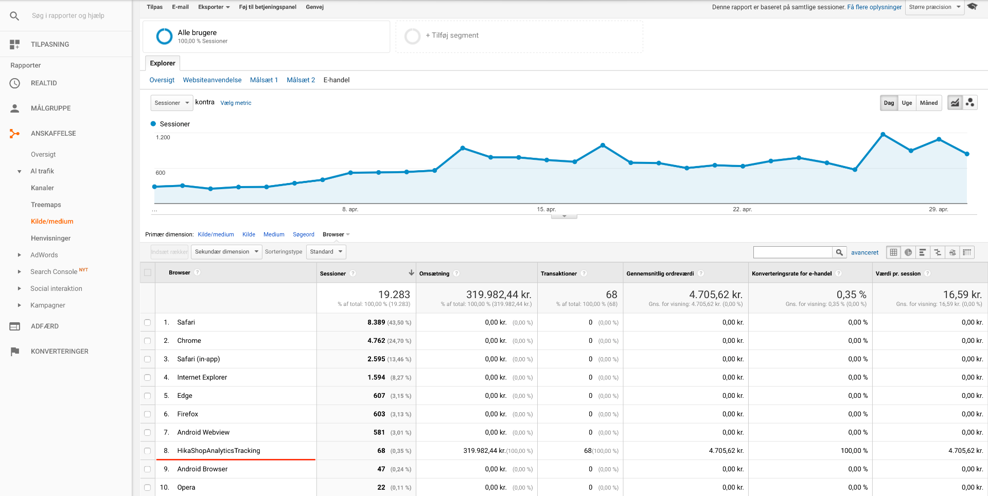

After some more testing, and realtime tracking in Google Analytics, I can follow a user from e.g. Facebook, all the way through the checkout and to the thank you page, while keeping the referral. So the issue is not missing tracking, or a broken session during checkout.
Then I started looking into the data from Google Analytics. There I found that all the conversions had HikaShopAnalyticsTracking as browser. So it seems that "something" is broken in what Hikashop Google Analytics Plugin is reporting back to Google Analytics?

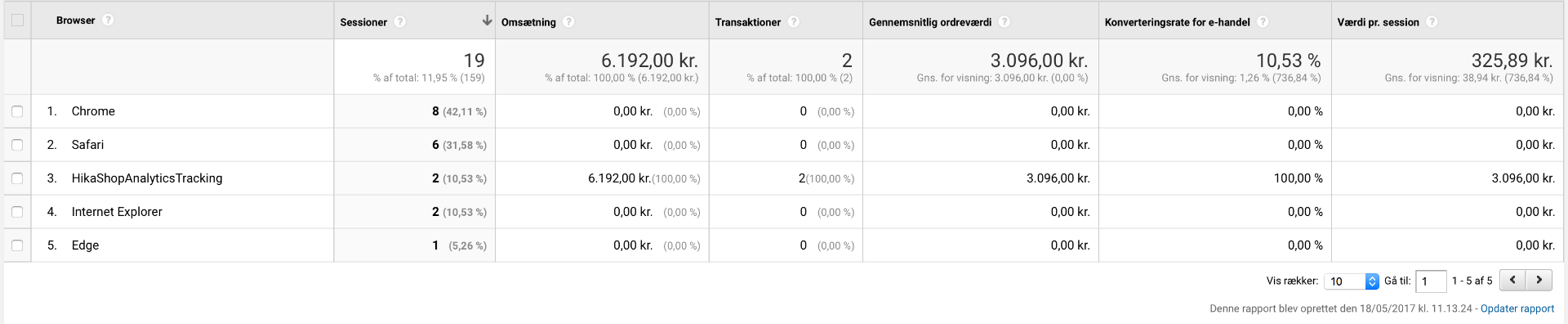

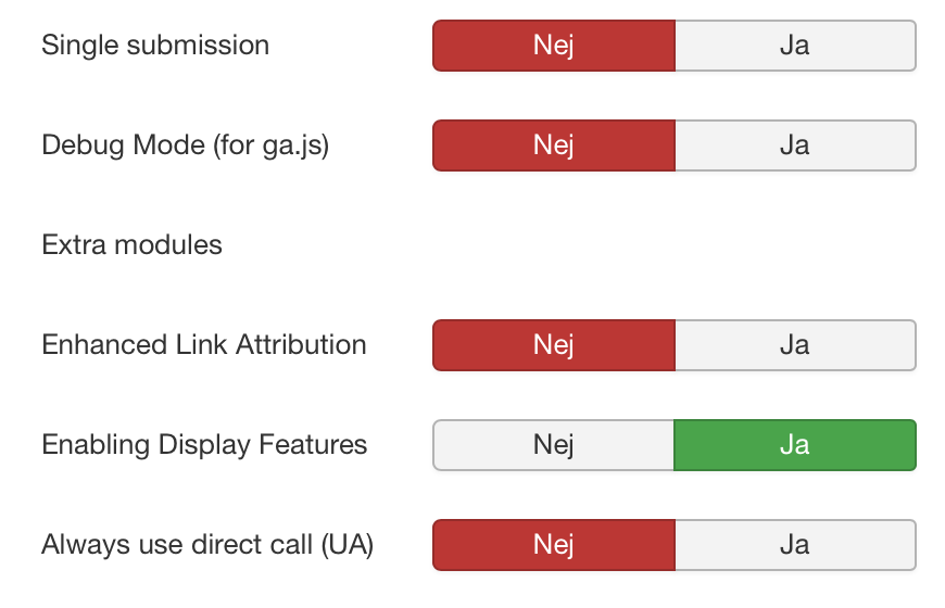

  • Posts: 88
  • Thank you received: 20
9 years 2 months ago #269761
I actually changed that (set direct call to no) 2 days ago, and checked today. Still, all conversion are from HikaShopAnalyticsTracking browser. Please see attached. The screenshot from Google Analytics is for conversion from today, so not old data here.
Also, I'm failing to see the ecommerce javascript after I set direct call to no - at hvad page should it be added? I would expect it at the thank you page?
