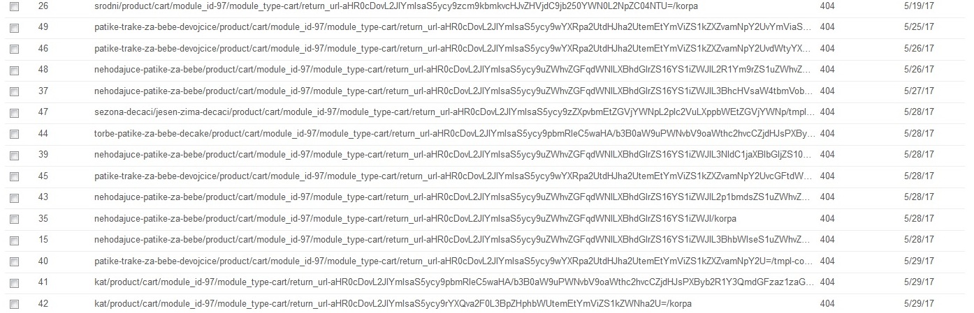

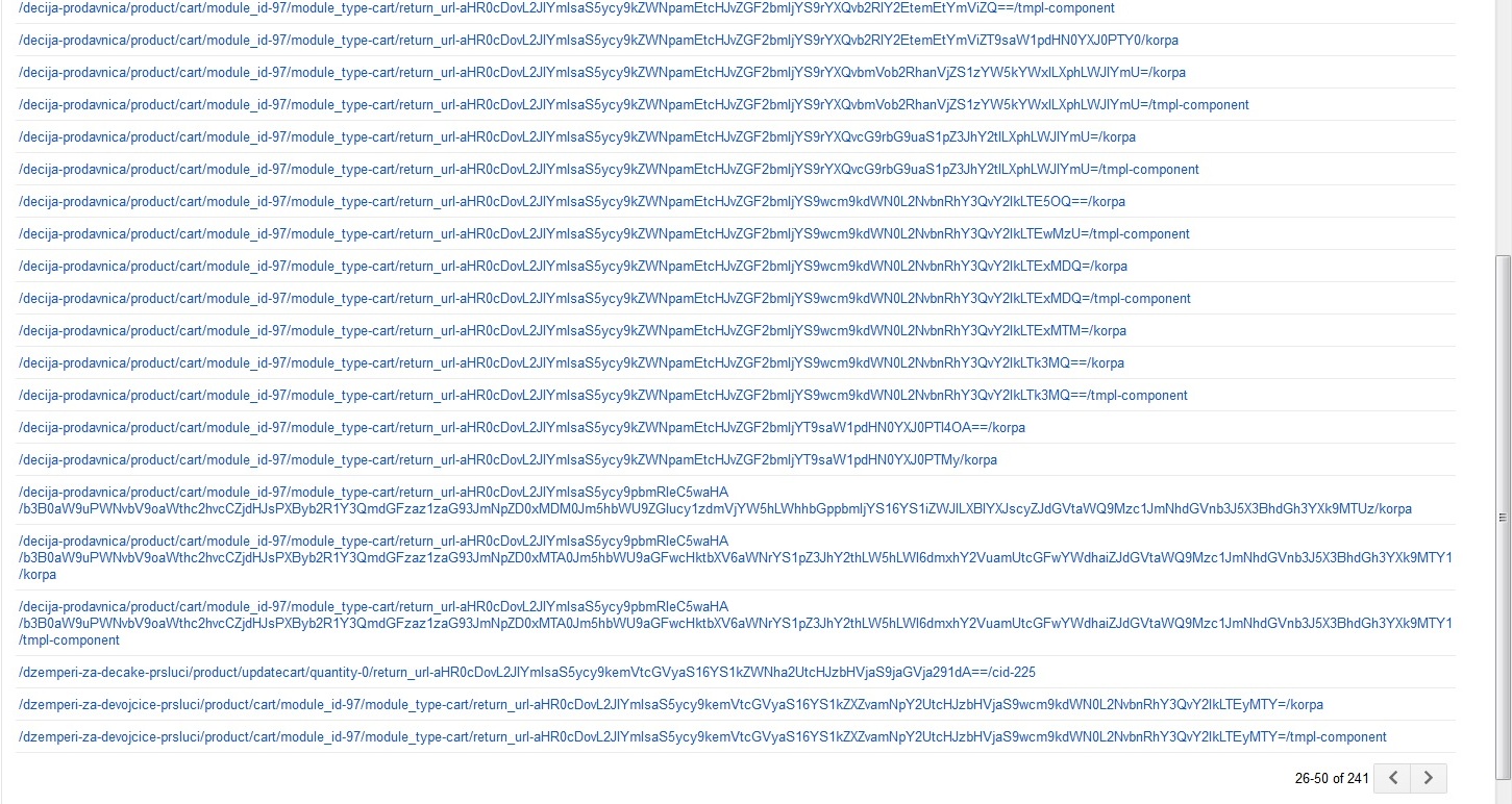

We've noticed that we're probably having penality from Google. Our rating is rapidly dropping last couple of weeks, so we're trying to figure out the problem.
We've checked out Google webmaster, and it's saying that we have 241 pages without titles, and we also have pages with similar issue with 404 error.
In attachment we provided screenshot. We are checking webmaster regulary and we didn't have these errors before, so we are not sure what can cause it.
We are not aware if customers are having any problem with orders, noone complained, but this error can have impact on SEO.
Do you have any ideas what can cause it and how can we solve it?

I've added code in /components/com_hikashop/views/product/tmpl/cart.php but we still have same amount of missing titles and still getting few 404 cart return errors.
This is for example one of the links with missing title:
bebili.rs/bade-mantili-za-bebe/product/c...heT0=/tmpl-component
And this is one of 404 errors:
www.bebili.rs/kat/product/cart/module_id...1kZXZvamNpY2U=/korpa
This 404 error is fresh one.

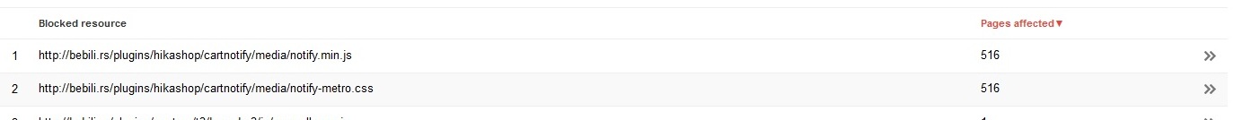

Also we have one more question about blocked resourses. We have 500+ affected pages connected with hikashop. You can check screenshot in attachment. Can you help with it?
  • Posts: 85721
  • Thank you received: 14051
8 years 11 months ago #272854
I don't see the "X-Robots-Tag: noindex" header added to the header of the response on your website:
monosnap.com/file/orb0KZLww8rmNtQQMD9BBuPQvUOeHC
See a similar URL on my end: monosnap.com/file/0Lc8KPW9bciDc026kTvB3sR4ETsiNC
So download the install package of HikaShop 3.1.1 on our website and install it on yours. We've added a more complete patch and it will help here and for other things.
The blocked resources is because they are blocked in the robots.txt file.
So you could modify it to allow them to be reachable by search engines.
But well, it doesn't matter much. That javascript/CSS is only for the popup notification. That means that the search engines won't get the notifications when using the add to cart links, which it shouldn't index in the first place. So it's not really a problem.

We still got bunch of links with missing titles and every of them are same when you click on it. It point to cart.png icon?
Example: bebili.rs/bebe-decaci/product/cart/modul...2NA==/tmpl-component
We using Hikashop for over 1 year, and didn't have these problems before. It started somewhere with upgrade to 3.0.0.
We really need a help with this, cos rating dropping everyday :(

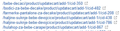

We have one more question, we think one more part shouldn't be indexed.
Can You check screenshots?
example url that we don't want to get indexed is - bebili.rs/odeca-za-bebe-devojcice/produc...1/cid-1226?tmpl=ajax
Can You tell us the path to file in which we should put noindex?
Thanks in advance.
  • Posts: 26355
  • Thank you received: 4068
8 years 10 months ago #274919
There is already a patch in HikaShop product controller for "updatecart" to add the noindex header.
But that patch is not in the current release.
	public function updatecart() {
		hikashop_nocache();
		if(!headers_sent())
			header('X-Robots-Tag: noindex');
