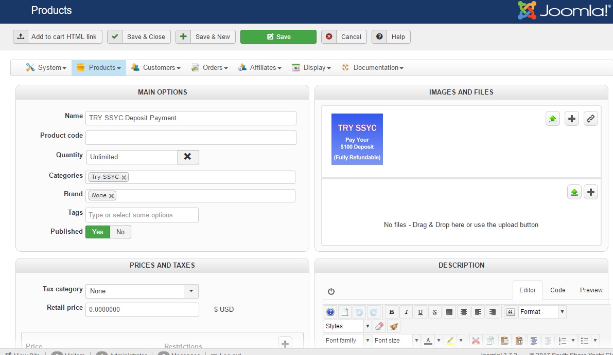

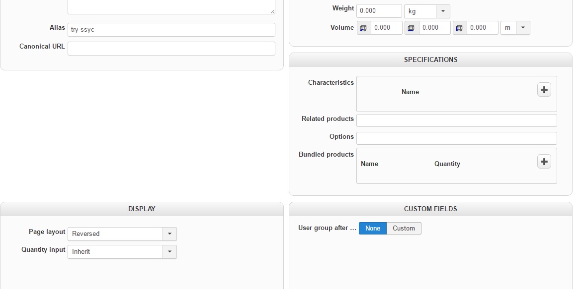

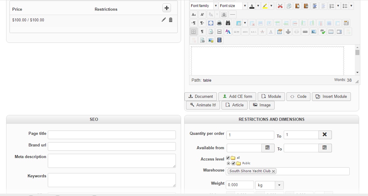

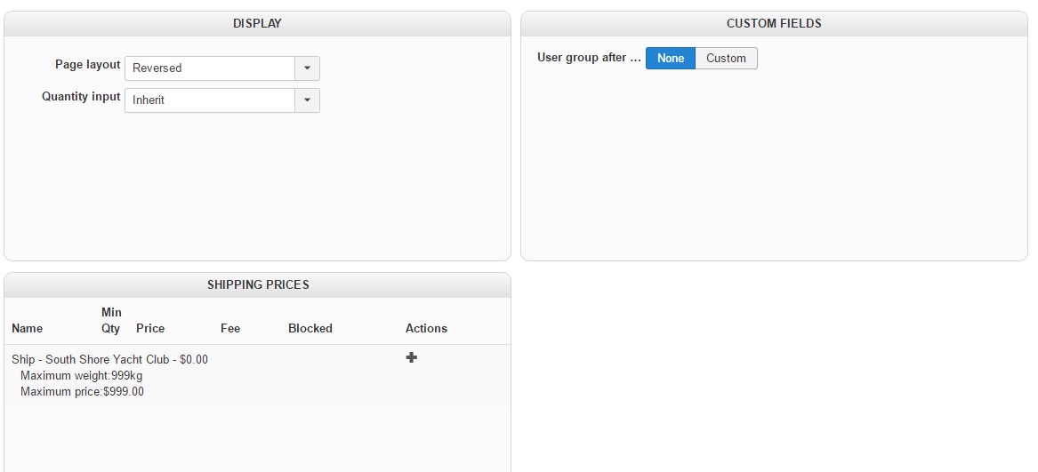

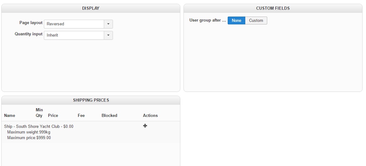

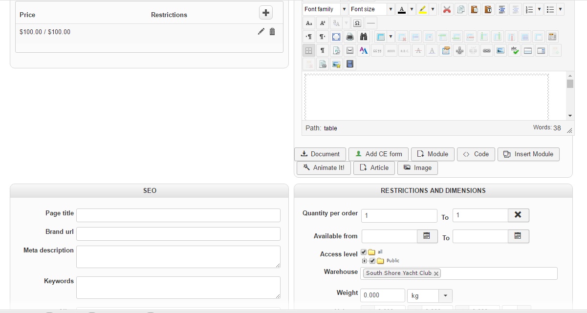

  • Posts: 3
8 years 11 months ago #272410
The payment process can be accessed via:
www.ssyc.org/try-ssyc-checkout
The product definition is attached as four screen-shot jpg files.
I am happy to grant you temporary super use access, just send me an e-mail and I'll provide the credentials.
Dave
8 years 11 months ago #272413
Can you try to add a product code in your product configuration page and process another test in order to see if that work ?
It's seems that authorize.net expecting a specific item format that must start with a product code, and here this code is missing.
Awaiting news from you.
Last edit: 8 years 11 months ago by Philip.
  • Posts: 3
8 years 11 months ago #272449
That looks like it might have solved the problem.
Thanks,
Dave
