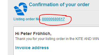

... and the link in the order confirmation email points to the homepage, not to the order.

Regarding the link which doesn't work, this link has been added as a customization of the HTML version on your end with such custom code:
  <?php
	echo sprintf(JText::_('ORDER_CREATION_SUCCESS_ON_WEBSITE_AT_DATE'), $data->order_number);
	echo ' <a href="https://kite-and-windsurfing-guide.com'.$data->order_url.'">'.JText::_('HIKASHOP_ORDERSUMMARYONLINE').'</a>'.PHP_EOL;
So that has to be fixed on your end. I would recommend to use instead the variable $data->order->order_url which already contains the full link to access the order.
