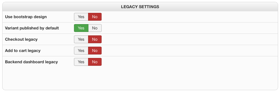

For testing I have made a clean Joomla install, installed only Hikashop and used the Protostar template. Attached is an image of the legacy settings.

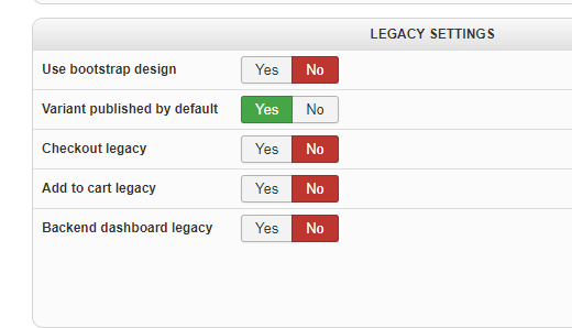

Attached my configuration legacy
