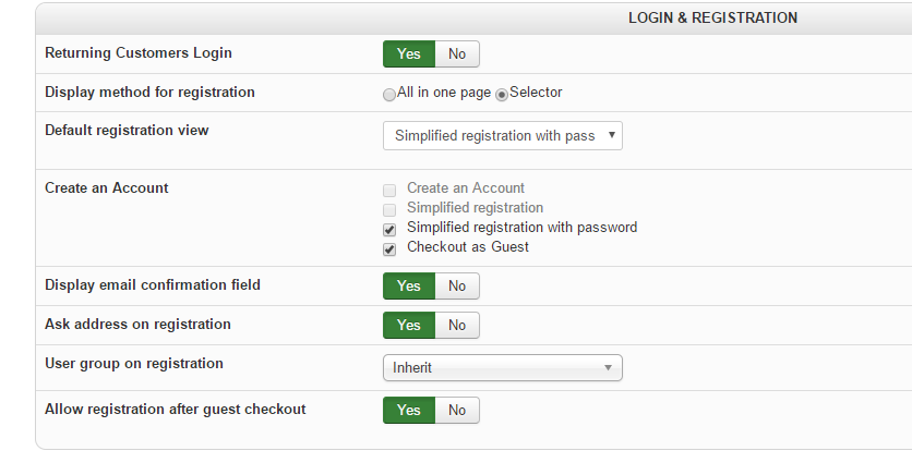

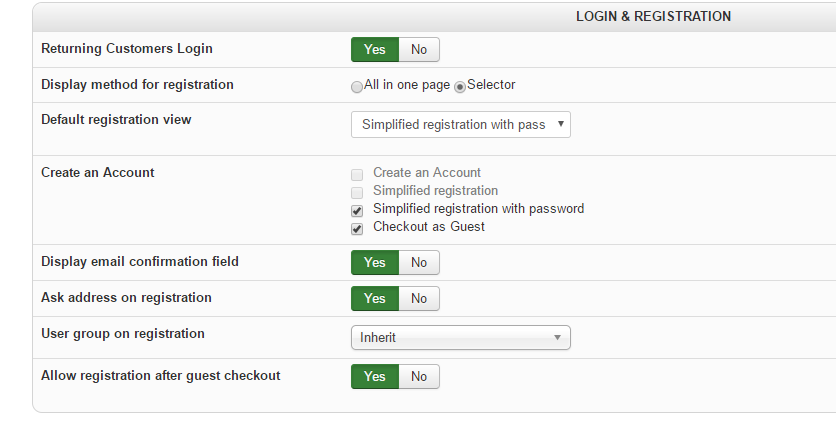

Hi, I am on the most recent version of the cart with the new checkout and the "default registration view" selection does not work when "simplified with password" is chosen for the default value. This has to be a bug. It just defaults back to the login form instead. Attached is a combination of my settings.
I deleted all extra layout overrides out of the checkouts folder and this is still happens so there has to be some sort of bug. Also, I see no javascript errors and all other default registration view selections work, just not the combination I have. Please let me know what the fix is to this.

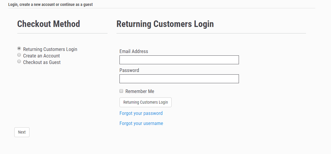

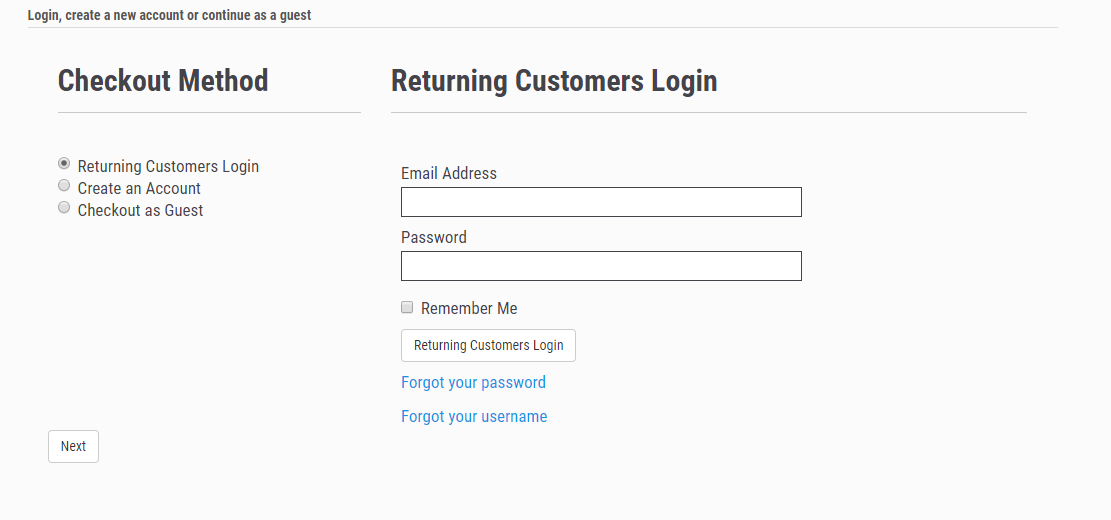

Also, here is a screen shot of what the checkout is doing. It should be selecting "create an account" option by default because that is the "simplified registration with password" option. Instead it is defaulting to the "login" instead.
