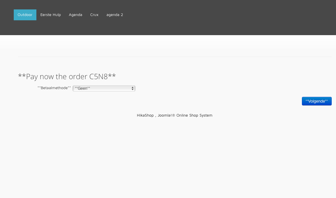

-- Joomla version -- : 3.7.2
-- PHP version -- : 7.0
-- Browser(s) name and version -- : Safari
I think that since updating Hikashop to 3.1.1 I "lost" the payment page.

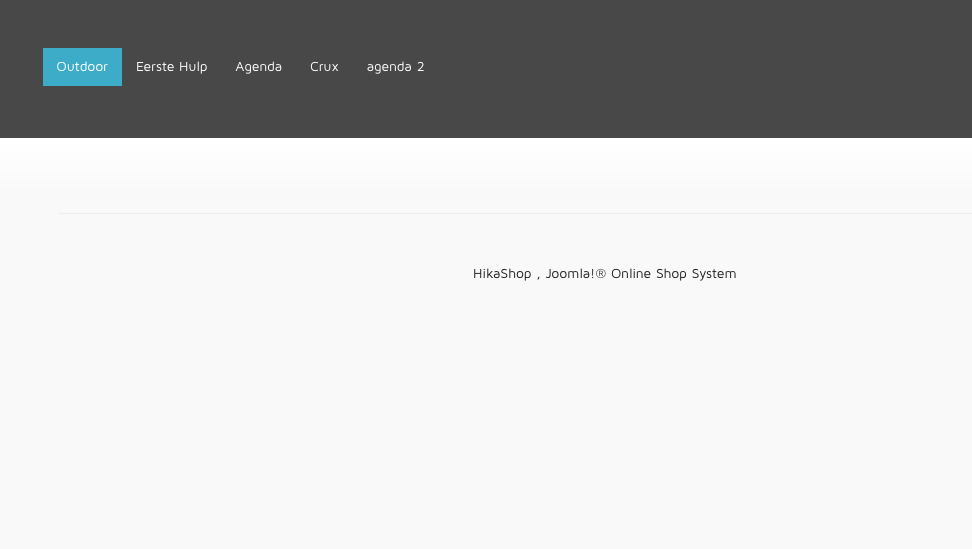

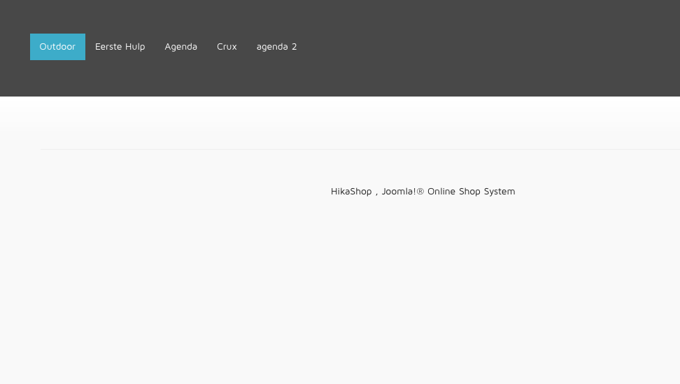

On our site, customers do a reservation without direct payment.
After changing te status to checked, I will sent them an email with a payment link (for instance this one ).
That link sends them to payment page where they can choose a payment type. After doing so, you just go to an empty page.
See the attachements.
This used to work properly.....
Can Someone help to find what is the problem?

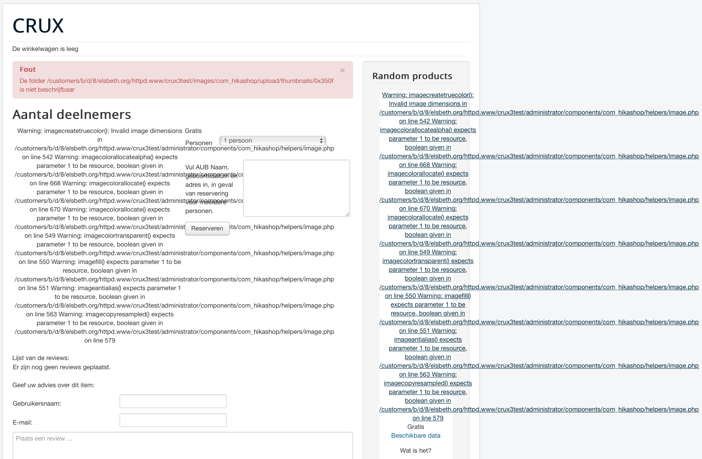

  • Posts: 92
8 years 11 months ago #273406

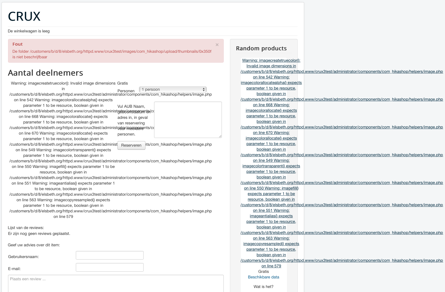

Wow, get all kinds of errors when I choose a joomla template. See attachments. They are Hikashop related. But more somethings about images, and not payment, I think.
How can I share some login with you?
As for instructions on what happens, you can use this link, it goes to the payment-page....
I have another topic where one of you explained how I could fix that.

  • Posts: 85721
  • Thank you received: 14051
8 years 11 months ago #273452

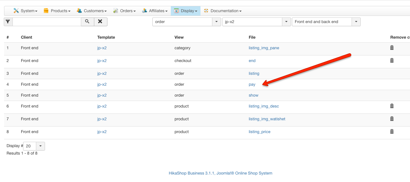

Ok, I think I understand the problem. It happens only with guest orders.
Add the code:
<input type="hidden" name="order_token" value="<?php echo JRequest::getVar('order_token'); ?>" />
after the line:
<input type="hidden" name="ctrl" value="<?php echo JRequest::getCmd('ctrl'); ?>" />
in the file "pay" of the view "order" via the menu Display>Views and that should then work properly.
Last edit: 8 years 11 months ago by nicolas. Reason: fixing typo

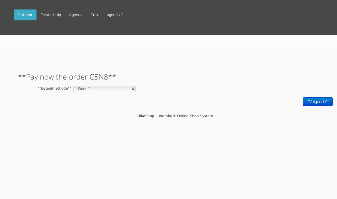

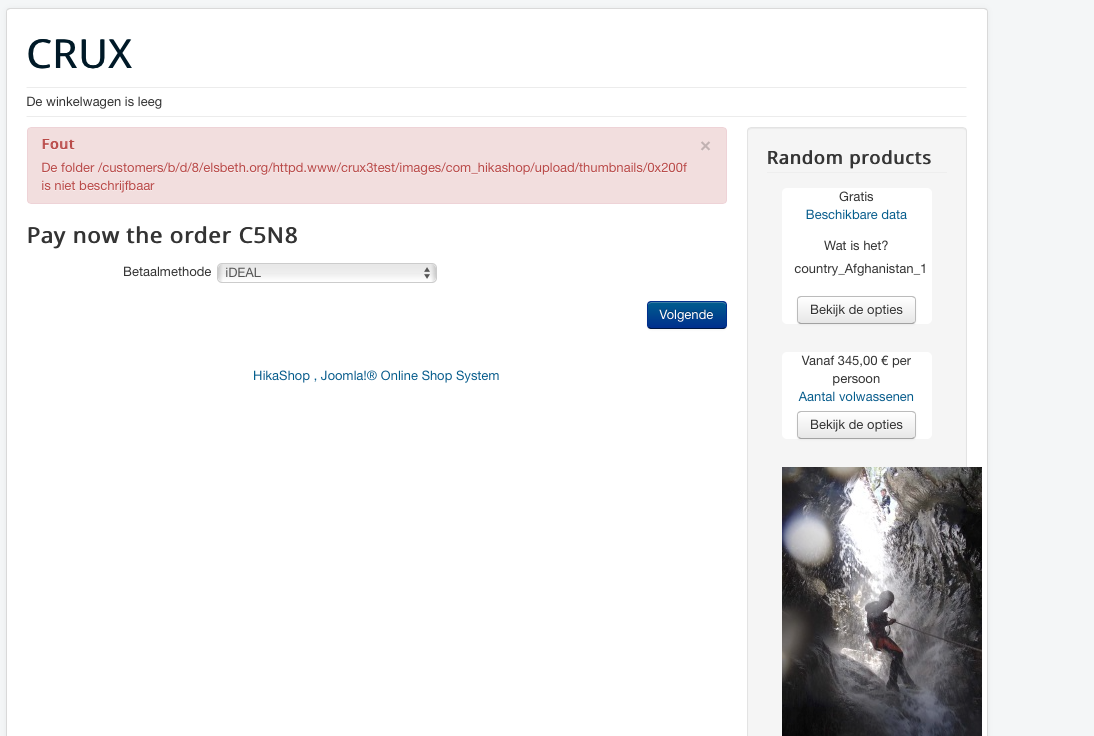

  • Posts: 92
8 years 10 months ago #273783
I thought I could not find the line where I had to put the other line... But I guess I was sleeping (or my computer, since it did not find the text.....). But it is there... :blush:
So I changed the file..... But now I am getting a fatal error... I think It is because my payment method is not configured properly. Am going to look into that.
Last edit: 8 years 10 months ago by ezomerdijk. Reason: I guess I was sleeping (or my computer, since it did not find the text.....). But it is there... :blush:

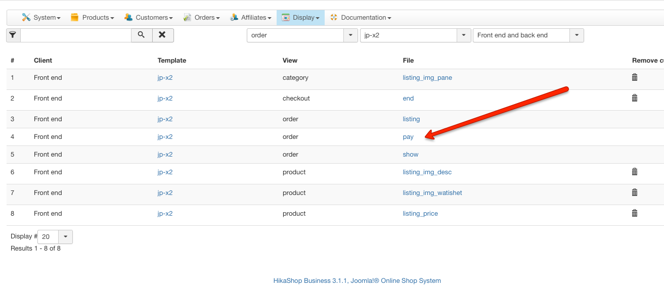

  • Posts: 26355
  • Thank you received: 4068
8 years 10 months ago #273844
The file you added as attachment does not have any modification.
I don't know what you have done but.. Please follow the Nicolas instructions which is to just add one line after another.
If you do it as explained, you won't have any fatal error.

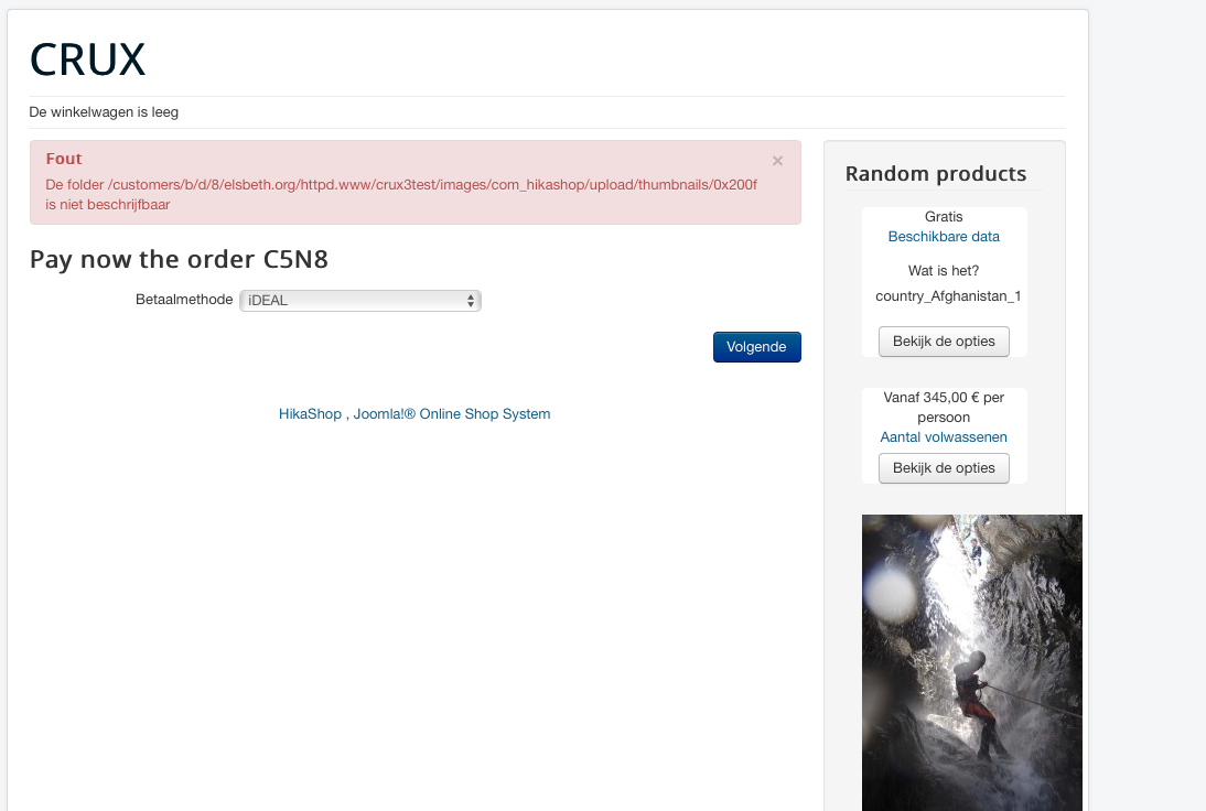

  • Posts: 92
8 years 10 months ago #273891
Hello, I see now that I wasn't clear.
I have added the line suggested. And the payment page is nog empty any more. 1 specific payment type (Ideal) is giving me a fatal error. I thing I didn't configure it right.
I need the "Hikashop iDEAL payment plugin", but I don't have that in my list of possible payment types. Did I somehow remove that? How can I install that again?
