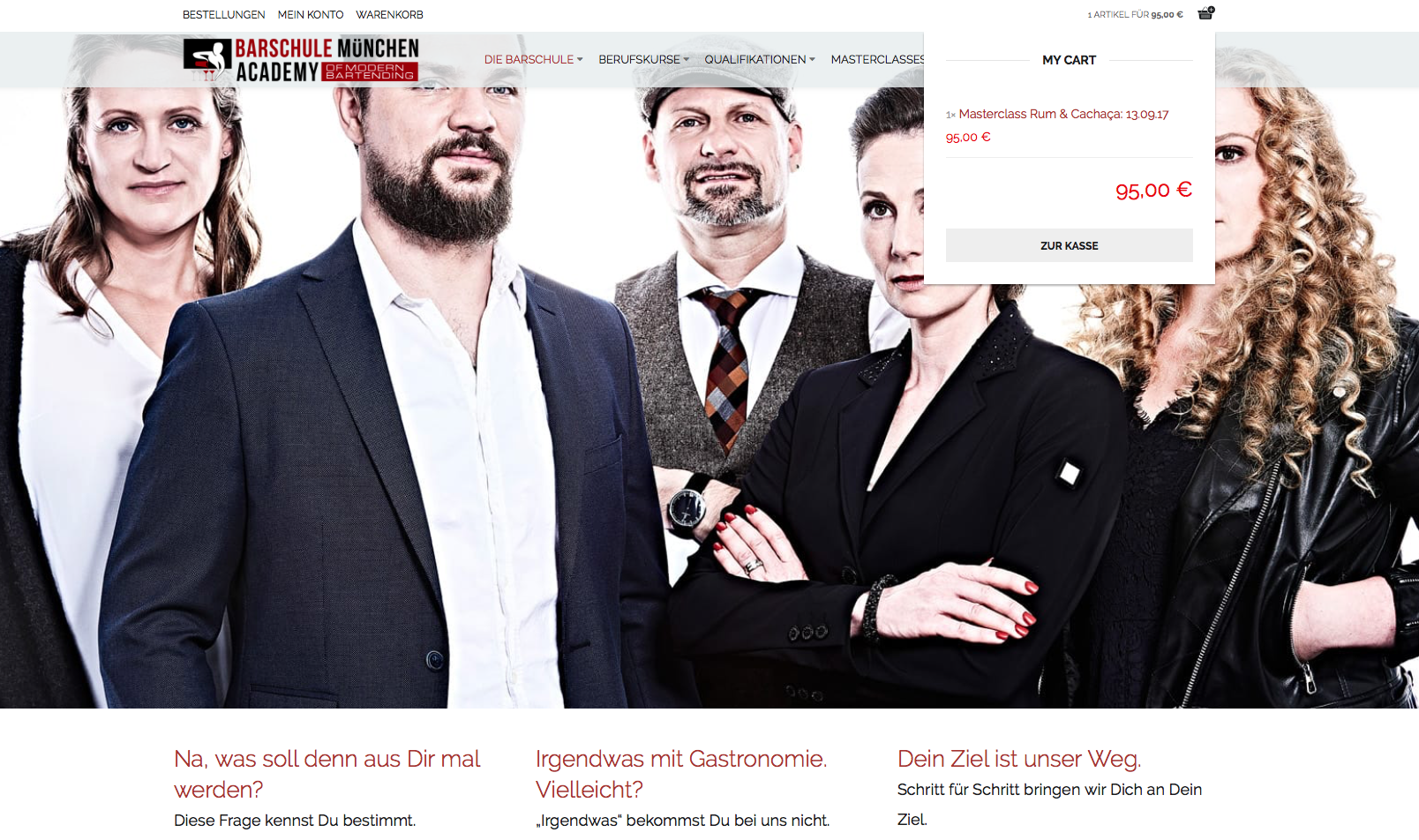

-- url of the page with the problem -- : www.barschule-muenchen.de
-- Joomla version -- : 3.7.3
-- PHP version -- : 7.0.19
-- Browser(s) name and version -- : All
After adding products to the cart, clicking on the mini cart shows a button "zur Kasse" which means "proceed to checkout". Pressing that button just reloads to current page instead of leading the user to the checkout process.

The issue is that the cart module on your website is not the default one we have in HikaShop. It seems to be a customized version of the cart module from HikaShop 2.x. That cart module isn't fully compatible with HikaShop3.x, especially that button.
So you'll have to contact the developer of that module (I suppose it is your template provider) so that they can update the code for that button.
If it is a HikaShop cart module that has been customized, you can also edit the file "cart" of the view "product" via the menu Display>Views and fix the code of the button near the end of the view file.
