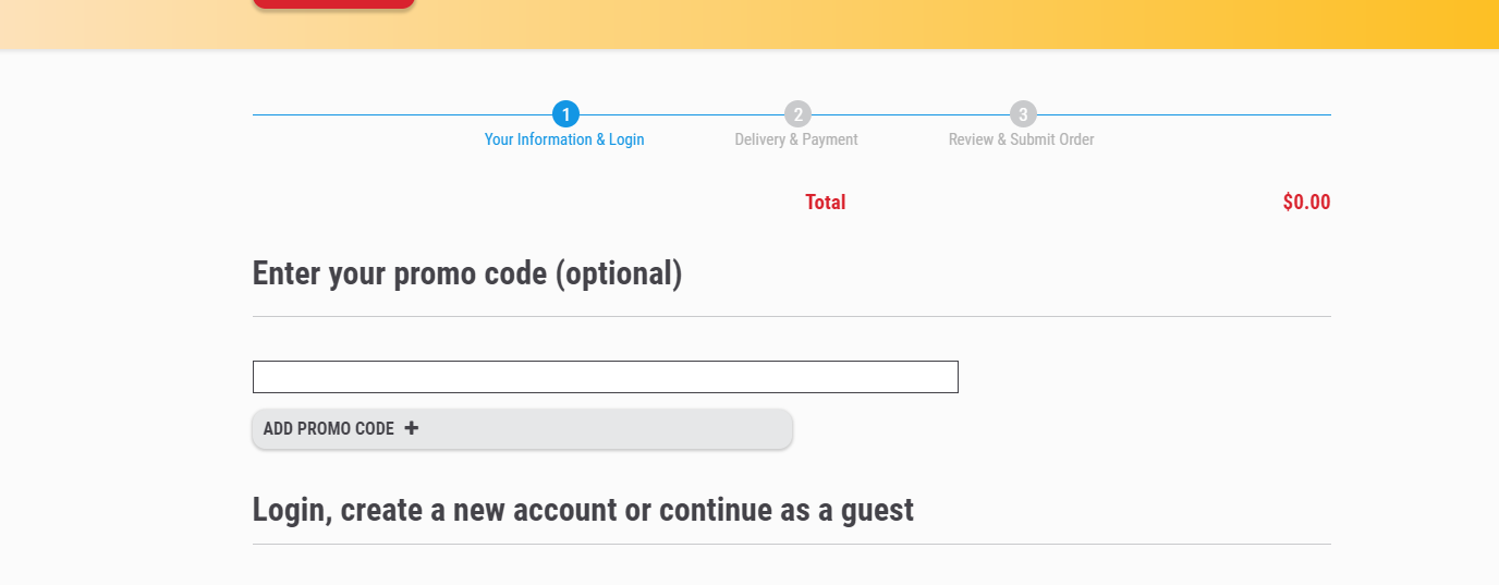

Hi, the URL where you will be redirected when the cart is empty is no longer working when using the new ajax checkout and version 3.1.1. I have this setting set to redirect to a certain url buy-now.html after the cart is empty, but instead since it is using ajax it just empties the cart, but never actually redirects to the url I have set. Instead it leaves you in the cart and shows you a total of zero. Also, I deleted out all of my layout overrides just to check and it still does this so this has to be some sort of bug.
The redirect does however work if after I empty the cart and i manually refresh my browser page. It appears the ajax is just not calling the redirect after deleting the product out. How do I fix this?

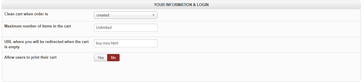

Also, attached is my back end settings and what it looks like on the front end instead of redirecting you out of the cart to the buy-now.html like it should.

I'm afraid that you do have some customization in your website.
pasteboard.co/GCsUGqL.png
When the checkout cart is refreshed in ajax, HikaShop can add a JS trigger in order to indicate that the cart is empty and that the customer need to be redirected.
